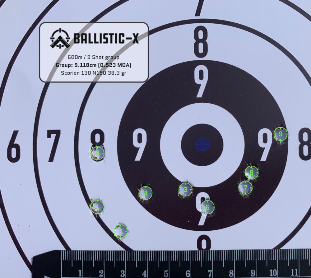

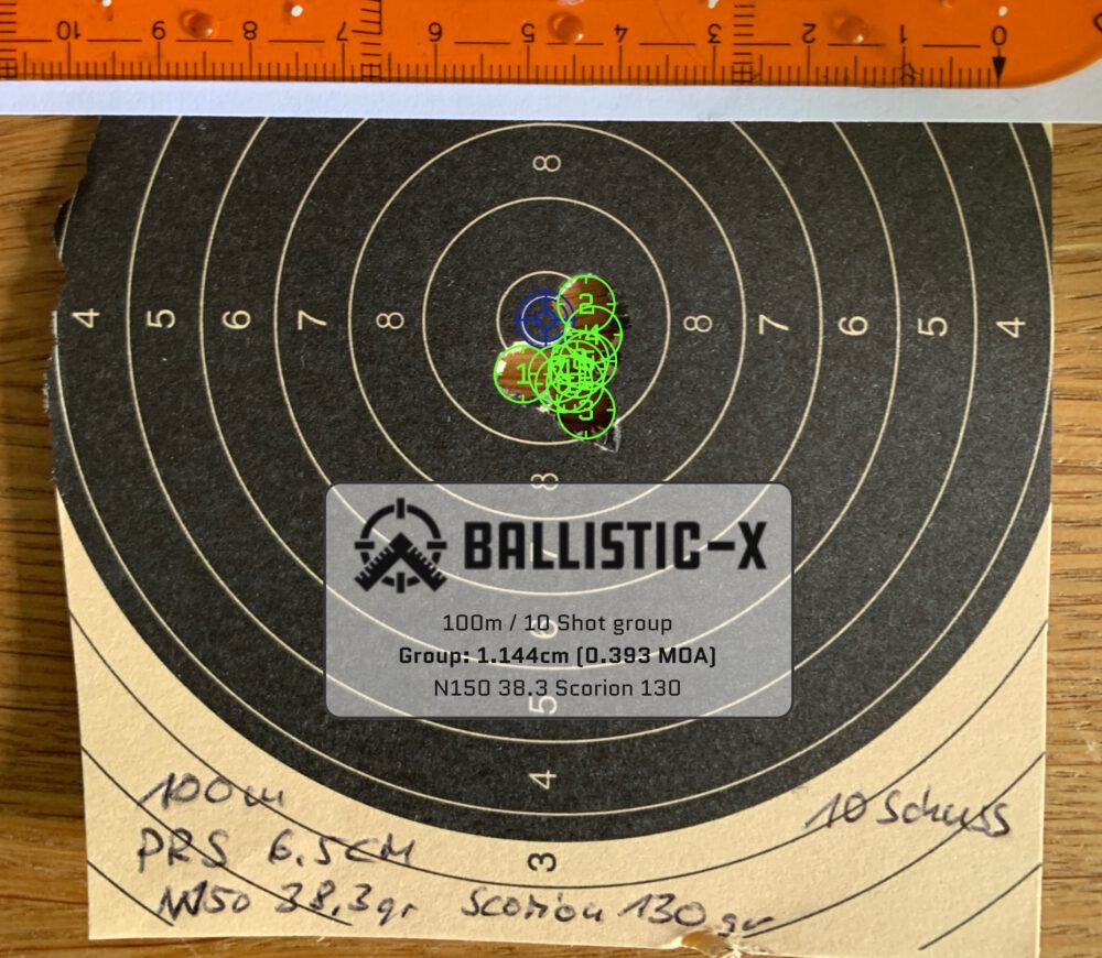

I did a calculation in Quickload and Gordon Reloading Tool (both same result) and then tested the ammo.
Here are the best loading data:
powder Vihta N150 38.3 grain
bullet Scorion 130 grain BC 0.548 G1 lenght 34,95 mm / 1.376" boattail bullet
V0 first: 860 m/s 2821 fps
V0 after 200 rounds: 885 m/s 2904 fps
Here my results at 100 m / 110 yard:
result at 600 m / 656 yard:
