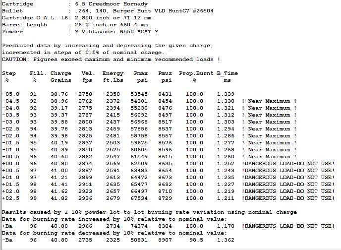

Just for a bit more info, here's some predictive data from QL:
I tweaked the N550 parameters to match VV's 39gr load @ 2745 fps, then plugged in 40.8gr to see where you should be: 2874 fps.
Here's what a ladder would give you...
This is where you read the link I included... LOL
WOW!! that is extremely helpful. What is interesting is that my load testing started at 39 and worked my way up to 41 in .2gr increments which aligns with the process outlined above. I really liked the data at 40.6 and was just 10fps slower (for every .2gr the MV increased by 10fps on average). It was a toss-up for going with 40.6 or 40.8. This helps me realize that 40.6 is where i should be.

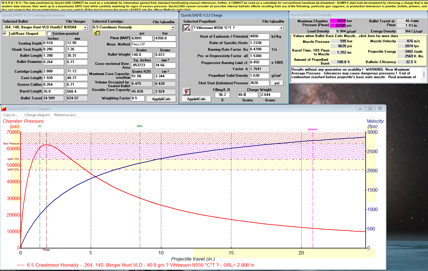

This is the software I used; it's very popular for precision reloading
Keep in mind: it's only predictive. Don't take it as actual ground truth and a replacement for actual load data. Just use it as a predictive guide if you want to see how other powders would perform etc.
Well shoot (pun intended)... I use a MAC and the software is only for Windows...
