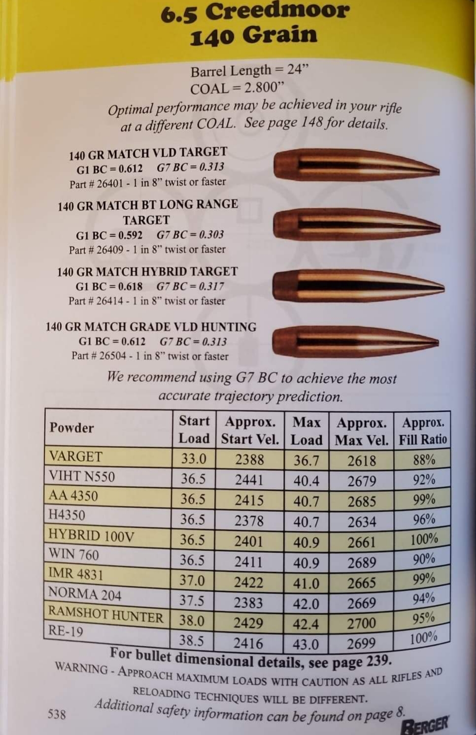

Hey all, question. Gonna start loading for my 6.5 with Norma brass, h4350, 140gr Hybrids. I cannot for the life of me find an actual STARTING load and minimum COAL with the 140 bergers actually published anywhere. Any help is appreciated.

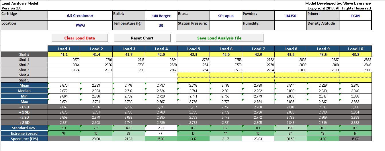

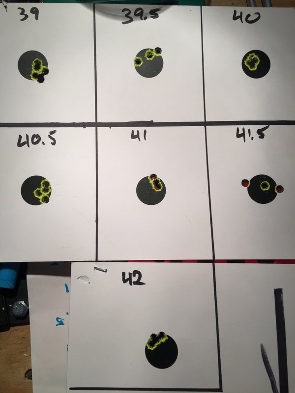

I started load development on the same bullet and powder combo this weekendHey all, question. Gonna start loading for my 6.5 with Norma brass, h4350, 140gr Hybrids. I cannot for the life of me find an actual STARTING load and minimum COAL with the 140 bergers actually published anywhere. Any help is appreciated.
I was aiming for 2850fps and just hit it with my max load. I am going to load up a few more charges above this group to see if there is a node between 2850 and 2900 but will probably end up around 2750fps. Every load shot sub .75" and plenty of options with single digit SD's.

hahaha...most here would view Berger's max load as the starting point for load development. That's real slow stuff they are recommending.Here's from the Berger reloading manual.
I can second that. I started at 40.7 H4350 Current load 41.9gr, and no pressure signs up to ~43 if I recall correctly.hahaha...most here would view Berger's max load as the starting point for load development. That's real slow stuff they are recommending.
