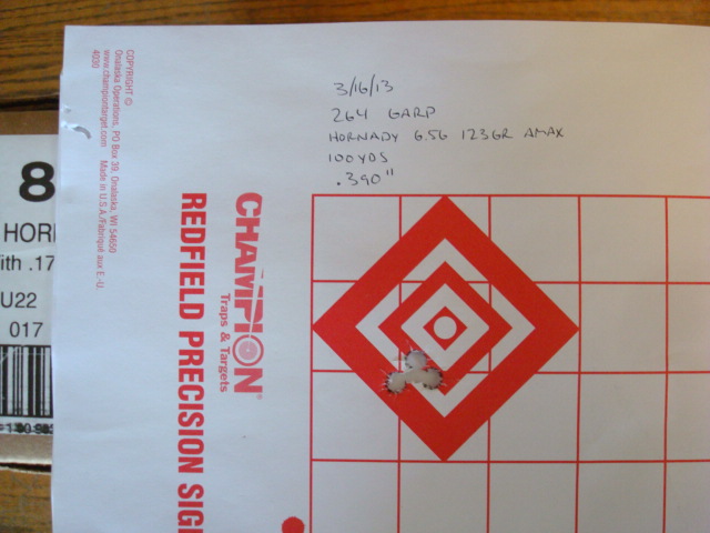

Harrison(Bustin) covered it a hell of a lot better than I could as he spec-ed the barrel. After using a few of his other barrels in 6.8 and .223Wylde, I knew his .264 would be a sweet one. Along with the best bolt in the business, I could not turn it down. Just wish I had bought a few more for the store...
I have some nice 6.8 groups the 68Forums but here is the GARP with Hornady 123gr. These were shots #4, 5 and 6 out of the new barrel.
