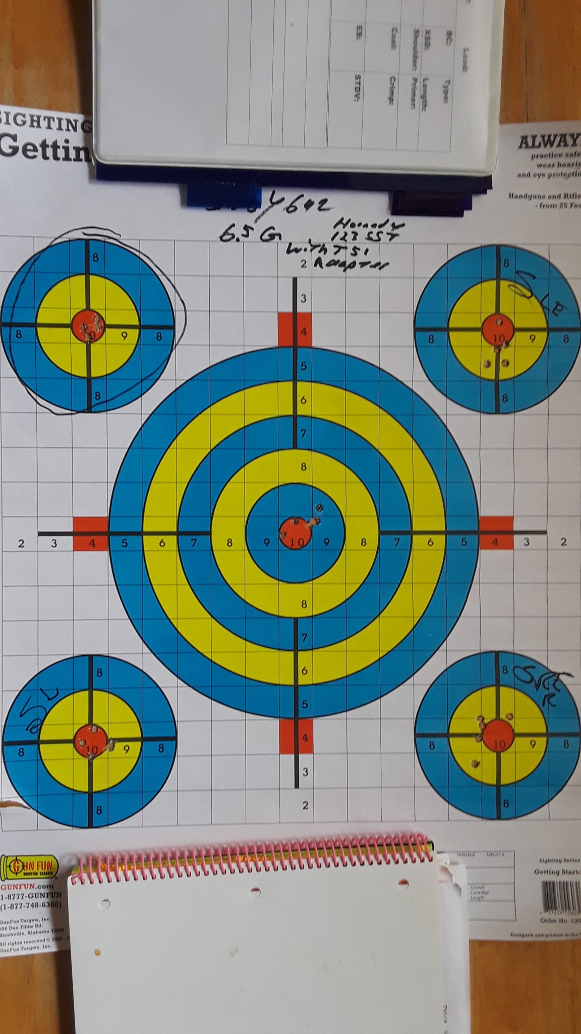

My best 6.5g group of the day.
Details later, guns in safe, time for some Texmex and tequila !
Reactions: TonyTheTiger
So a slight delema with my 6.5g .
Groups with factory 123 are decent.
Best was with factory bird cage.
Second best was with 51t adapter alone.
With can installed groups went south.
Scope is tracking.
My recoil management flaws are showing. Trouble sliding down rear bag after recoil barely seeing target after shot . Longest heavier ar 15 than my others but precived recoil is fine due to the weight equals 223 pretty much.
The magpul crt type stocks dont ride a bag so sugestions would be welcome on bags.
Center target was cold bore and sighters, scope tracked well for upper left target.
Other 3 were the wife's shooting right then left hand. When she started to reposition to the left side rso asked me what she was doing. Lol
6.5g lots of fun to shoot !
