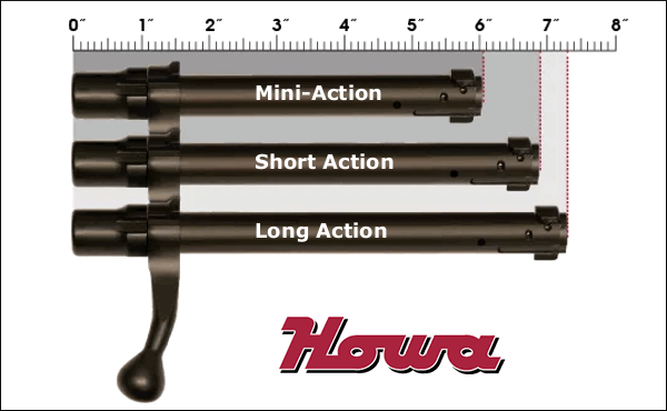

will the mini action restrict oaverall cartridge length or any thing?

The Howa mini action is limited to AR15 COLs. It’s substantially shorter than a short action. Action screw spacing is different and will not fit the Bravo unfortunately.

COL is Cartridge Overall Length. AR15 limits the COL basically to .223 length because that's the dimensions of the STANAG magazine. This is one of the primary limiting factors for cartridges designed to fit in AR length actions (the Grendel basically has the same COL as the 223/556, as does the 6.8 SPC, 24 Sharps, 22 Nosler, 224 Valk, etc). The Howa Mini action may allow a little longer (higher BC, seated further out) COL handloads than an AR will run, but it definitely isn't long enough to fit short-action class cartridges like the .308 and its relatives.
Note that this may not be the case in short actions that just chamber the Grendel but are still short-action sized, like the Ruger American. Those guns don't have the awesomely short bolt throw, shorter overall length with the same barrel and lighter weight of a true mini/micro action though.

As far as the mini action I wouldn't personally want to be hamstrung with the AR-15 mags or limited coal especially in a bolt action.

I would rather get into a regular short action For a Grendel.
Everything is available for short actions and nothing for mini actions.

Also Kadams1563 is right all around. The mini action has a deliciously short throw, a shorter overall length, and a little less weight (the felt effect of those attributes is in that order, btw). If those aren’t very important to you/this build, go short action because it gives you so many more options.
