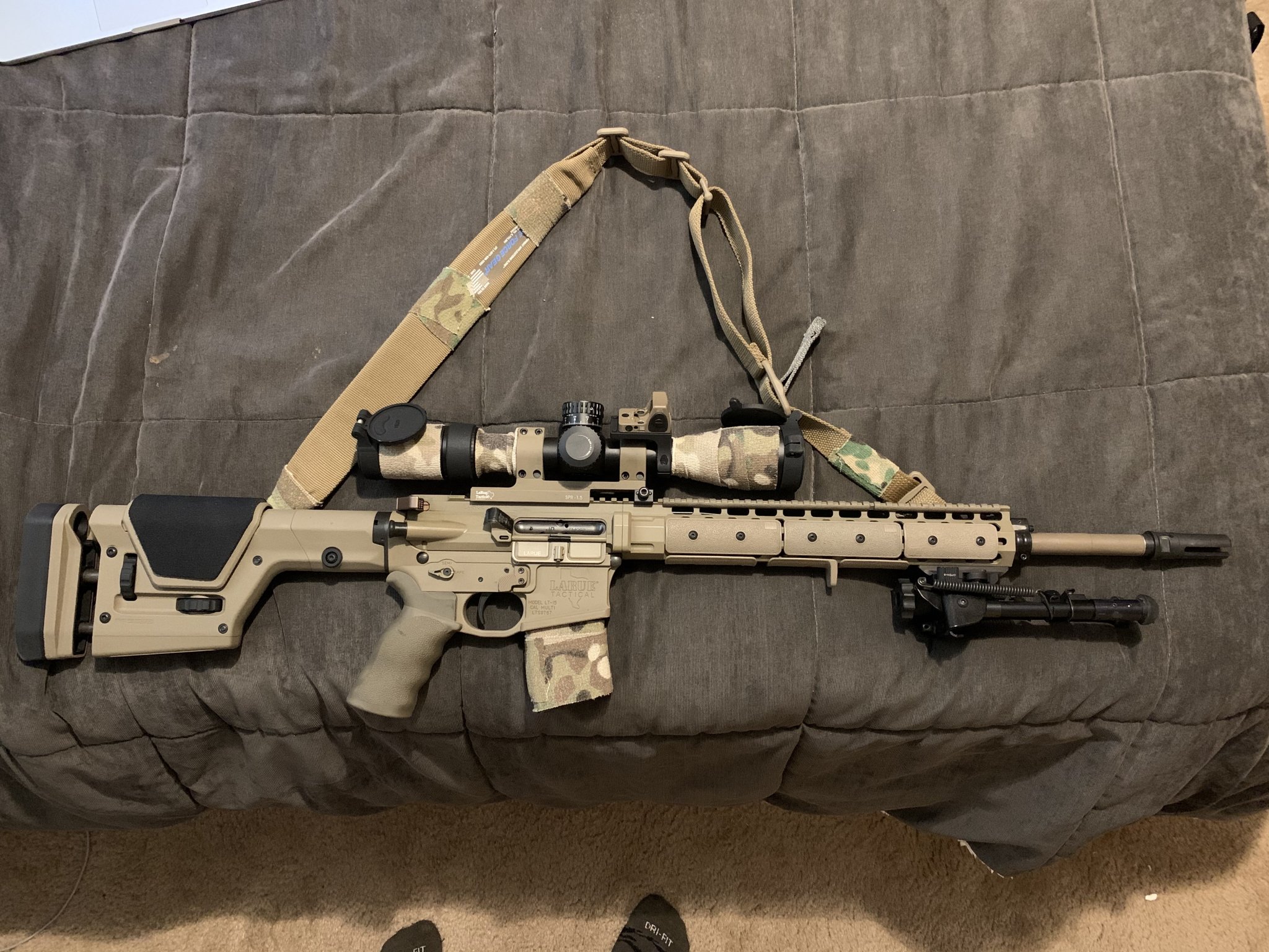

What are you looking to spend? I've got a Custom Craddock 18" Bartlein 6.5G that was built on the Larue 2.0 Stealth Upper and lower, JP LMAS BCG and SCS.
It's just collecting Dust. Built it as a hunting rig but just don't really hunt anymore. Shoots 1/2 MOA with Hornady Black 123 ELD.

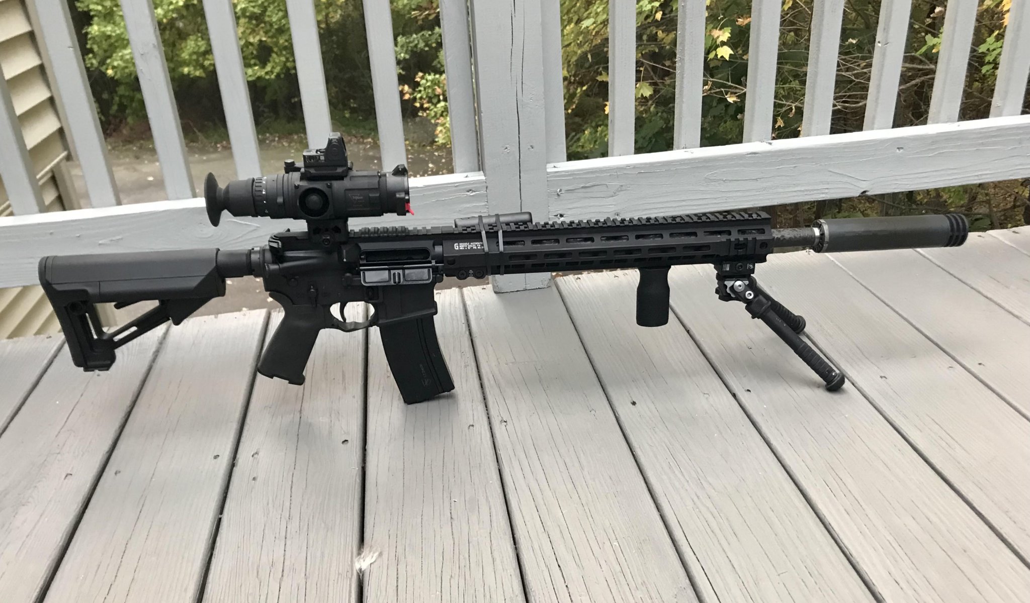

My 18 inch Proof CF. If I was gonna build one without the Proof CF Barrel I would just buy the larue upper.
Reactions: BigRed308 and FuhQ

It's fantastic. Sub MOA with factory Hornady SST's. I don't really shoot it for groups but I have a 6mm CM in my AI AT-X that shoots .5 MOA with Prime 107's. All 4-5 of my Proof's shoot great.

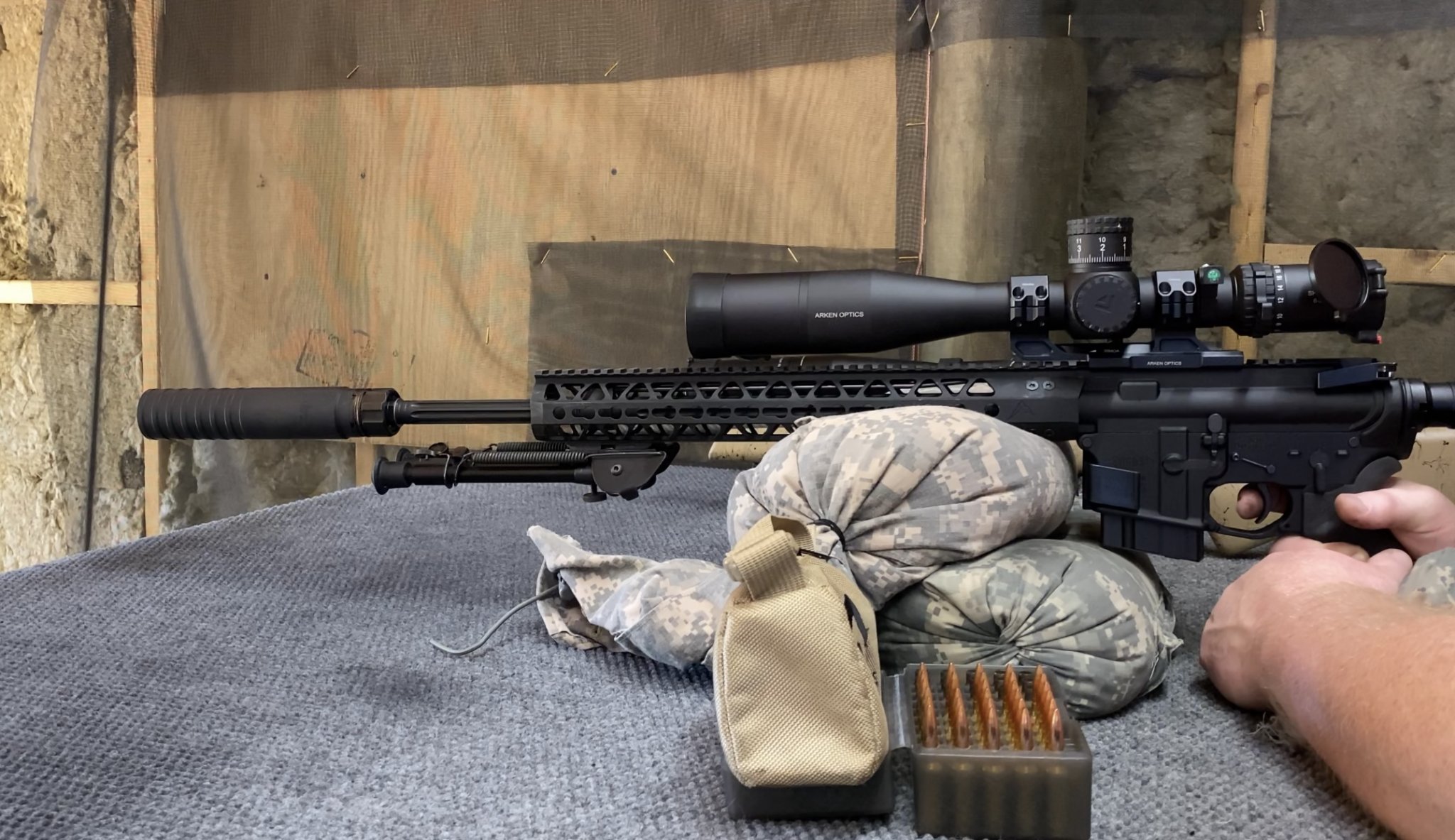

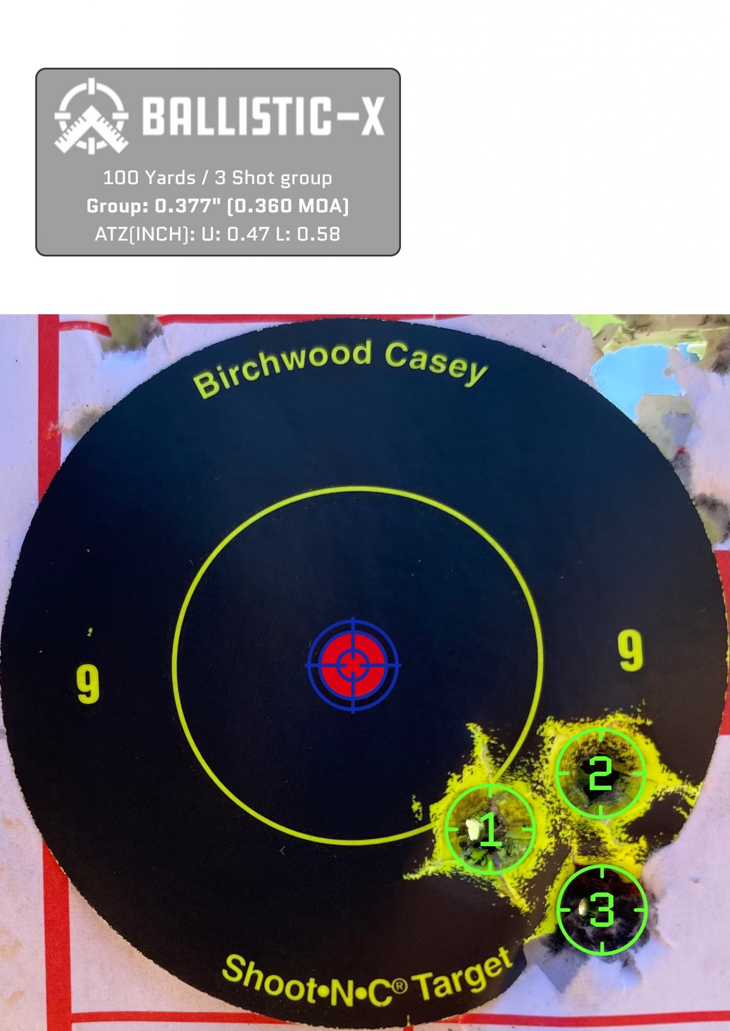

Don't know about the Proof barrel, but the above group I posted was with my 20" Faxon 416r 5R Match heavy barrel. I've been pretty impressed with it so far. It took about 50 rounds or so to settle-in, but once it did, it's been a tack-driver ever since.
