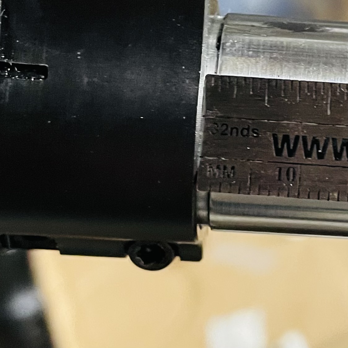

I believe I found the root problem. I measured the distance between the edge of where the hole was bored through the barrel allowing the gas to vent into the gas block and to port in the gas block. If I seat the gas block against the the shoulder of where the gas block seats against the barrel the gas block port extends beyond the barrel port by approx. 1mm. (Please see the attached pix.) I tightened down the gas block 1mm prior to where it engages the shoulder of the barrel and it centers over the port on the barrel perfectly. So who is at fault? The gas block manufacturer for incorrectly drilling the port in the block, or the barrel manufactured for incorrectly drilling the gas port in the barrel 1mm further down the barrel (closer to the muzzle of the barrel?!?

If you are using a gas block designed for use with an A2 style handguard, you may be at fault for not understanding how to set up your chosen equipment…
I'm using an adjustable gas block on this build which is the same one I have used on 4 other uppers. Over the years I have built 9 AR uppers (as well as a few AR 10's along the way) that I presently own (with a few sold) and have built/assisted a few of my friends in another 12 or so builds. They have all with the exception of this build ran flawlessly. I believe I have acquired a rudimentary understanding of how to correctly assemble an AR 15 upper.
...really not the an error on the manufacturers part, remember, the "standard" M16/M4/AR15 uses a plate between the A-frame front sight/gas block and shoulder of barrel/gas journal junction for the typical non-free floated handguard. With the advent of free-floated handguards and lo-pro gas blocks the GI issue A-frame front sight/gas block is rarely used anymore having been replaced by front sights that attach to the 1913 pic rail of handguard. Some gas block manufacturers make the port in their gas block "oversized" in diameter so that if the user butts the gas block up against the shoulder, it will still enclose the whole barrel gas port, some, not all do. It's on the user to check these measurements before assembling.
...Edited: FWIW, I know of folks that had over-gassed systems to begin with that assembled their gas blocks against the shoulder whereby it partially covered the barrel gas port, effectively "restricting" gas flow enough that the platform would function ok....until the hot gasses eventually eroded that overlap and they began experiencing issues requiring changing the buffer/buffer spring or replace with AGB's to mitigate the now experienced over-gassing issues. YMMV
