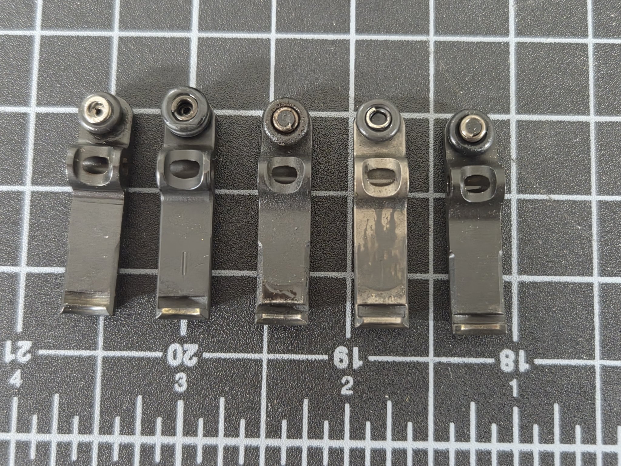

OP, post a picture of the extractor claw.
I'll post some pictures tonight with some extractor comparisons.

#1 is shallow and slides off rims.
#2 is Toolcraft.
#3 and #5 are JP.
#4 is Toolcraft and works as well as JP.
I have a DPMS G2 extractor but can't find it. Those were excellent replacements 10 years ago.
