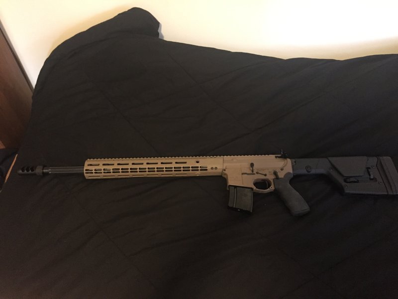

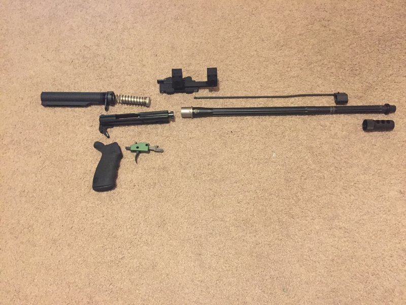

I have an aero precision m4e1 sniper gray set that I put a Christensen arms 20" carbon fiber barrel in with a CMC trigger and run a silencerco Omega. I shoot .5-.75 MOA all day long with it and have taken it out to 850 yards on an ipsc steel silhouette got a second round hit then 4 out of the next 5 shooting 123 AMAX factory ammo. This gun blows my mind. I didn't go cheap on the build and it shows in the accuracy. Highly recommend the Christensen carbon barrel and at 419$ it's cheaper than a lot of other brands. Also I'm using the magpul PRS stock which is heavy but amazing on a precision gasser, and I'm running a nightforce SHV 4-14 F1 MIL-R

The upper and handguard are aero precision as the m4e1 is all one set and I got the sniper gray special they had. I got the JP bolt and I can not remember what brand BCG I got but it's NiB so runs smooth and cleans easy. All of my shooting with it has been off the atlas bipod either from the prone or off a bench and when I was ringing steel at 850 it was off a wobbly plastic table. I am a huge fan of the 6.5 grendel round as it has far exceeded my expectations. I built the gun just for coyote/varmint hunts out to 600 max but I would feel comfortable shooting a yote out to 800 after seeing how it performed at 850. The Christensen barrel is amazing, I left it direct thread with the omega so it only adds about 4.5 inches when it's suppressed

After seeing how my grendel performed my dad had me build him one but wanted to stay a little cheaper and we went with the Odin 18" barrel. It's an MOA gun but it really doesn't compare with the groups my build with the Christensen is putting out. Though there are factors like trigger and stock that could add to that.

Built a 20" using a custom Satern bbl. and didn't skimp on any of the parts. It's one bad motherfucker and the only one I have capable of .33MOA on a consistent basis.
What a funny read! These are the results I'm looking for. Mind sharing your load recipe for .33 groups with that setup?
