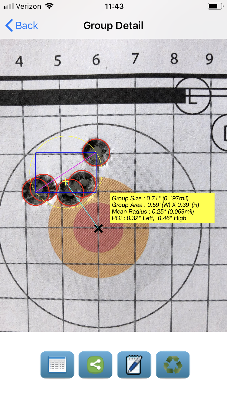

These groups are form this morning. The AG 140gr continues to perform well!
Out of 8 separate 5 shot groups the best was .69” and the worst was 1.13” at 103 yards. The rest were right at 3/4” and that’s about normal for 5 shot groups. 3 round groups are generally within 1/2” but I can’t stay consistent enough to replicate that with 5 round groups.
Buy with confidence!
