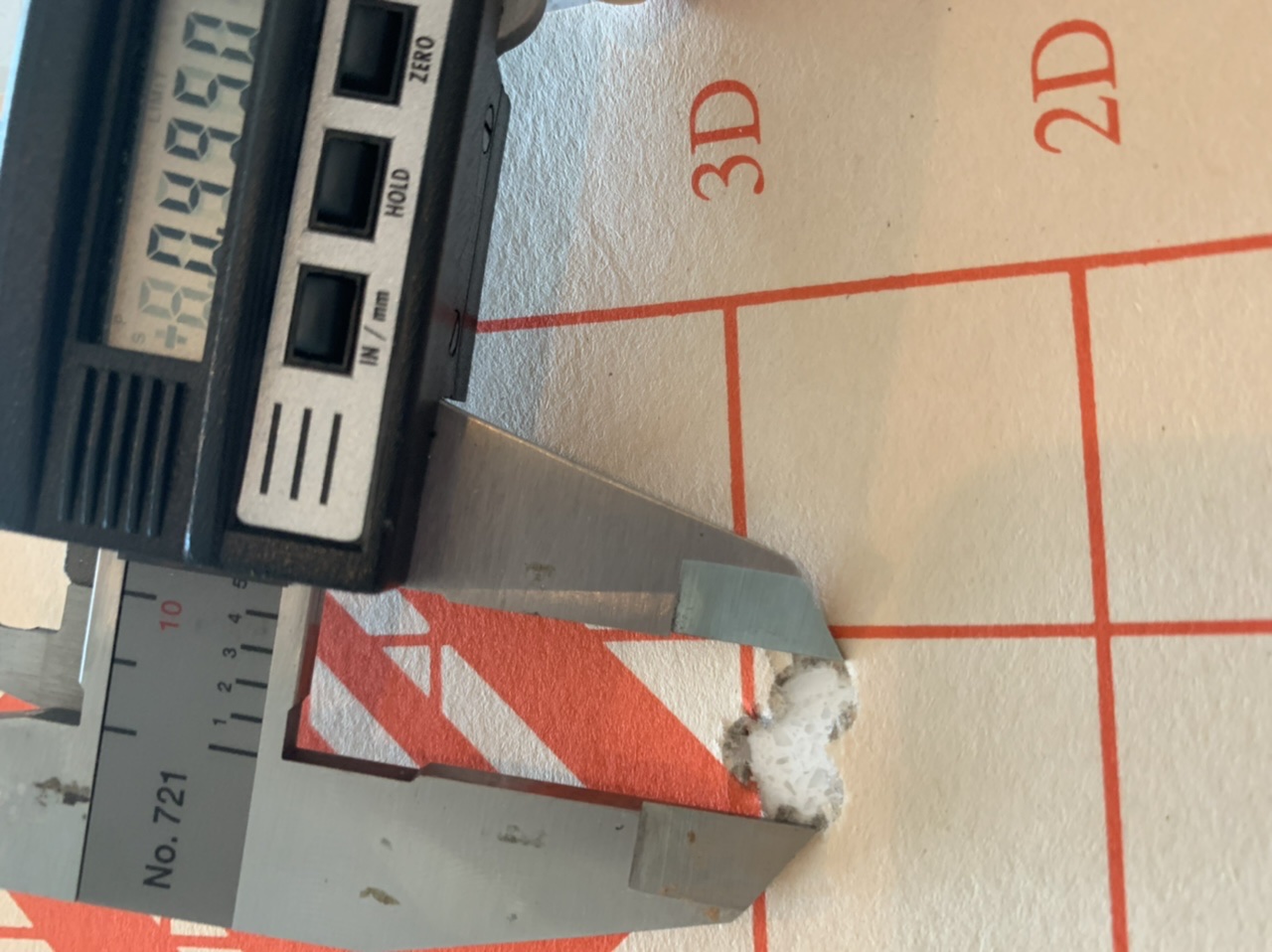

I run N560 with the 135 Berger and I started out at 56gr and went up to 58.2. I ended up at 57.5 gr with adg brass and BR2 primer. OAL is 2.96. Velocity is 3187 avg. below is what I settled on. Data is accurate out to 568yds. That as far as I’ve tested.
58.2 was too hot and I can tell a couple pieces of brass the primer pockets are slightly more loose. This is out of a prefit 22” proof CF for bighorn SR3.
