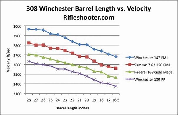

For you're 20" barrel, you'll have to stick to the lighter bullet. . .like, 140's and my might be able to almost get to 2950 fps with MagPro or N565. But you'd be pushing the pressure pretty high.
Maybe this chart will give you some ideas:
