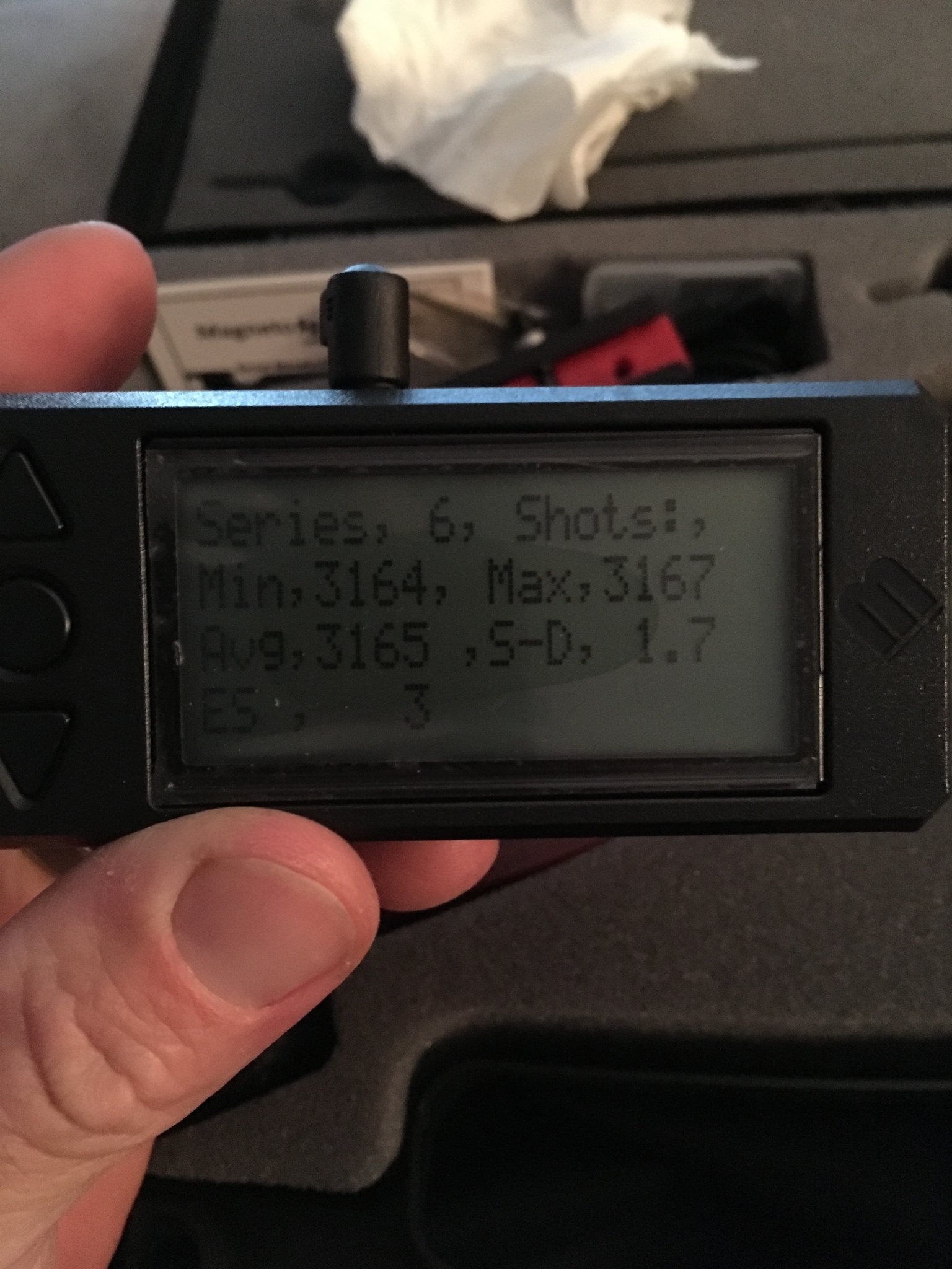

The accuracy of my gun is still absolutely spot on one bullet through previous hole etc. I just have to use the slower data for ballistics and all is good. But it effectively has turned by 6.5 PRC into a standard 6.5 Creedmore. That's a Great Rifle! But not what I bought. I'm looking forward to getting my first batch of reloads done and see what they actually run!
Yep! That's good.Still no issues! Flatline 123View attachment 7243519View attachment 7243521
Actually just had about 25 passes with the JB stuff this morning. And those pictures were after that!
