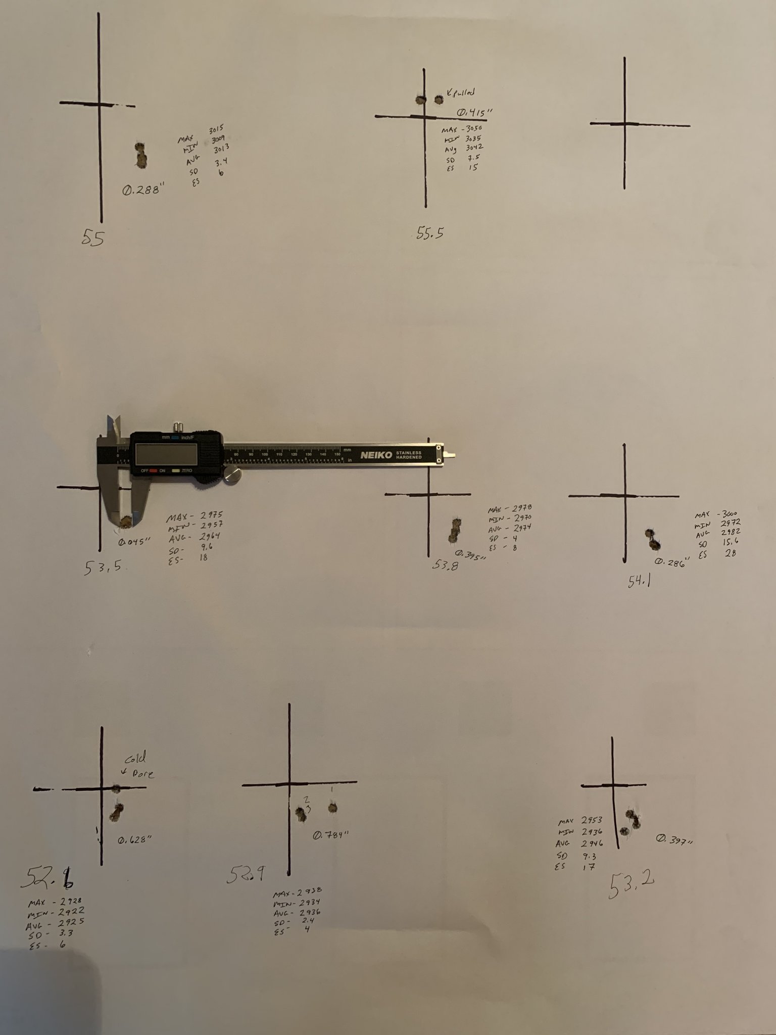

Good morning SH,
I need some help choosing the correct load. Back story, I've ran load development with H1000, 56.2gr 2.3030" CBTO, but have ran out of powder, can not find it anywhere, and stumbled upon some RL 26. With H1000 it was obvious and clear which charge weight worked the best. It shot the best groups and had the lowest SD and ES. The pictures below were shot last night at an indoor 100 yard range. I was using Hornady virgin brass with Hornady 147gr ELDM's all seated at 2.3030" CBTO ~0.040" off the lands. These are shot out of a Christensen Arms 6.5 PRC MPR with a stock 24" barrel with 1:8 twist, with 436 rounds through it. I had a SilencerCo Omega 300 suppressor attached. I used a MagnetoSpeed V3 chronograph. All groups were shot off of bipod and rear bag on a stupid bench.
Specs:
Hornady 147gr ELDM
CCI 250 primer
Reloader 26 powder
All loaded to 2.3030" CBTO
3 shot groups
Stats
1: 52.6 gr
Max 2928 fps
Min 2922 fps
Avg 2925 fps
SD 3.3
ES 6
group 0.628"
2. 52.9 gr
Max 2938
Min 2934
Avg 2936
SD 2.4
ES 4
group 0.784"
3. 53.2 gr
Max 2953
Min 2936
Avg 2946
SD 9.3
ES 17
group 0.397"

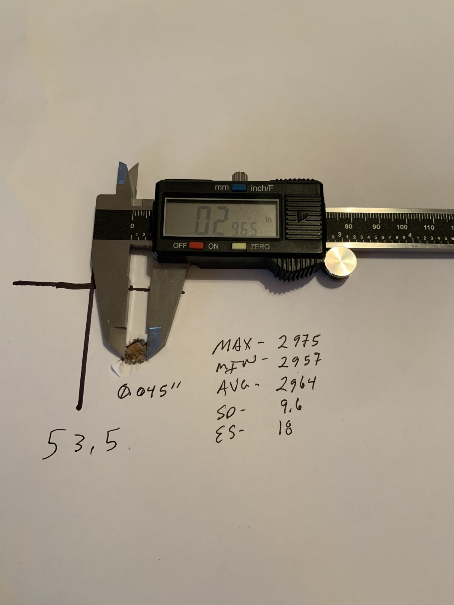

4. 53.5 gr
Max 2975
Min 2957
AVG 2964
SD 9.6
ES 18
group 0.045" BEST GROUP
5. 53.8 gr
Max 2978
Min 2970
Avg 2974
SD 4
ES 8
group 0.395"
6. 54.1 gr
Max 3000
Min 2972
Avg 2982
SD 15.6
ES 28
group 0.286"
7. 55 gr
Max 3015
Min 3009
Avg 3013
SD 3.4
ES 6
group 0.288"
8. 55.5 gr
Max 3050
Min 3035
Avg 3042
SD 7.5
ES 15
group 0.415"
The obvious choice would be 53.5 gr as it shot the best group. However, other loads had better SD and ES's. Based on all the information what load would you work with? Thanks in advanced for all the help.

Thank you for the reply. I found a good accuracy node with with H1000 at 56.2 gr. I was averaging 2990 FPS over 10 rounds shooting 0.4” with 4 SD and 11 ES. I guess more of what I’m trying to get at is with H1000 it was easy to load develope with, as most groups were .75” or bigger and 56.2 was the smallest group with lowest SD. With RL 26 I’m getting really good groups out of every load I tried (pictures and stats in original post). Do you pick the best group with higher SD and ESor choose a load that doesn’t group as well but has lowerSD and ES?
Example with 53.5 gr RL 26 3 shot group was single hole with SD of 9.6 and ES of 18. With 53.8 gr RL 26 3 shot group was 0.395” with an SD of 4 and ES of 8. Which load would you choose?
Usually if best acurracy and ES/SD don’t jive I can get the best ES/SD load accuracy up to snuff with bullet seating adjustments.

Looks like good results with what you have done. I wouldn’t trust a 3-shot ES/SD as a final judgement call though. It‘s good for what you are doing now but beyond initial development, 5 at minimum, 10 preferred.
Thank you. I usually do 5 round to 10 round test once I’ve found a decent load to further test it out. I’m just out of town at work and am low on components. I have 10 cases and bullets left to test before I’m out. I think I’ll load two different charge weights with 5 rounds each to further test the loads. I’m going to try 53.5 and 53.8 to test out further. Do you see any other charge weights I should further test? Or am I on the right train of thought with those two loads?
Reactions: db2000 and AIAW
Sounds good. Such a small sample size could send you down the wrong path. I think you’ve got a very solid contestants in what you‘ve done already. Tweaking that ES down on the 53.5 could be as simple as a brass prep attention. Keep that seating depth, but really focus on neck tension (perhaps even test a few cases for H2O capacity). That alone might get it done.
Thank you for you’re help. I’ll be sure to keep this all in mind.

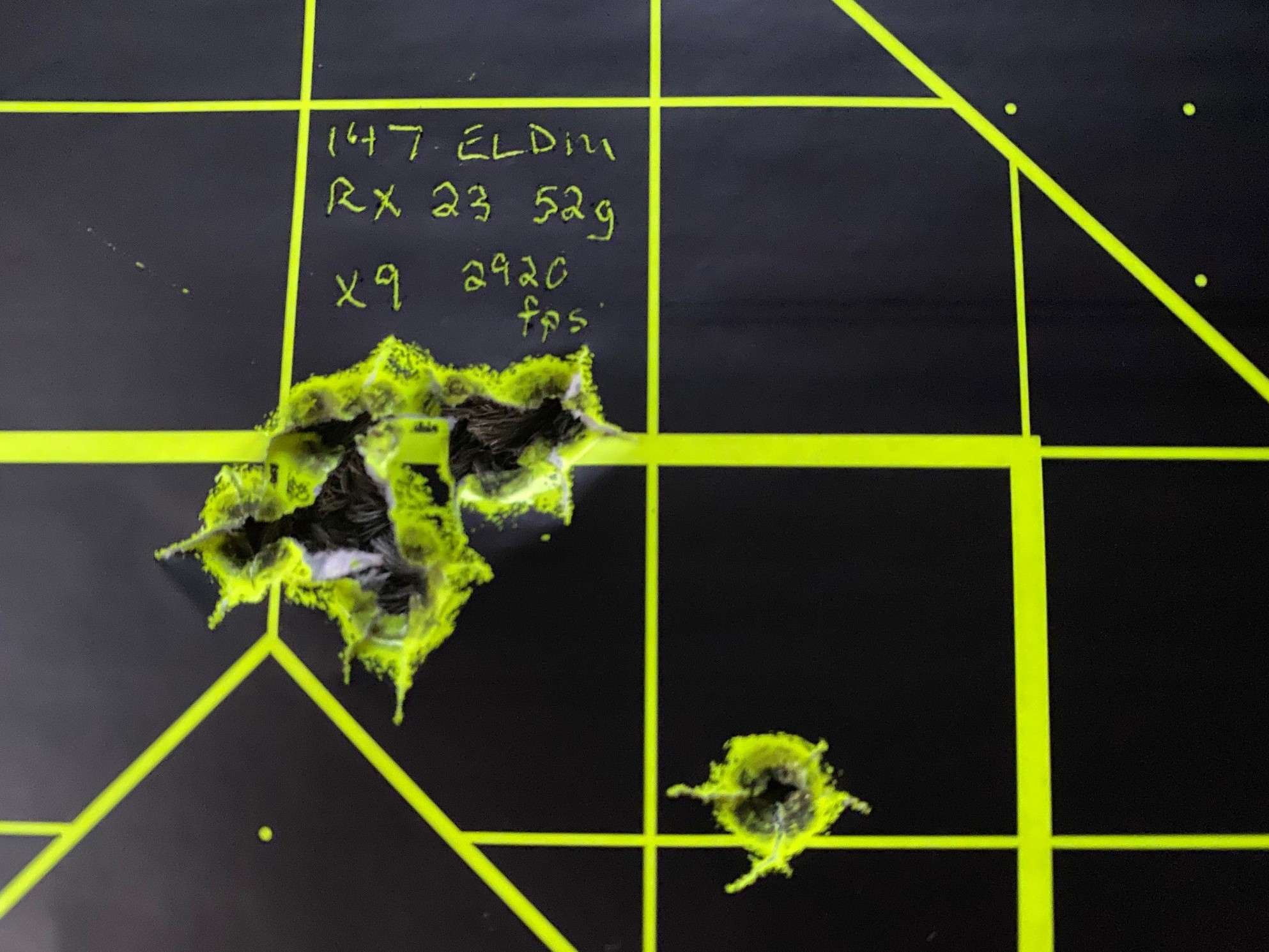

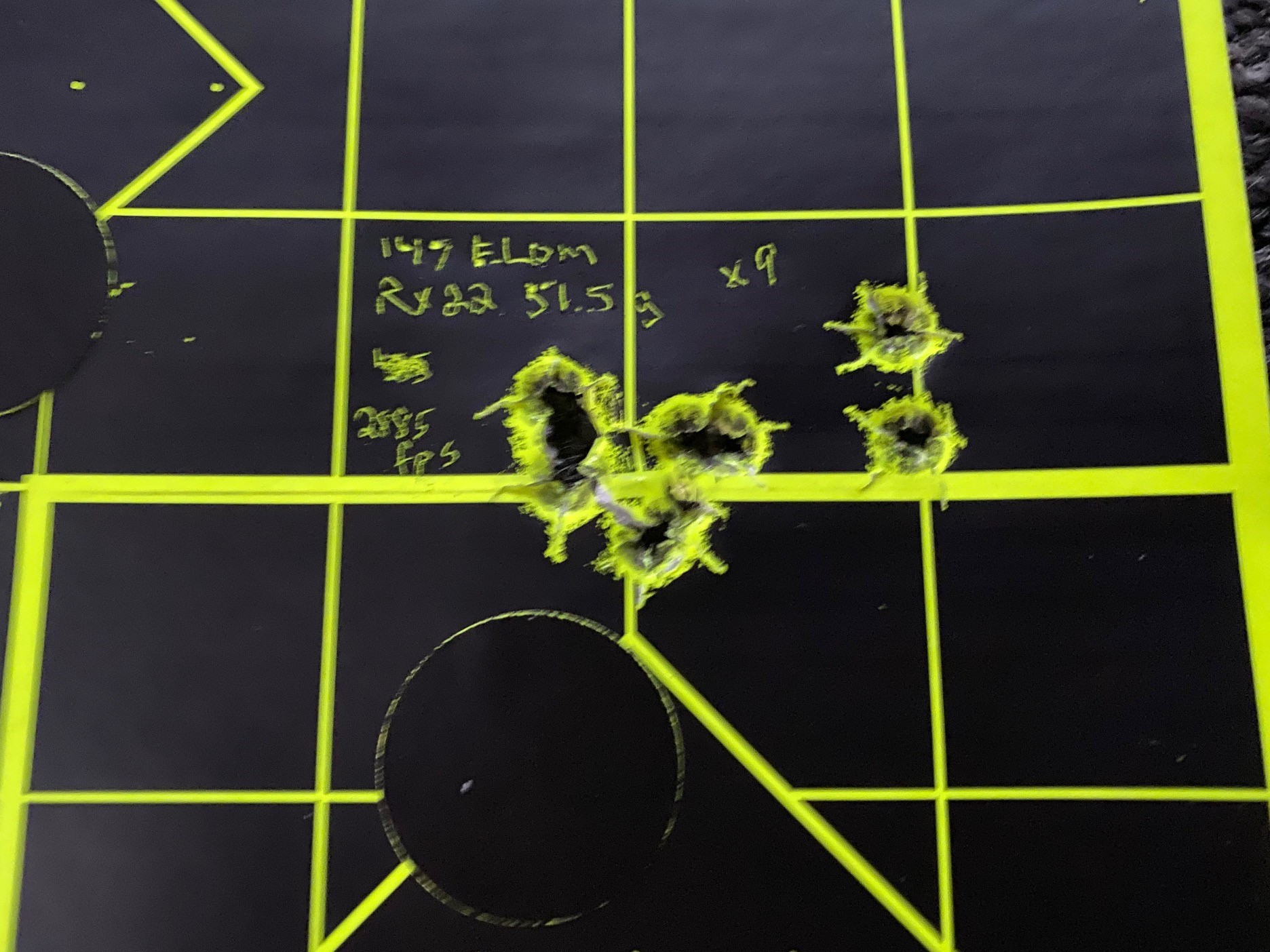

Here's some of my data:
Christiansen Arms MPR 6.5 PRC 24” carbon barrel 1-8” SilencerCo ASR Flash Hider
Magneto v3
Original carbon barrel:
Hornady 147 gr ELDM
Rx 22 51 gr
Hornady brass x 3
Fed 210
COL 2.045
COAL 2.940
2850, 2838, 2836, 2845
0.75”
Hornady 147 gr ELDM
Rx 22 52 gr
Hornady brass x 3
Fed 210
COL 2.045
COAL 2.940
2902, 2901, 2883, 2893
1.25”
Hornady 147 gr ELDM
Rx 23 52 gr
Hornady brass x 1 firing
Fed 210
COL 2.030
COAL 2.940
2866, 2883, 2872, 2876
0.60”
Hornady 147 gr ELDM
Rx 23 52.4 gr
Fed 210
COL 2.030
COAL 2.940
2909, 2897, 2904, 2898, 2893
0.75”
Hornady 147 gr ELDM
Rx 23 52 gr
*Hornady brass x 12 firings
Fed 210M
COL 2.015
COAL 2.940
2899, 2898, 2925, 2918, 2922
2917, 2923, 2909, 2922 SD 10.3

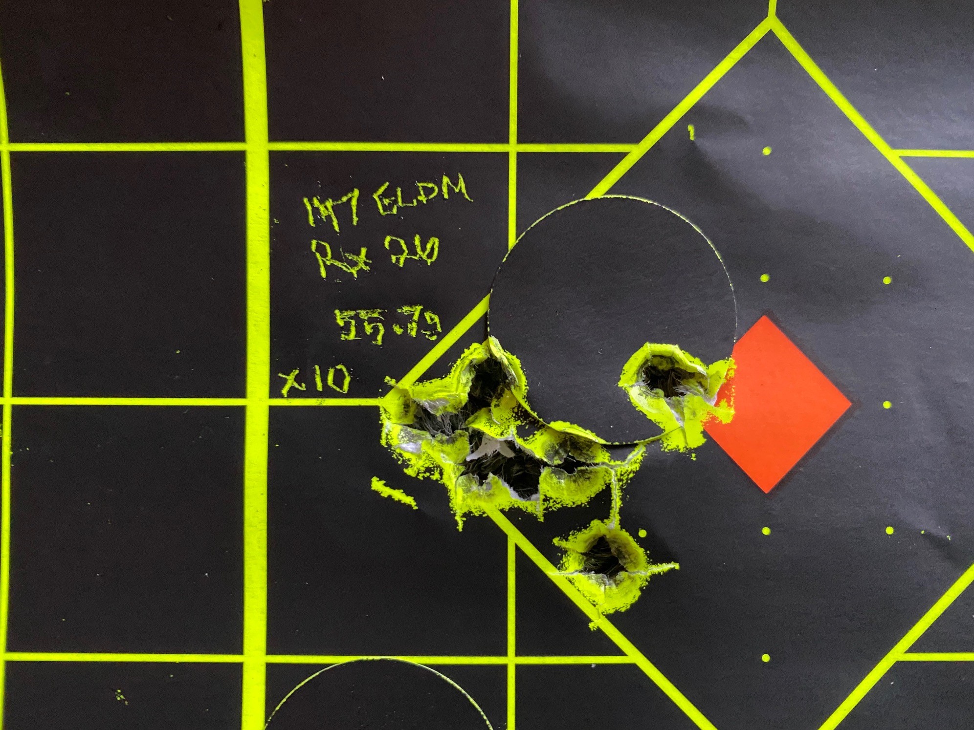

Hornady 147 gr ELDM
Rx 26 54.5 gr
Hornady brass x 5
Fed 210
COL 2.045
COAL 2.940
2913, 2955, 2950, 2951, 2959
Clean, cold barrel, no resting
0.75”
Hornady 147 gr ELDM
Rx 26 55 gr
Hornady brass x 5
Fed 210
COL 2.045
COAL 2.940
2982, 2995, 2987, 2980, 2980
1.25” some wind gust today
Hornady 147 gr ELDM
Rx 26 55.7 gr
Hornady brass x 5
Fed 210
COL 2.045
COAL 2.940
3009, 3017, 3007, 3005, 3011,
3000, 3023, 3008, 3026, 3011 SD 7.65
1” from cold barrel not resting
Cases become difficult to eject after
Shooting 30 rounds. Some primer cratering and ejector marks.

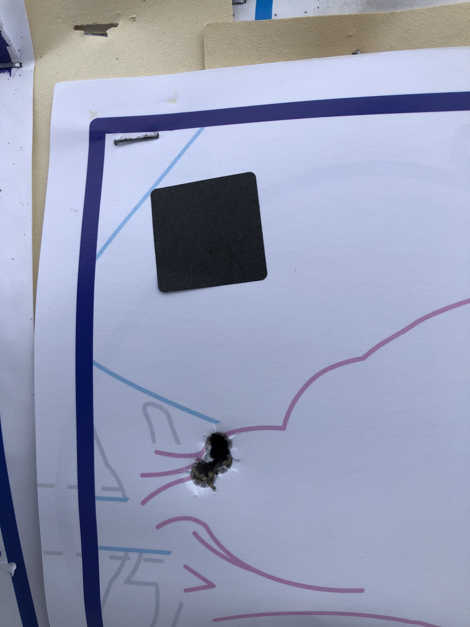

View attachment 7197259View attachment 7197260
I’m new so thanks. The 53.5 looks good. My load for my CA 6.5 w H1000 is also 56.2 and so is my buddy’s in his CA.
I called Hornady who said they load with RL26 and Federal 210 match primers. I’m just the opposite, I can get H1000, but not RL26. On that 53.5 load, try it out to 1000 on steel. That’ll give you an idea if it’s a keeper load.
