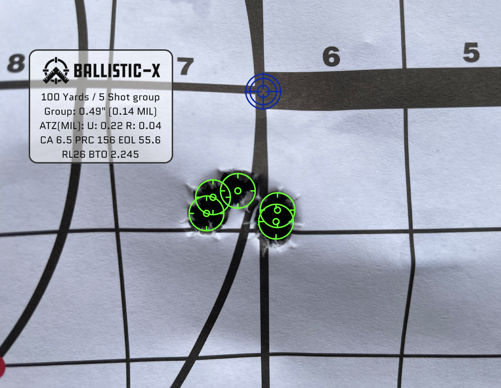

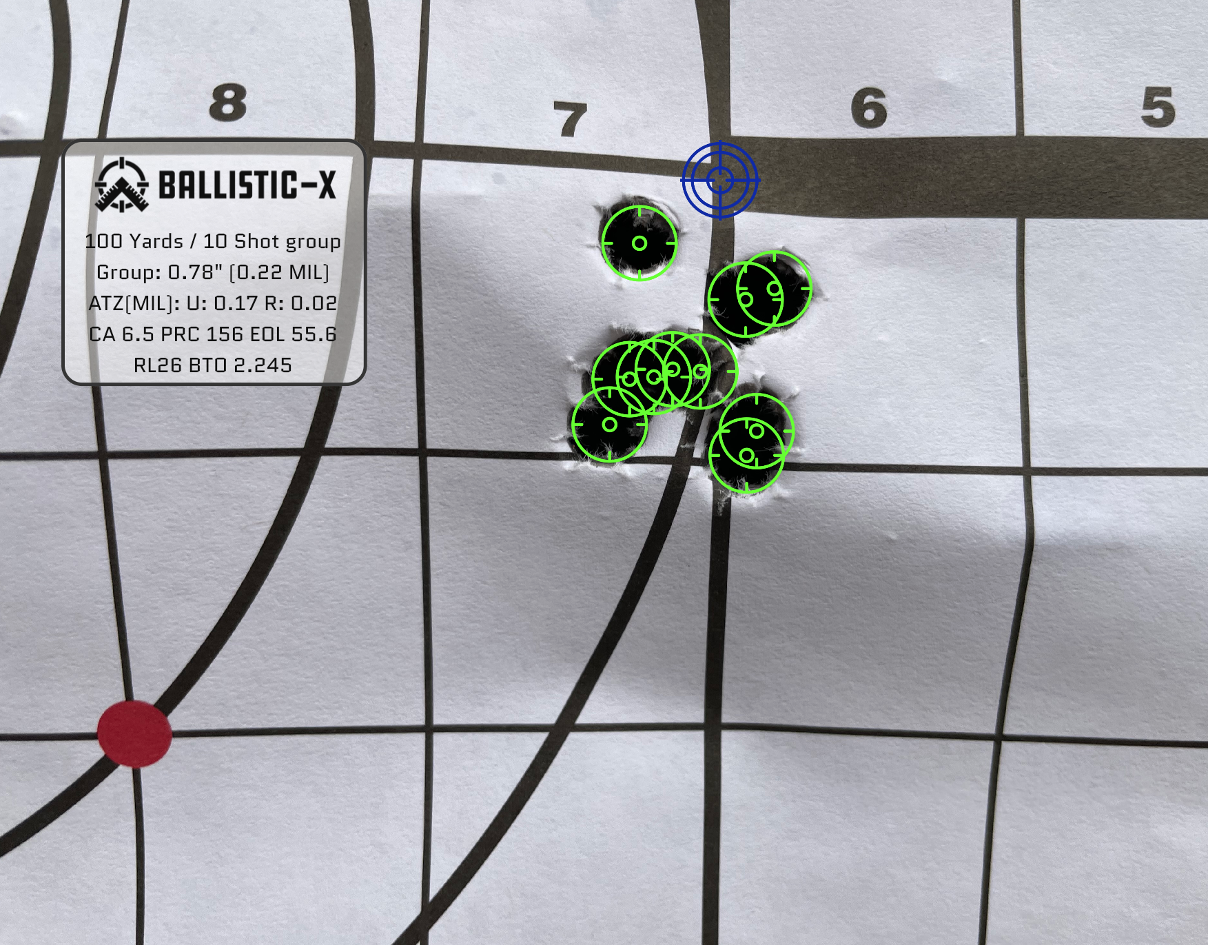

It’ll shoot very similar to RL26. Maybe better. Never know. Here’s my node for my gun, CA MPR 24” 1:8 CF Omega Suppressed
74F 78% 29.99mmHg
Berger 156 gr Elite Hunter HPBT
Rx 26 55.6
Bertram brass x 1 firing
Fed 210M
BTO 2.237
COL 2.020
Magneto V3
0.75”
2987, 2993, 2972, 2984, 2971
2986, 2977, 2998, 2982 fps
5 shot group and then same group after 10 shots
