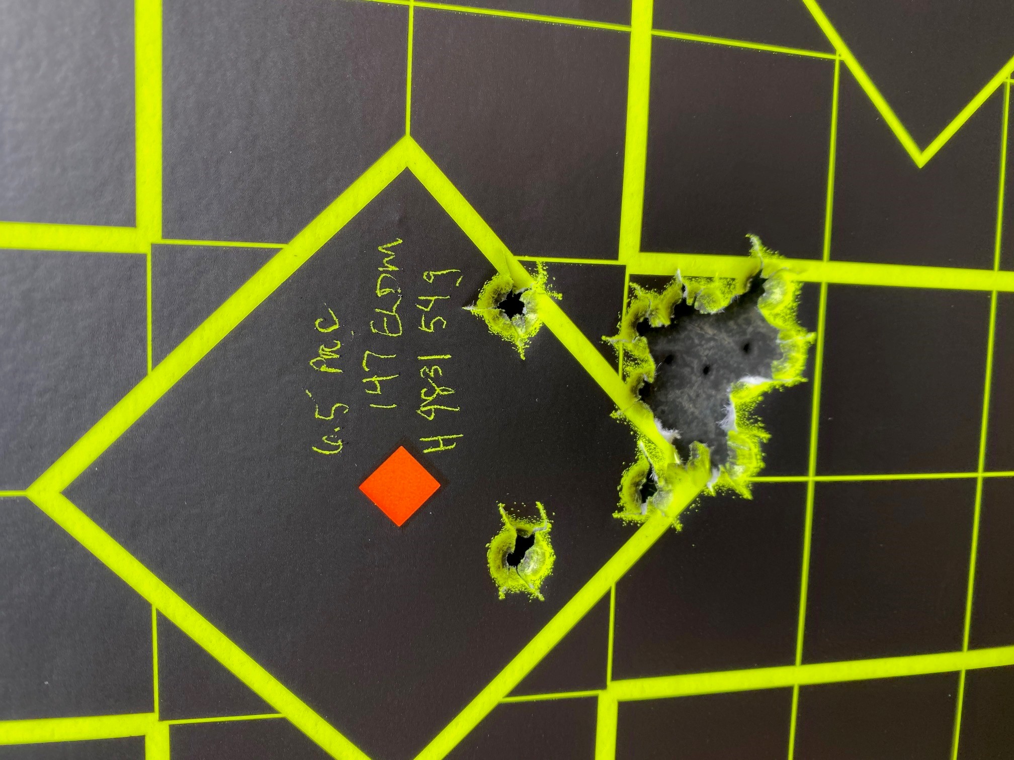

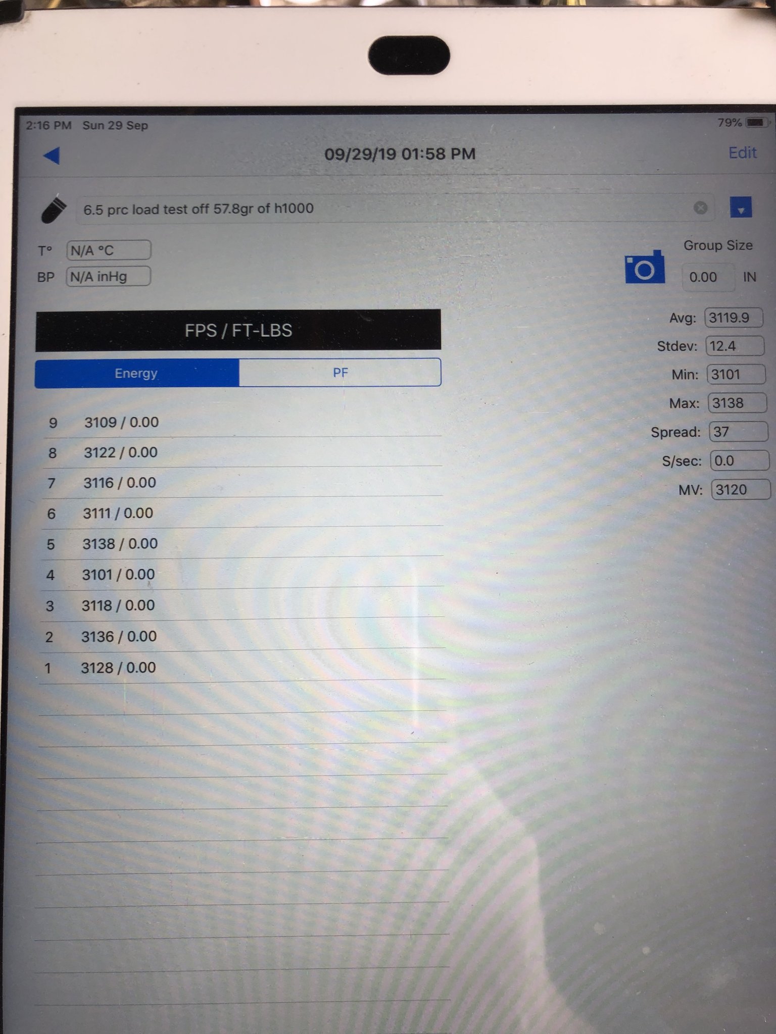

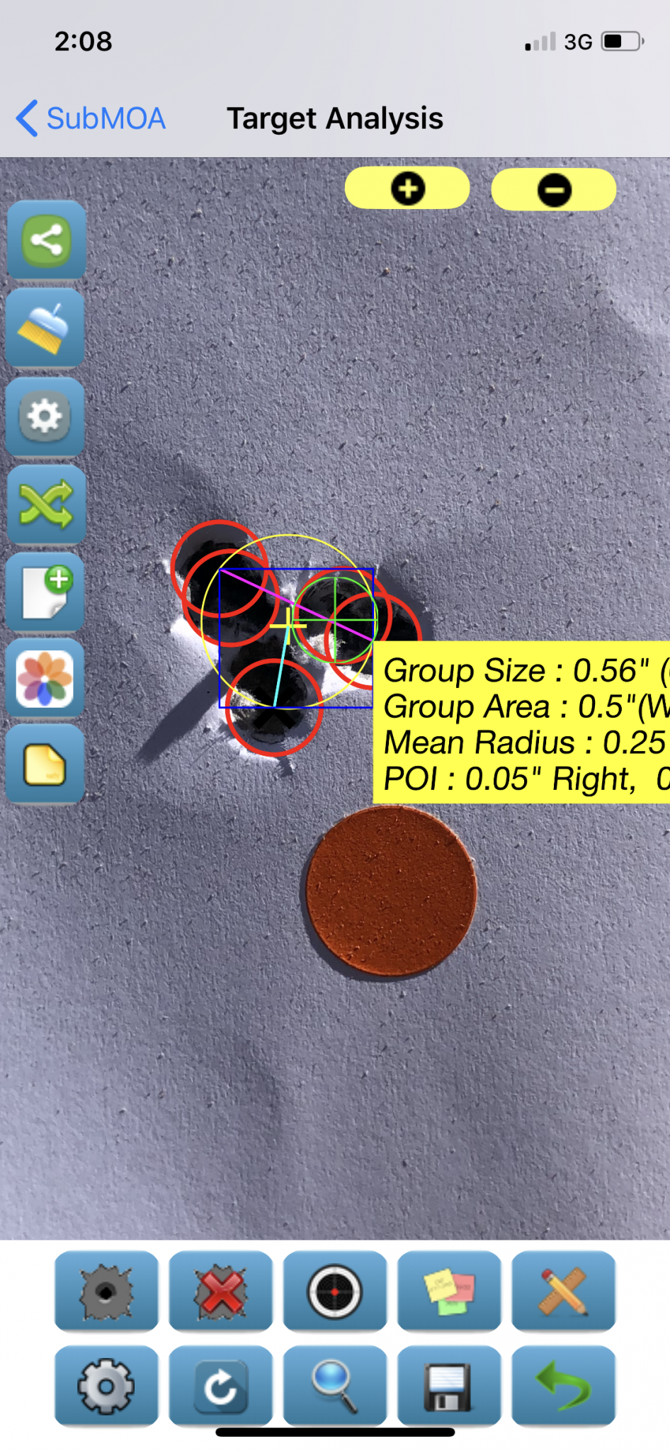

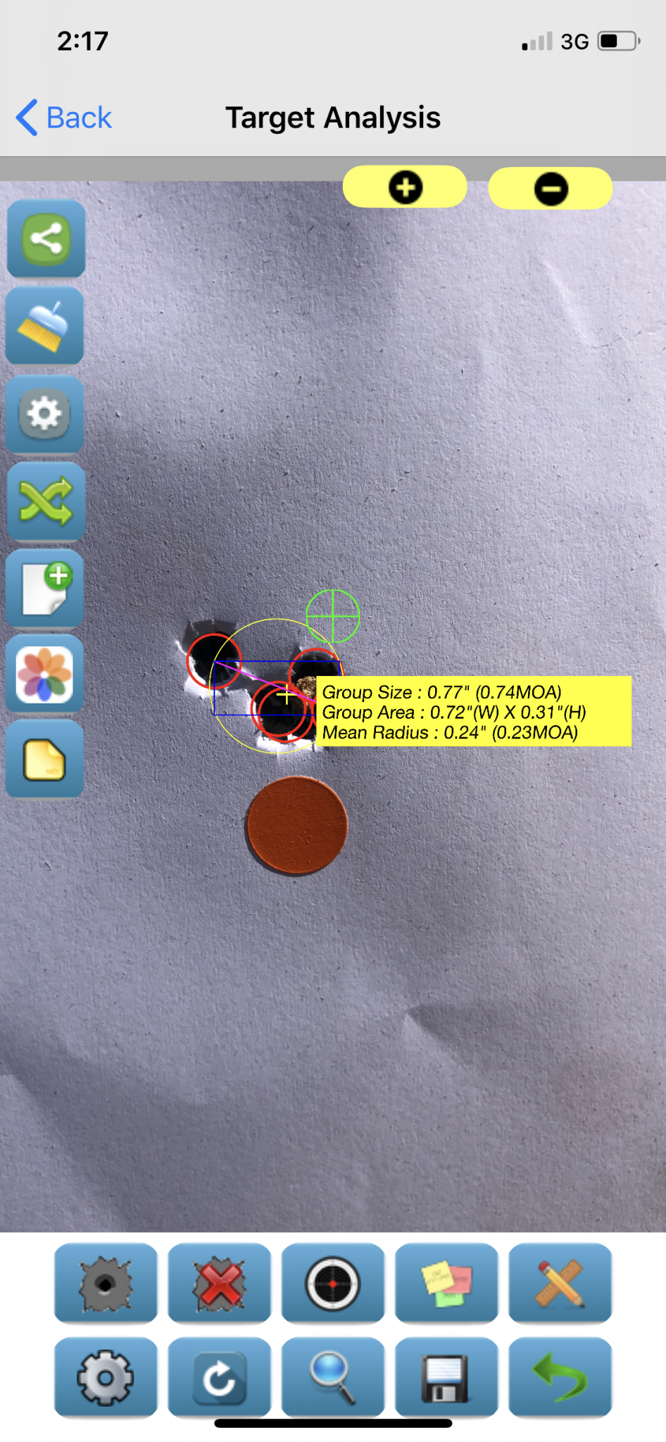

All but finished my load for
My 6.5prc today. Might try a different primer to see if I can get the es and as down a touch more.
Hornady once fired brass with a slight shoulder bump
Federal large mag primer
147 eld-m
2.95 coal
58.8gr off h1000
3119fps
Pics are of the two 5 shot groups I did today. If I take the flyer out off the last pic the group is .3 moa
