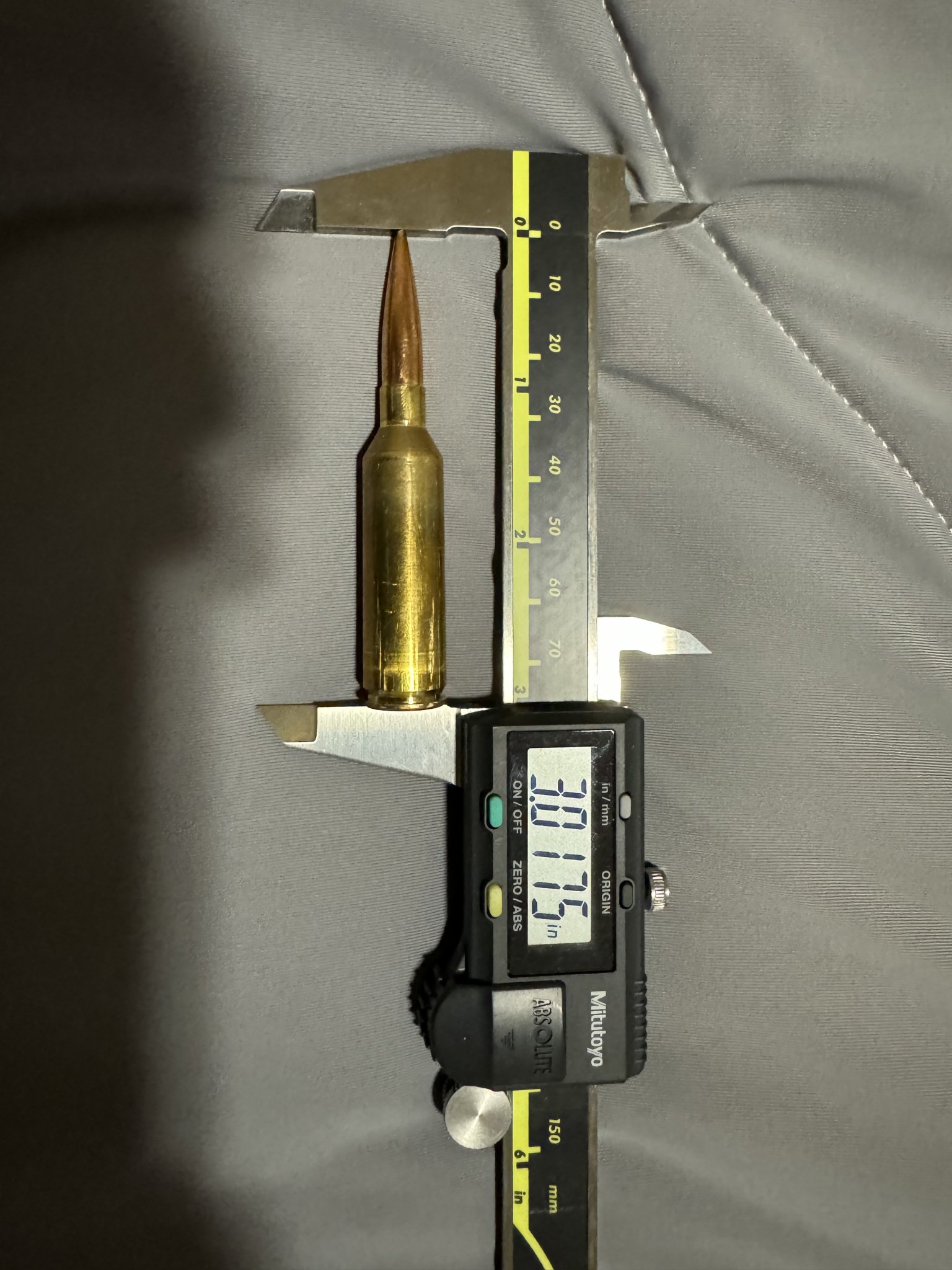

There are a couple of options in the short action that will allow you to run longer coal in a short action. Run a bat Vesper or bumblebee with the unknown munitions XL dbm, or utilitie a short action that's capable of utilizing the bainey bdl mag box. Both of these will allow loading to coal over 3.1". My 65saum is on a medium origin using hawkins mags, and my 25prc is on a bumblebee with the unknown dbm. Both run well loaded long, but mag capacity is only 3 rounds. If you're looking to have extended capacity, a medium action to use the mdt xm mags is the best choice, as they can hold 10 rounds.
I’m doing exactly this with the bumblebee and couldn’t be happier. The one caveat with that action is the square bottom. Doesn’t bother me but is something to be aware of.
