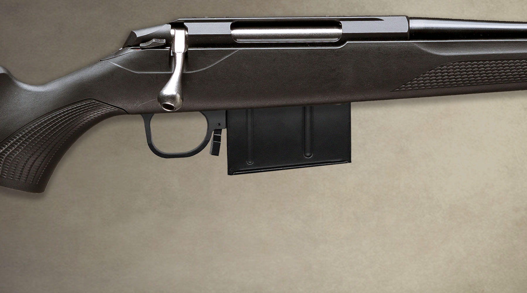

The only one that I'm aware of that requires anymore modification than minor stock inletting is the mountain tactical, which they have a video of on their website. It's also the one that offers the longest coal possible per specs. The rest take the Aics La mag for a max Coal of 3.500" , plenty enough for both the 6.5 prc and 300wsm that are in question, and there's already a few that have been using them for some time on here. What further modifications they require other than what's listed, is beyond me as I have no use for them, just merely stating that option exists.
Unless the AICS LA mags have a spacer block in the front to limit to Tikka max OAL, you'll have rounds ending up pushed against the front of the mag that will get caught under the feed ramp. MDT wouldn't be making special Tikka mags if this wasn't a known issue. I love my Tikka's, but they are really only set up for standard length of 3.34". Like you stated, you can get 3.5", but you need a mag that only allows for 3.5", and the AICS LA mags allow for ~3.7. Not a big deal to notch the feed ramp as R700 folks sometimes do, but it's not a simple drop in.
-Dan
-Dan
Again, like I said, aside from the Mountain Tactical DBM, I don't know specifics of what exactly it takes to make them work in a Tikka. Mountain Tactical has a video explaining the installation of their product and say that to take advantage of the full length of an AICS LA mag of 3.625" or so you need to notch the feed ramp. Other than that, it's a non-issue for me since I don't own any Tikka's, nor do I plan on owning any. Being that CDI has had theirs out for six years now and there are numerous other companies making long action DBM's for Tikka's, I'd assume they're doing something to make them work just fine and keep people happy. As I also pointed out, there's folks here that have them in the Tikka thread. If you're curious about the details, I'm sure they'd be better to ask since they have a vested interest in the products and I don't, just know they've been available for some time.
I'm not sure how that works when the total length of the action opening from front of trigger pack to feed ramp is shorter than a LA AICS mag will allow. Are people cutting out the feed ramp area? I've been down this road and it's not just a drop in kinda thing.
-Dan
Our Tikka nEXTgen AICS DBM allows OAL of 3.50” with NO modification of your action or trigger housing. It shares the same bottom metal inlet as the factory T3 so fits in factory stock after filing about 1/8” from inside of stock. Drop in ready for McMillan and Manners stocks.
Reactions: Vargmat
Our Tikka nEXTgen AICS DBM allows OAL of 3.50” with NO modification of your action or trigger housing. It shares the same bottom metal inlet as the factory T3 so fits in factory stock after filing about 1/8” from inside of stock. Drop in ready for McMillan and Manners stocks. View attachment 6970728
Very cool! What mags does it take? Standard LA AICS I can buy anywhere? Maybe I'm just dense, but LA AICS mags allow you to go out to 3.6xx, right? So if I load a round to 3.50" and it slides forward to the front of the mag, will it feed? And if that's the case, why can't I just load to max of 3.6x? I thought the feed ramp was the limiting issue.
EDIT: I checked out your website and see that you moved the mag release lever, so I assume that you gained the extra length by just moving the whole mag back a bit, correct? If that's the case, it's a neat way of doing things to allow use of standard mags. I like it.
-Dan
