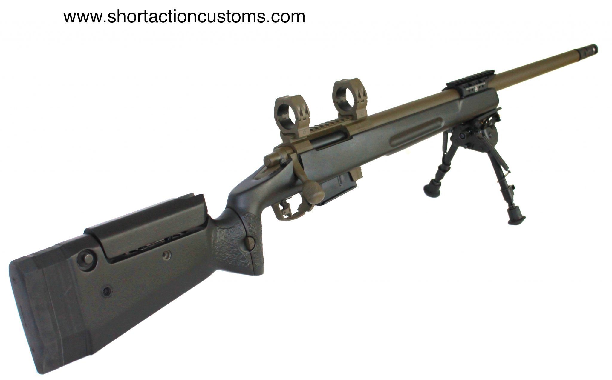

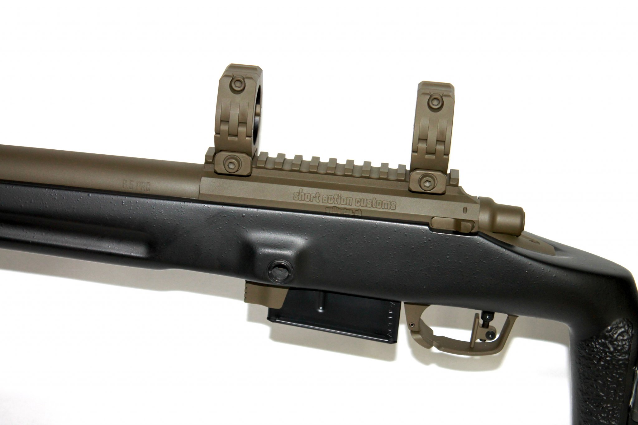

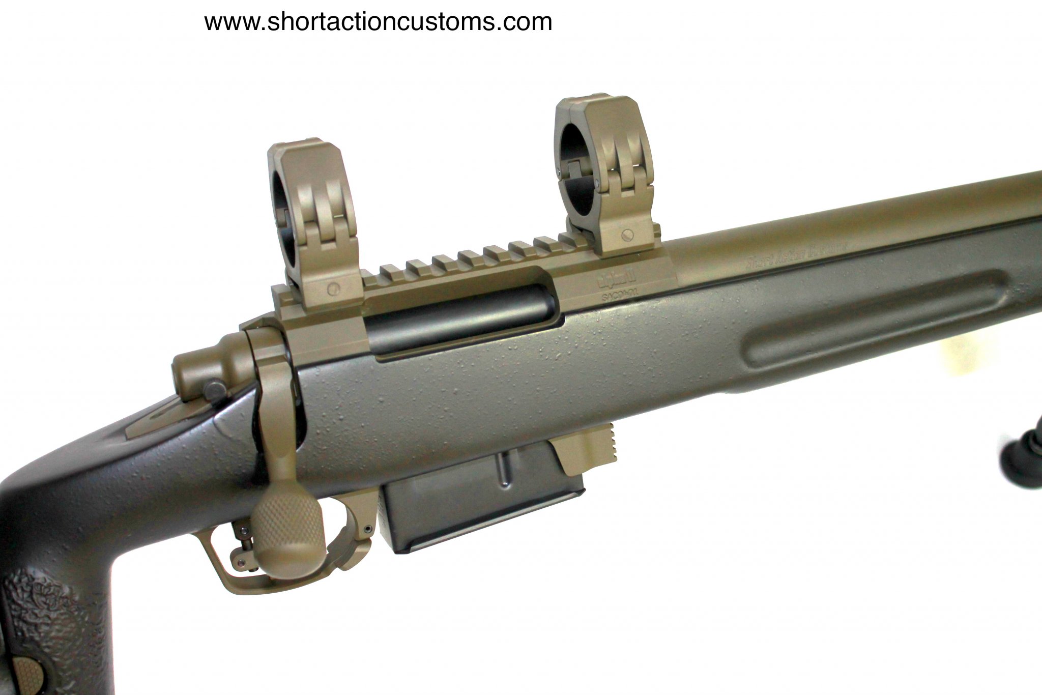

Mines done and ships next week. Went with a 23 finished length. I will be severely diapppinted if the factory 143’s shoot under 2900.

She’s ready, hopefully she does more then 2900 with the factory stuff because I’m not reloading
