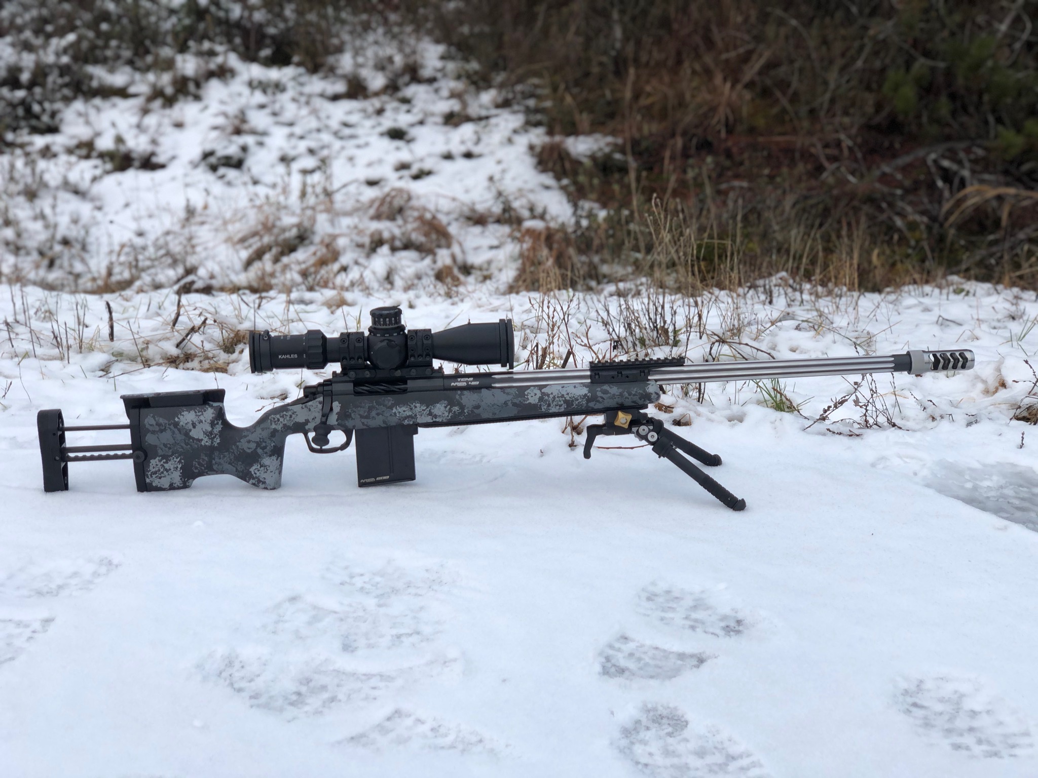

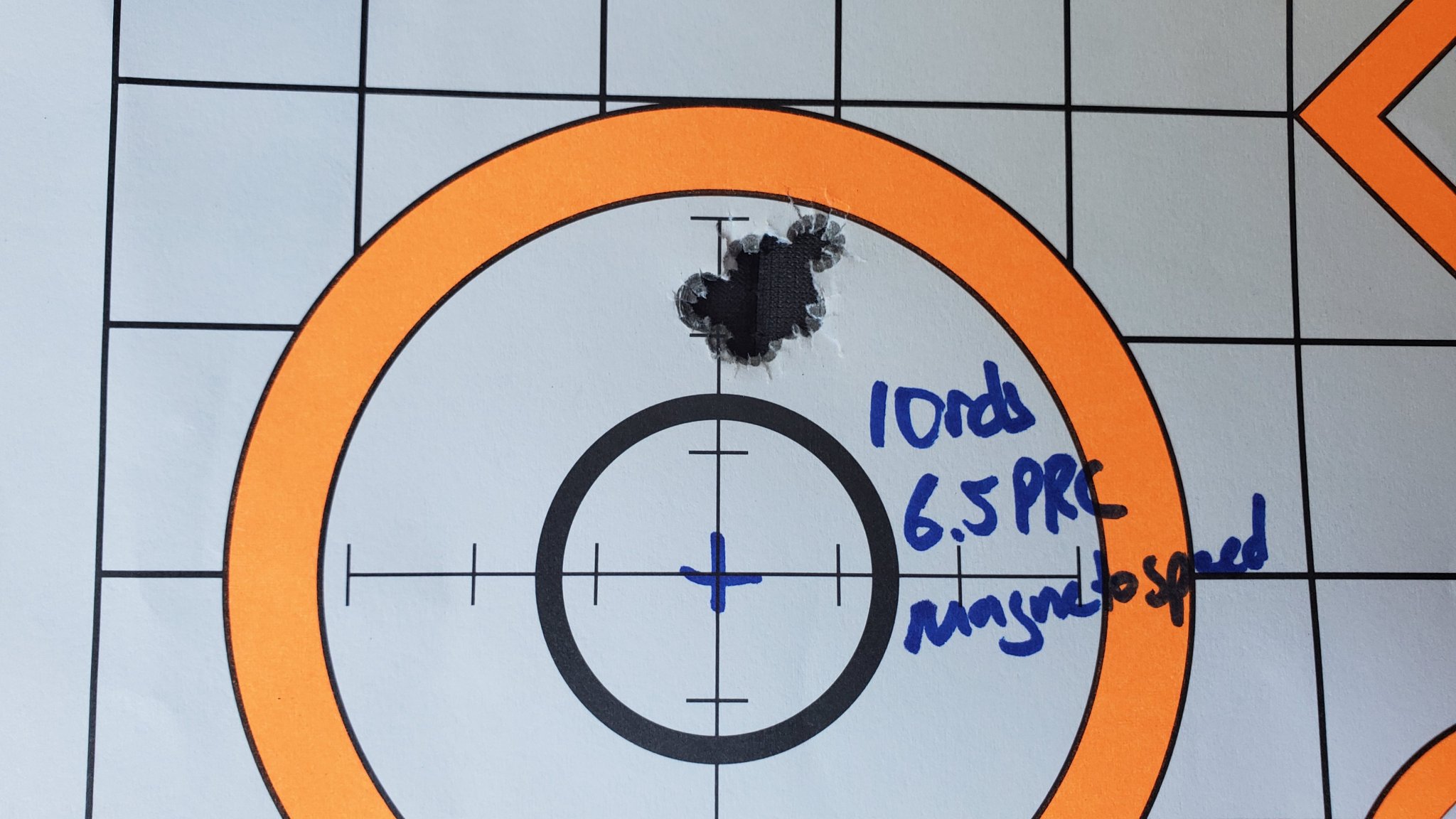

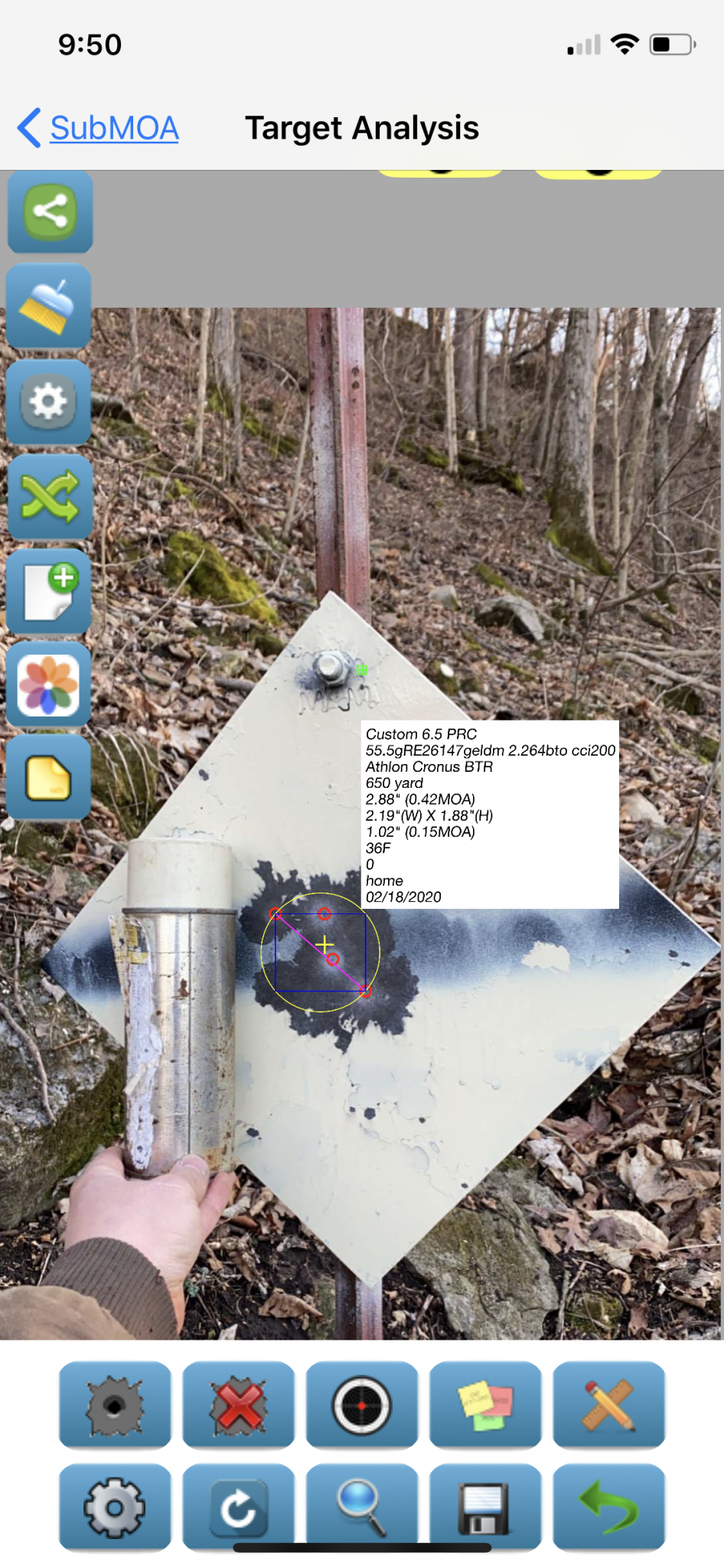

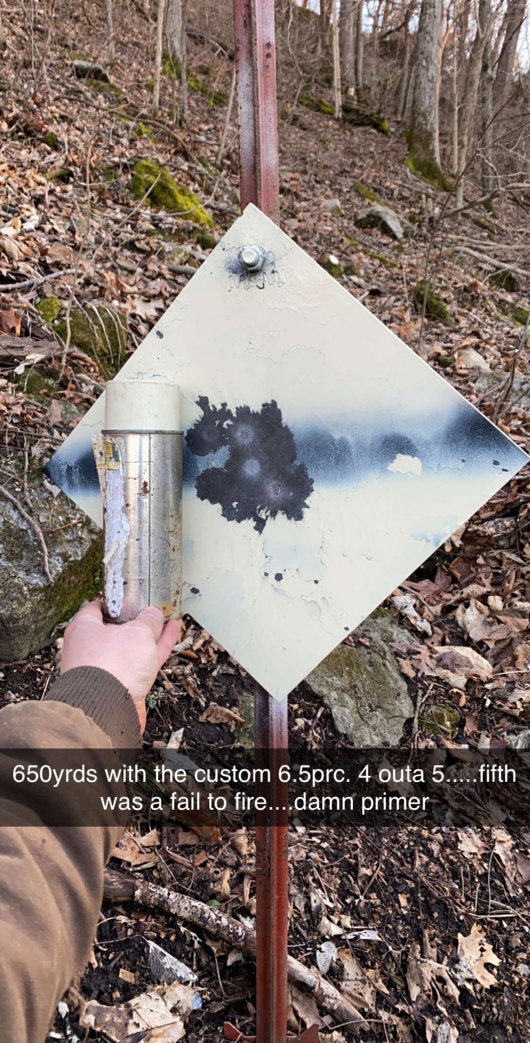

6.5PRC, WTO switch barrel Bighorn Origin, 26” Krieger LT Palma 1-7 4 groove, Athlon Cronus BTR, Nightforce rings, KRG Bravo.
42*F, 29.76 inHg, 54%RH, -908 Dalt, environment taken with kestrel 5700 ballistic/link model.
55.4gr RE26, Gunwerks neck turned virgin brass, CCI200, 147 eldm at 3023fps avg. logged for shots. I have velocities for these four but not here at this time. 650yrds taken with sig 2000, 3.4mil of elevation and .2mil left.
I tried the previous Sunday and nothing was working on my favor, kinda forgot to zero the rifle at 100 which threw everything off, pretty sure I adjusted the windage wrong, kestrel wasn’t set up yet, freaking armadillo ran 22yrds in front of the target and at 628 the little bastard was always moving and was pretty hard to hit, getting dark and my pregnant wife wanted me to grill some steaks.....shot this Tuesday. Pretty happy with the load/rifle.

On your origin, what stock and mag are you using? I had an origin, briefly in 6.5prc in a manners gen1 mini chassis. It feed good, but the shape of the ejection port and size of the PRC case would cause it to catch empties between top rear corner of port and the top rd in mag. I used these same unmodified mags in a deadline in 6.5orc without issues, but its ejection port is shaped and sized like an ai.
Do the math on that, what was the rpm of bullet? Manufacturers have rpm limits on bullets.

I’m using a KRG Bravo with a...... .223 accurate mag mag. Took the .223 plastic crap out, put it back together with the guts of another mag that got a 6br kit from primal rights for my Valkyrie, tried it, it works and has been working great!
The other day I stuffed 4rnds in that lil guy and nothing liked it much. When I chambered round #5 and then put the mag in, #5 casing would hang up like you said and on #4 round, then it was like a chain reaction.....there was obviously too much pressure on the cartridges to the point that when I’d move round #4 in the chamber it would hang up on the cartridges below and would push #3 forward in the mag and just wouldn’t feed......thought I’d try it once since I can fit 4 in the mag but it just don’t work, I’d say if the mag was about a 1/2” longer 4 would fit without the issues. Other than my experiments with what works and don’t work, it feeds, functions and ejects great, at 2.264”cbto or ~2.960 coal.

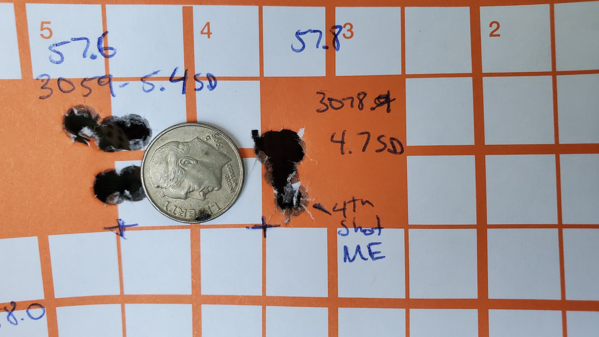

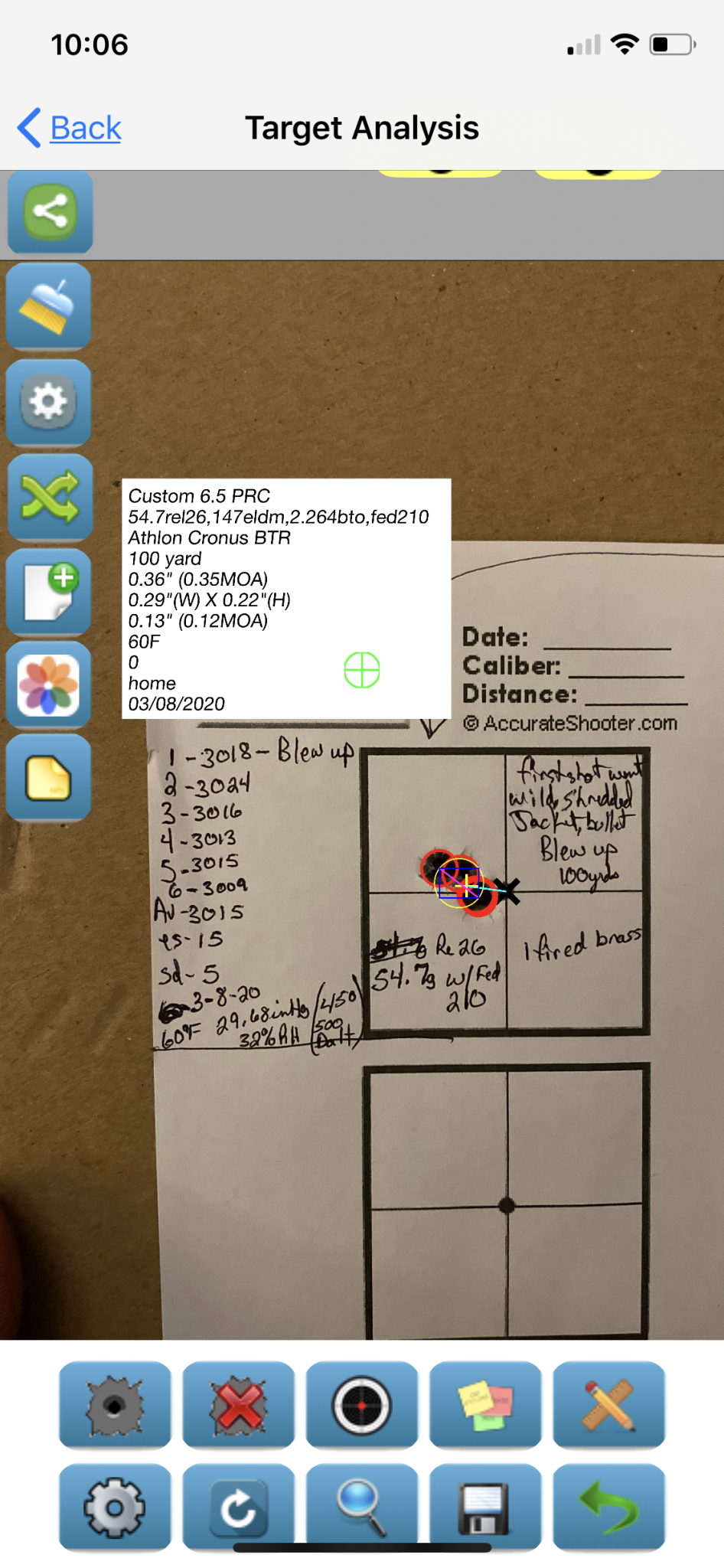

I’m thinking mine might have been on the warm side and probably plenty of powder fouling, guessing, but the next 5 went into a ragged hole at a 100 with testing 54.7gr of re26 and fed 210m’s.
In my gun I think I like fed210m’s with re26although cci200’s weren’t bad but with the feds I can lower charge weight from 55.4gr of re26 to 54.7gr of re26 and still be ~3010-3020 with great accuracy and es/sd’s. I tried magnum primers in feds and cci’s and not good at all.

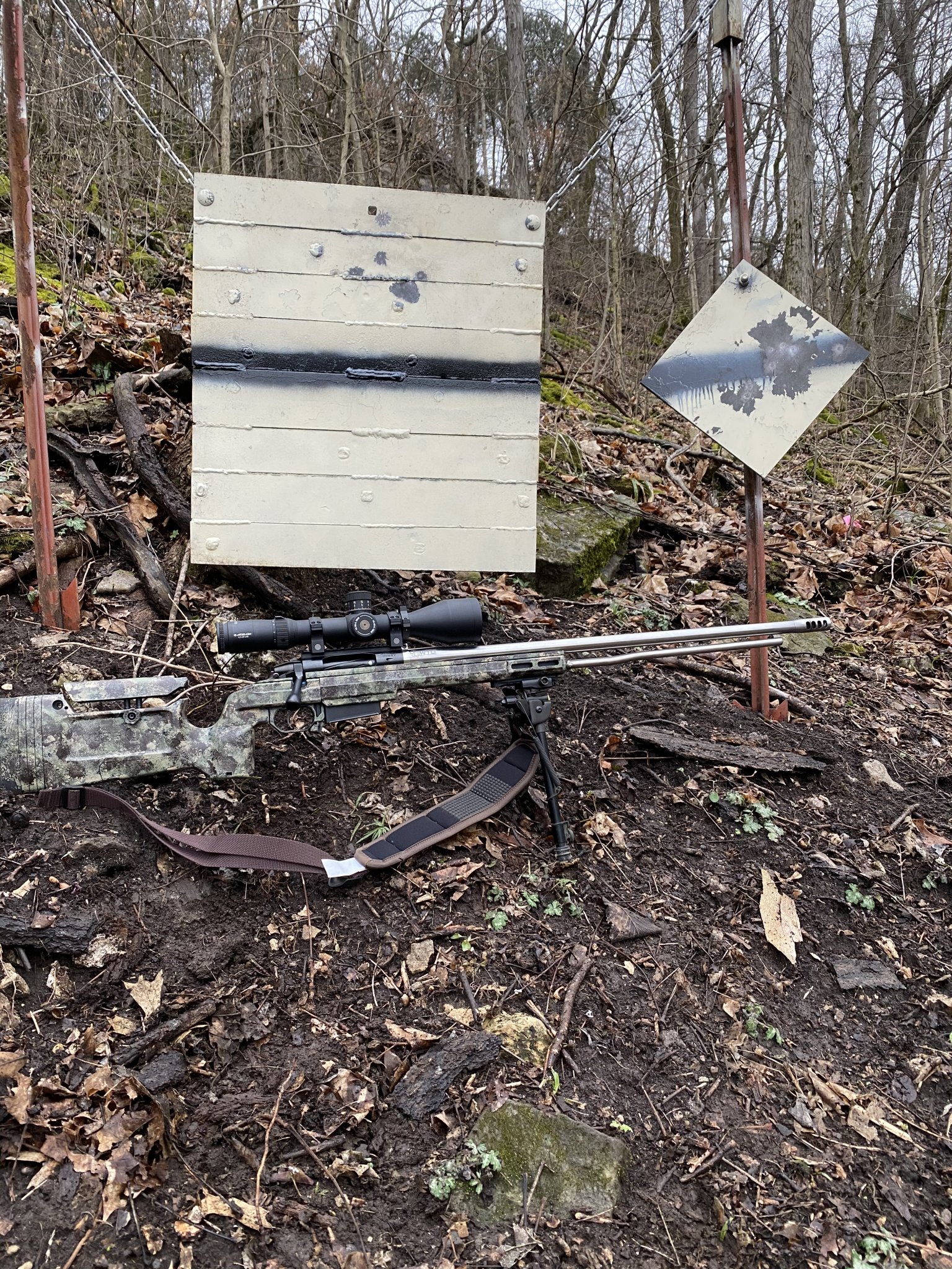

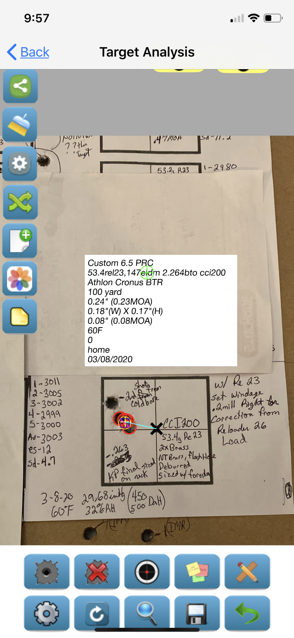

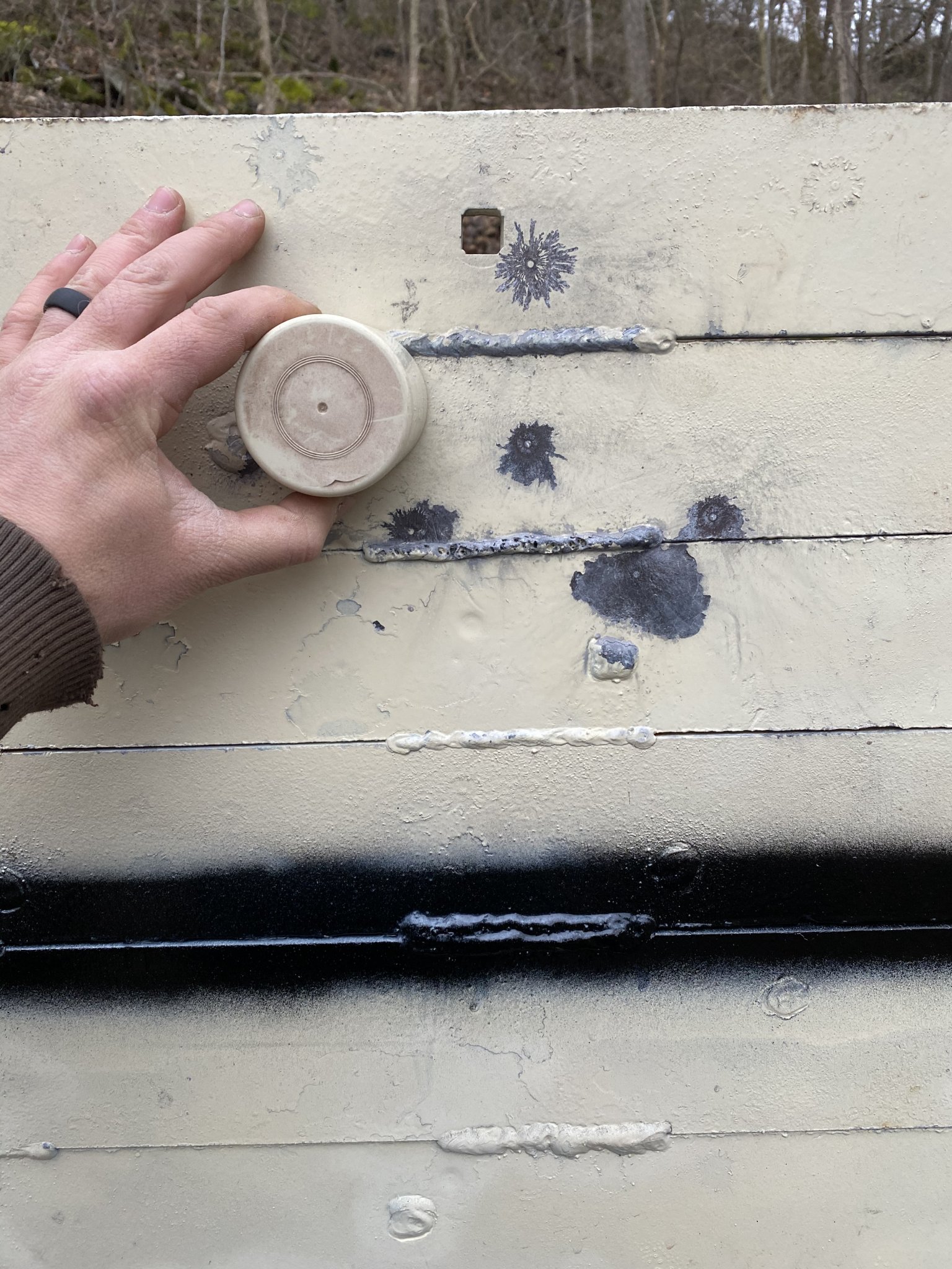

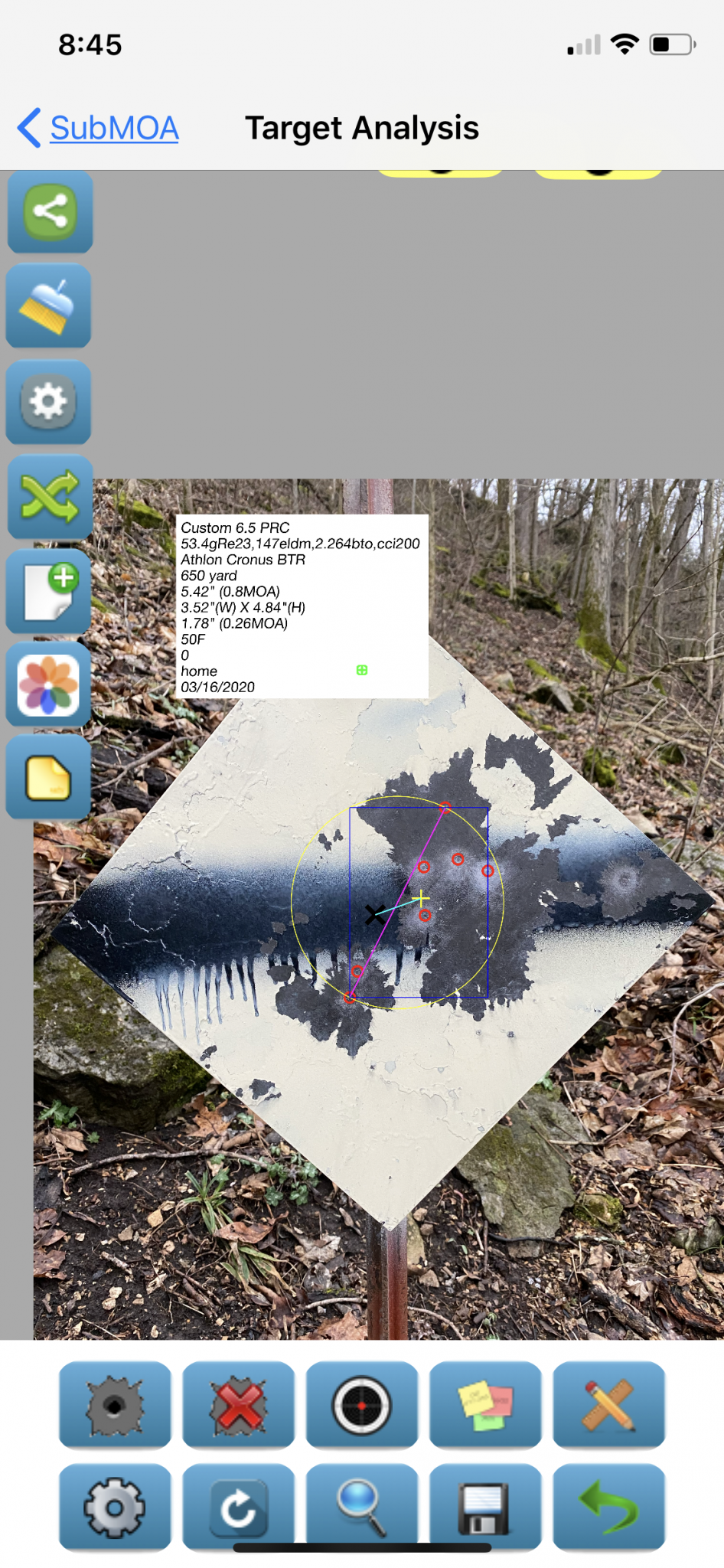

Took the ol girl out tonight, 650yrds was ok, had cleaned the the powder residue out because I had a bullet blow up so I thought I would clean it a bit, didn’t clean the copper out though and the first three rnds were all sorts of wonky getting it seasoned, that’s why the one wide and right didn’t get counted and the rest was the scope correction. All rounds were loaded, realized I fucked up on charge weight, pulled bullets, resized, recharged and then seated same pulled bullets.
weather:50*F, 29.59inHg, 66%RH, -117 Dalt
53.4gr re23, cci200, 147eldm at 2.264bto, 10 shots were taken at this target.
1-2977, 2-2988, 3-2992, 4-3003, 5-2994
Av-2990, es-26, sd-9.4 these were loaded for a longer period of time)
1-3004, 2-3003, 3-2996, 4-2997, 5-2997
Av-2999, es-8, sd-3.7

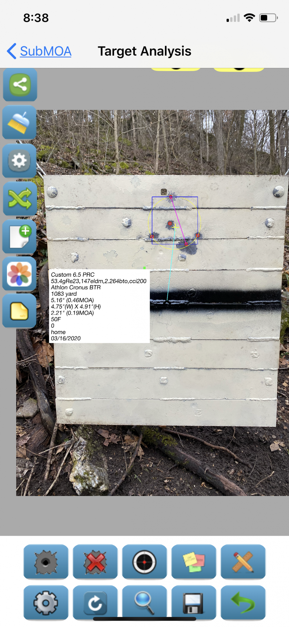

1083yrd target......same load as the one just above here. It started to mist and target was starting to get blurry from the mist.
1-3009, 2-3003, 3-3004, 4-2998, 5-3003
av-3003, es-11, sd-3.8
Annnnd a little fun took two shots at 1083yrds with my re26 load....first shot was at the handle and second shot was a .2mil correction and hit great, no explosion though☹. 54.7g re26, fed 210m, 147eldm at 2.264”bto. Both shots were at 3013fps.
