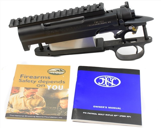

WT1 - What action did you get? What is maximum OAL that action supports? If you have a Montana Rifleman 1999, that mag box allows for a 3.125" OAL which means you can seat bigger bullets longer. 7WSM with bigger bullets and 2.830" max OAL hamstrings that cartridge a bit, 3.100" OAL changes the game significantly.
It's an FN Patrol Bolt Rifle action made in Fredericksburg, VA. New. Came with their standard rail and a Winchester 70 trigger, which is adjustable. Comes to my FFL early next week. I prefer a claw extractor to the other bolts. Nothing like a claw extractor when you are hunting around dangerous game.
It has an internal magazine, so I am guessing that is its max OAL. I found a kit though on an online gun auction web site. The kit allows you to change out the hinged floor plate for a DBM system and the guy says the magazine is an extra eighth of an inch longer than the internal magazine. But they are 308 mags and I don't know if I can fit the SAUM or WSM cases in it.
I was not aware Wisconsin had so many excellent barrel makers. Plan is to put a Krieger, Rock Creek, Brux, Broughton, Bartlein, or another brand barrel on it. Going to weigh the action when it gets here to help decide barrel contour. Already know somebody at Krieger so that is probably the way I'll go and they all make the highest quality products.
Mag box from a Win 70 CRPF action, factory barrel in 300WSM, measures 3.050" so you could easily run 3.030" OAL from that hinged floor plate set up.
