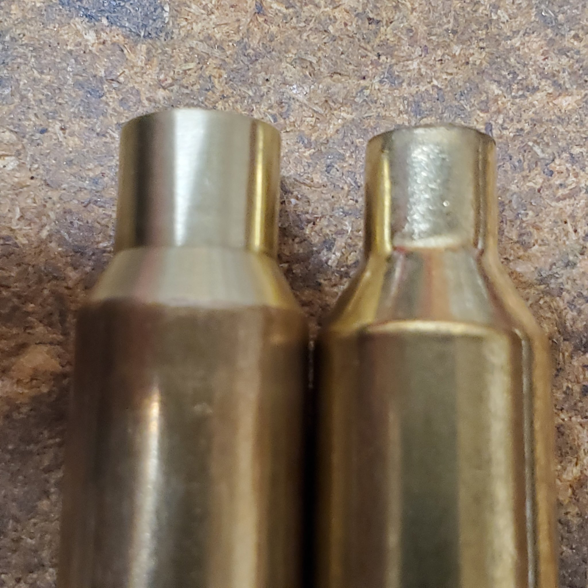

Minor load work update:
I picked up an expanding mandrel from Cortina and reworked my brass process.
Shoulder bump .0025” with full length die(no neck expander on the de-caper), & .282 neck mandrel in the mandrel die. All to brass with multiple fires. The test was 10rds, average velocity of 2873, SD of 10fps, .75” group at 100.
I did stretch it out with some fire forming loads, I’ve got to get back to reading the wind. Had good consistency out to 600 on a 10” gong.

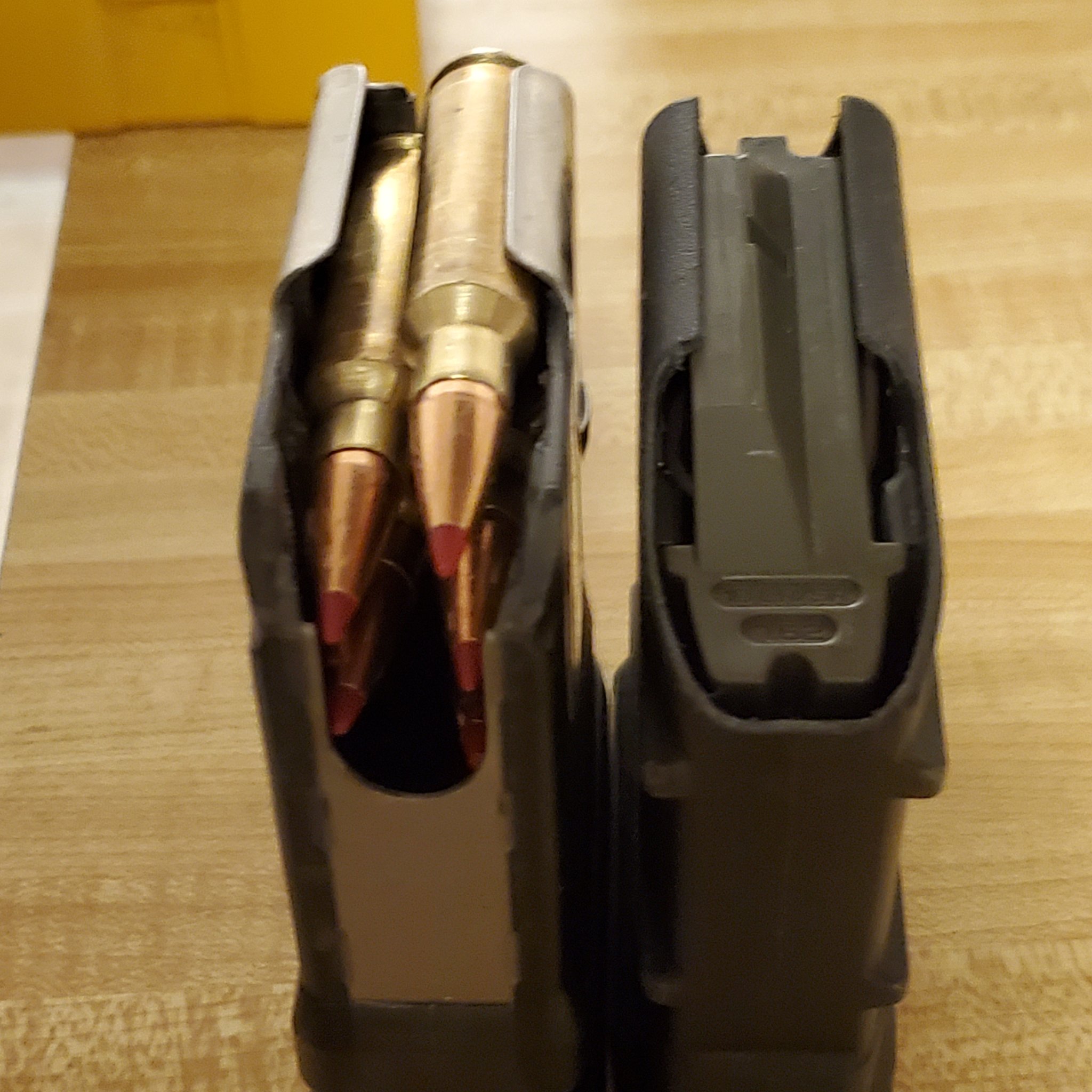

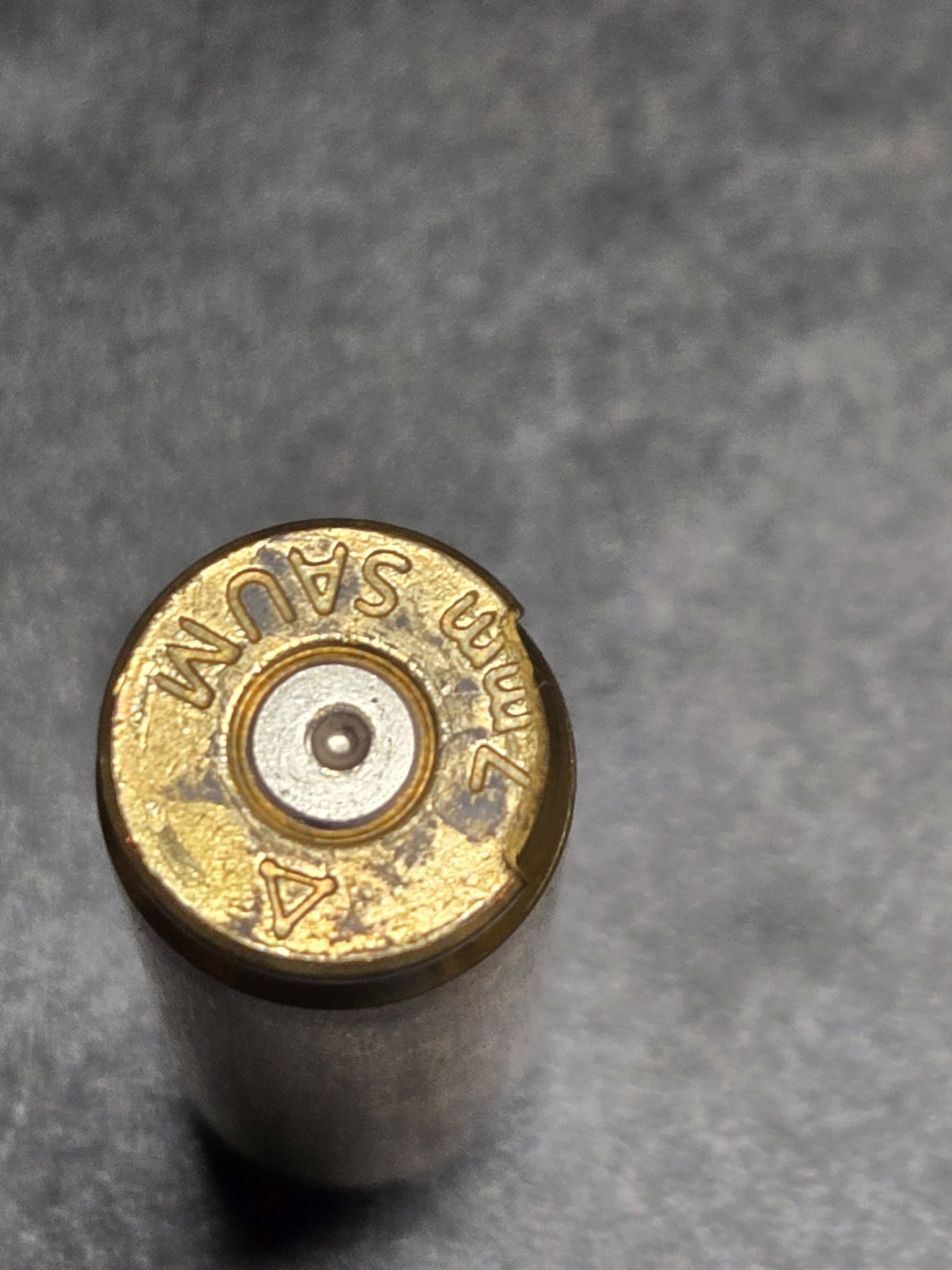

So I finally got it built and did my first test firing.
162gr ELDM
65gr Accurate MagPro
CCI 250
ADG brass
2860fps
26" xcaliber barrel.
It ripped the edge of the brass off, bolt locked back and left the round in the chamber. The gas block was not working properly and was over gassing the rifle badly. I installed a new adjustable gas block and turned it way down. I also worked up a couple loads with different powder, we'll see how it goes!

So i put on a new gas block. Tried the same load and same results. Something to note is the brass had to be knocked out it, it was stuck in the chamber. I tried 50gr of H4350 and it cycled fine, but speed was 2660fps. I tried some IMR4350 and it stuck in the chamber, but not as bad as the MagPro. I ordered some factory ammo, I want to see the speeds and if I have an issue. I'm wondering at this point if I have a problem with brass. I bought it used once fired. I also loaded up some more rounds with non magnum primers. I'll post the results.

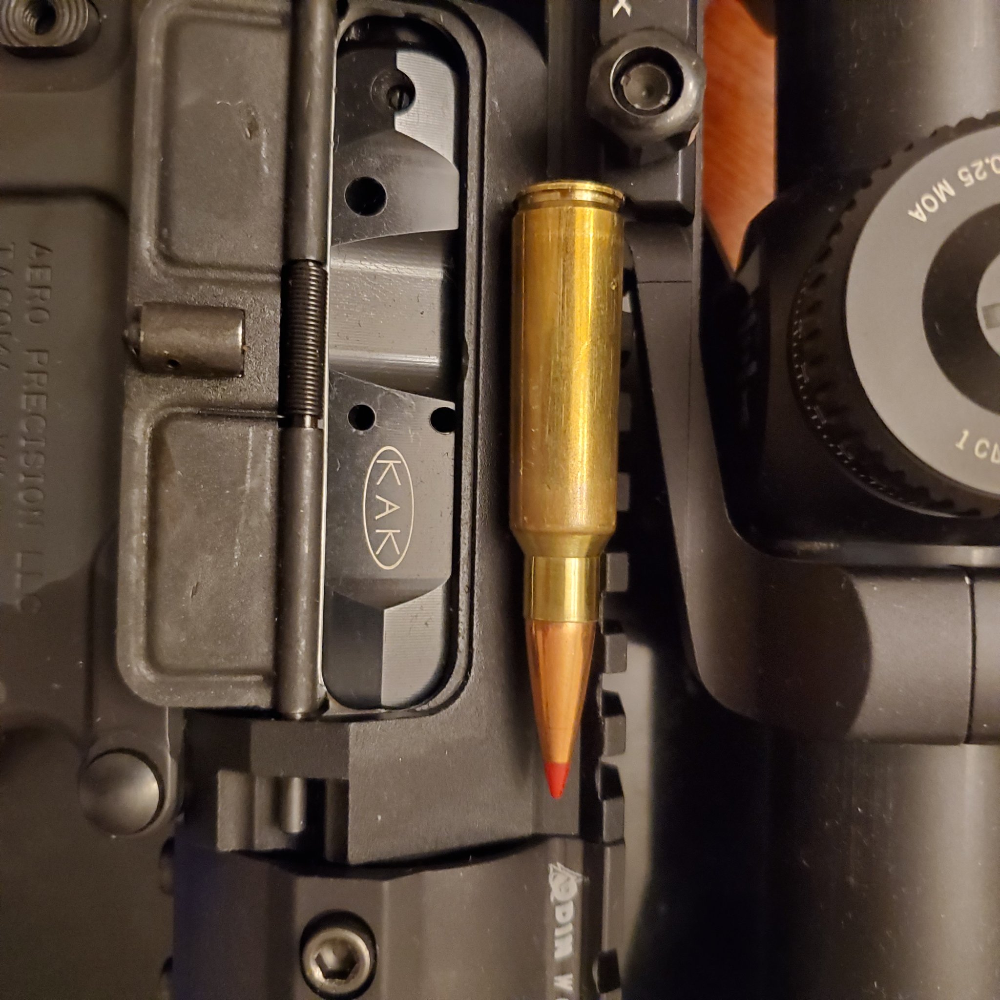

Measure your 1x fired brass at the .200” line….and down toward the base.
How much larger than factory new brass, is the 1x fired brass?

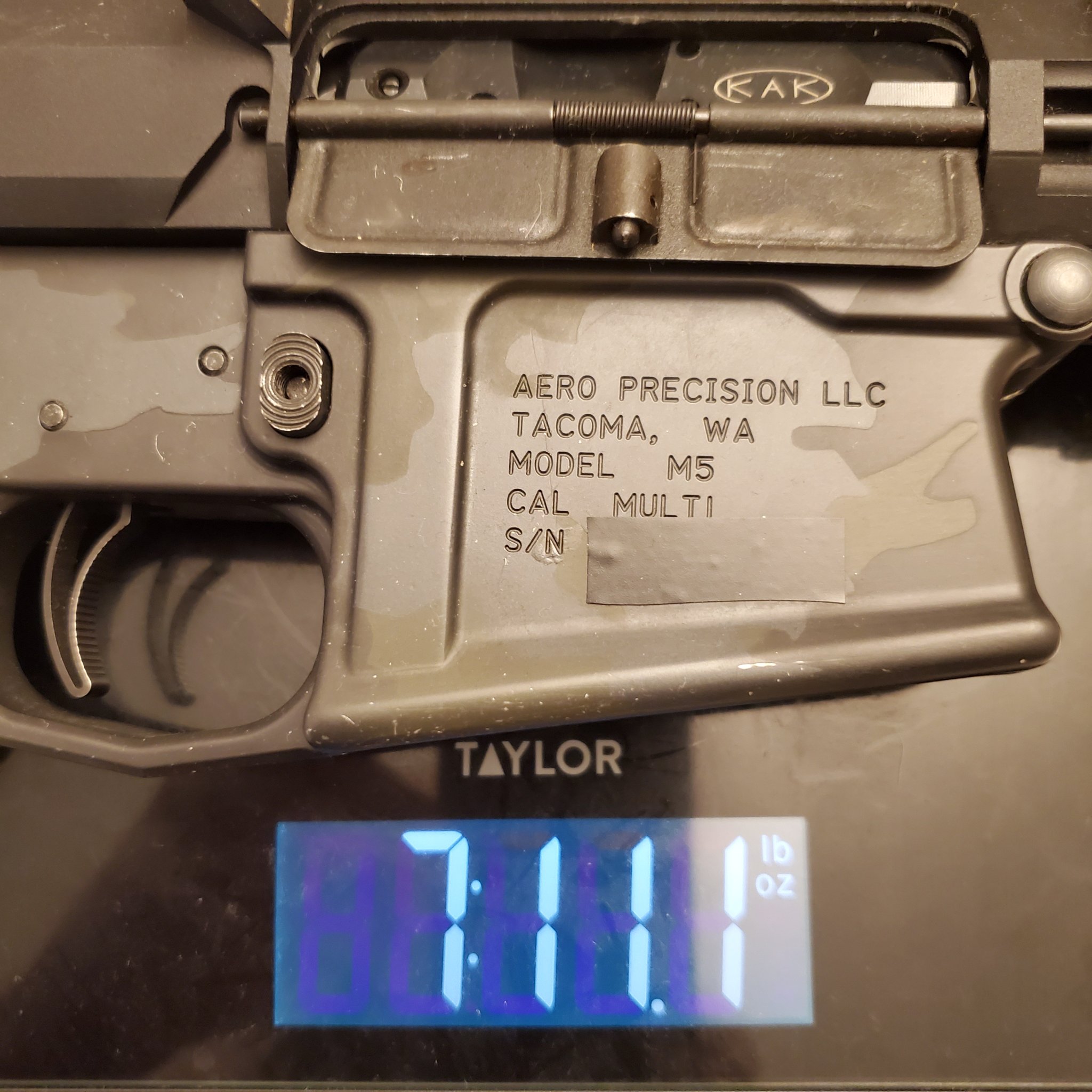

Doesn't everyone own a magnum AR10?
Mine is 7 lbs 12 oz without the heavy 25X scope. Comes in at 10 lbs 12 oz with scope, with an 18" fluted barrel in 338 RCM. They are accurate and capable for certain tasks. The 250 gr bullet around 2600 fps with RL 26 is a good moderate range big game load the 160 gr Barnes for deer.

I use magnum primers in my AR 10 338 RCM rifle length gas on the 18" barrel with an adjustable gas block.
The lower is standard carbine AR 10 Areo Precision, off my 308 Win, nothing added, nothing special. A KAK upper reciever and bolt carrier, & Odin handguard.
I chambered the barrel with my own reamer to headspace off the KAK bolt...so no help there.
But it handles all the 65,000 psi max loads in the loading manuals I've tried with a variety of bullets, and functions great.
I have one modified mag, with cut out, to run 2.940" COAL, but Magpul 7.62 P mag works great with the first 3 or 4 in the 10 rd mag put a total of 7 but it bulges the plastic, not good.
Ding, Ding, Ding you are the winner sir! I measured all my brass and the .200 line for 90% was .551. There were about 30 that measured .545. So I loaded them up and they ran perfectly! They did stretch out to .548, but I cleaned them up and resized them. They still measured .548 and they loaded fine. So I'm guessing the guy who fired them first had a hot load and a loose chamber and they stretched out to much and didn't bounce back. This sucks, but I'm glad to know what the problem was!

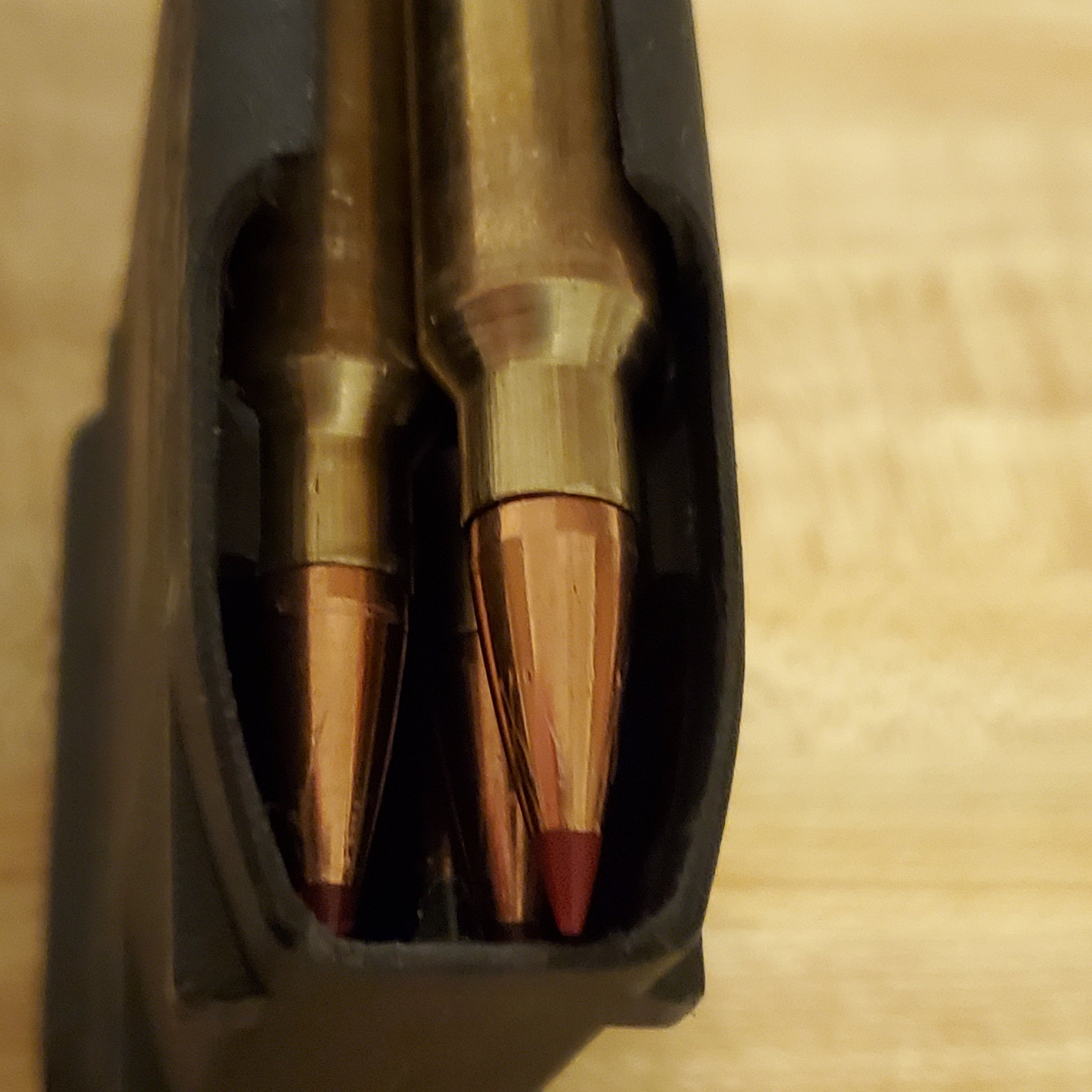

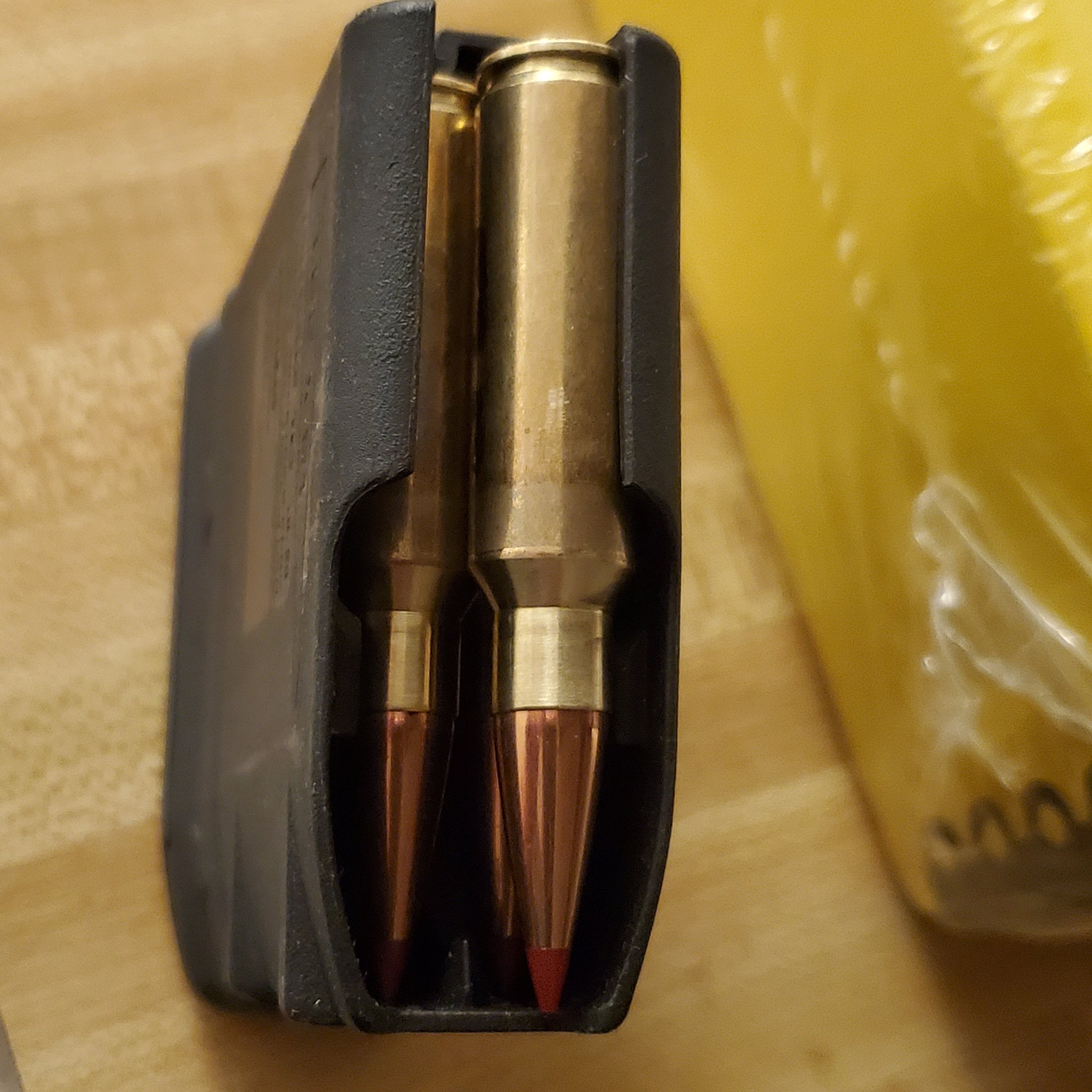

See my photos on page 1 for resolving the mag issue. I design inserts and had a buddy print them that converts a steel mag to single stack.

I ran into the same issue with the base being oversized, a cortina neck bushing die(that sizes the base) solved it.
Thanks for sharing, I got the standard mags modified enough to run 5 rds constantly. Still a little resistance when inserting them, they fall free when empty.
They are easily workable, but not perfect.
A full 7 rds is not workable at this point with these mags, & my mods, so although 5 is actually enough...wonder how long these will last, without a permanent bulge, and be difficult to insert.

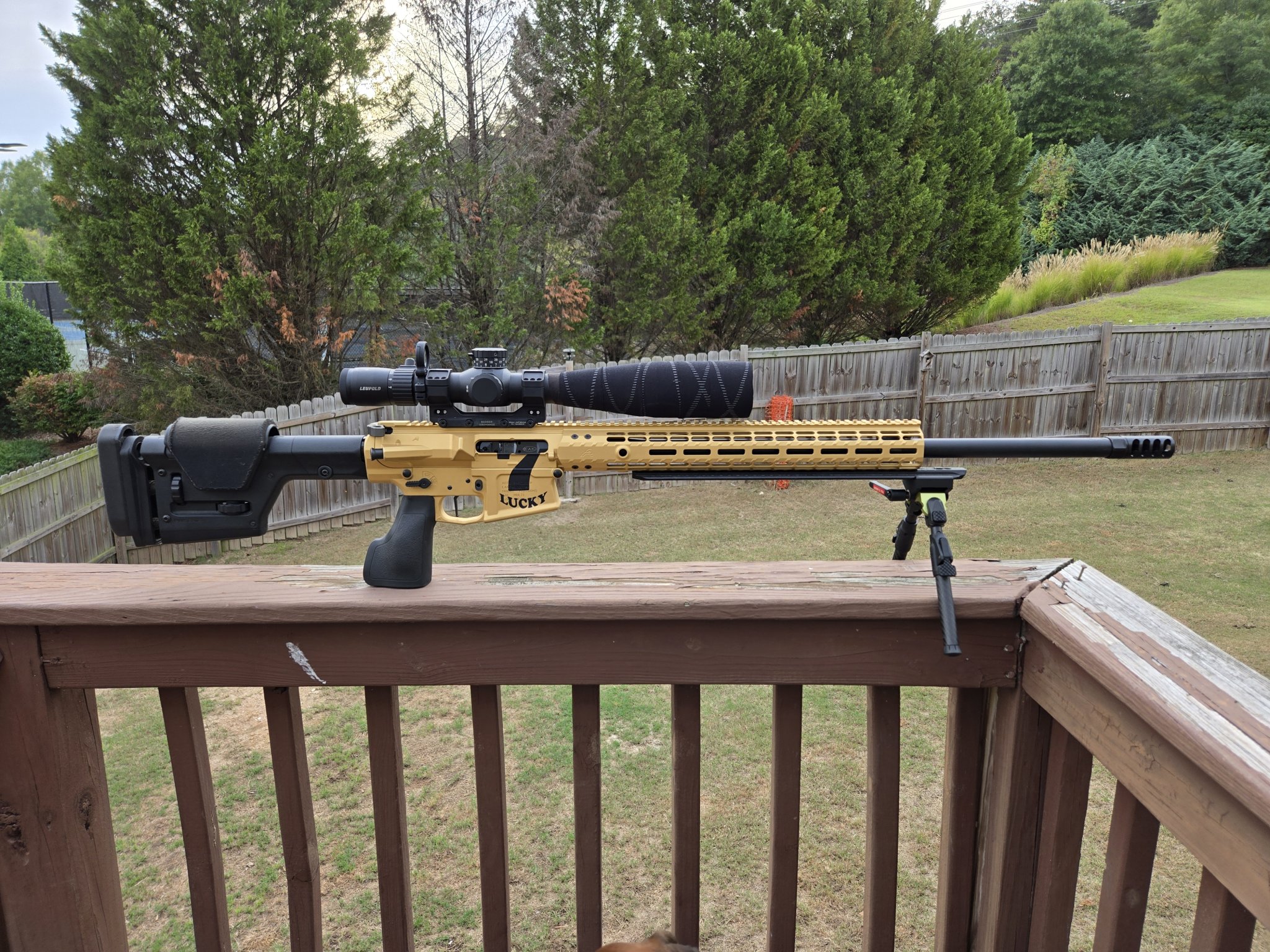

Mid hunting season update
I’ve taken 4 does so far this season, ranges were 150ish, 250, 375, & 660. All great terminal results. The doe at 660 I pulled the shot right and didn’t catch her square in the shoulder, it was a little more forward than I would’ve liked. She ran 150-200yds and died.
The only drawback to the rifle is the weight.
It gets a bit cumbersome with the suppressor, I’ll leave it on this year as all my data is with it and ditch it next year.
The Bushnell DMR is just too damn heavy, I’m looking at a Leupold VX6 3-18x44 to replace it along with a SLR Ion lite handguard should shave over a pound off the rifle.
I don’t feel too bad about the weight, I saw X ring built a “light weight” AR10 in 6mm creedmoor that was dripping in carbon fiber and it came in at 12lbs with the can and it was all purpose built light weight stuff. Mine is 12 without the can.
