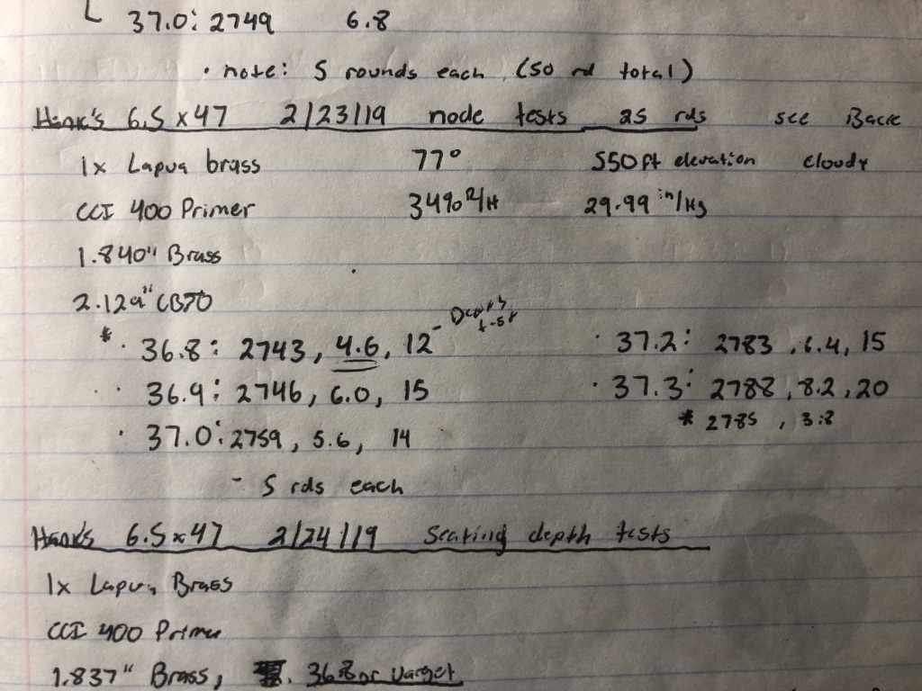

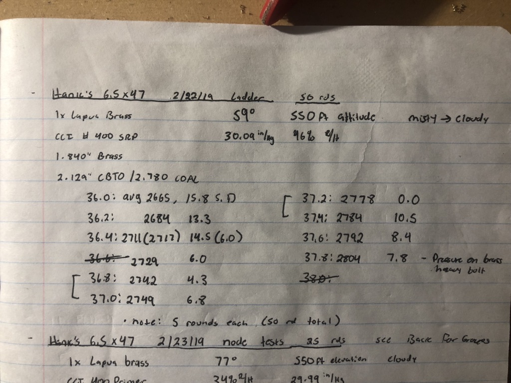

So I finished my load development and here are the results...

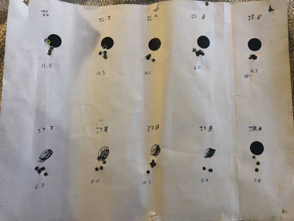

-I started with a ladder type test with five round groups, from 36-38 grains of Varget increasing in .2 grain increments. I tested with a magneto speed. Picture of results is posted below. I ended up finding a node between 36.8-37 and another smaller one between 37.2-37.4.
- So the next day I went back and shot those nodes in five round groups again to re confirm the node, this time loading in between the other charges to see. I ended up settling on 36.8 because over the two days, it had the most consistent speeds despite the temp change, and the S.D stayed the same. It also shot very good groups with a magneto on. Below are the results of the second tests

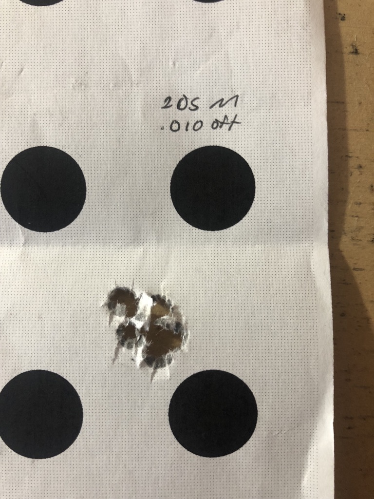

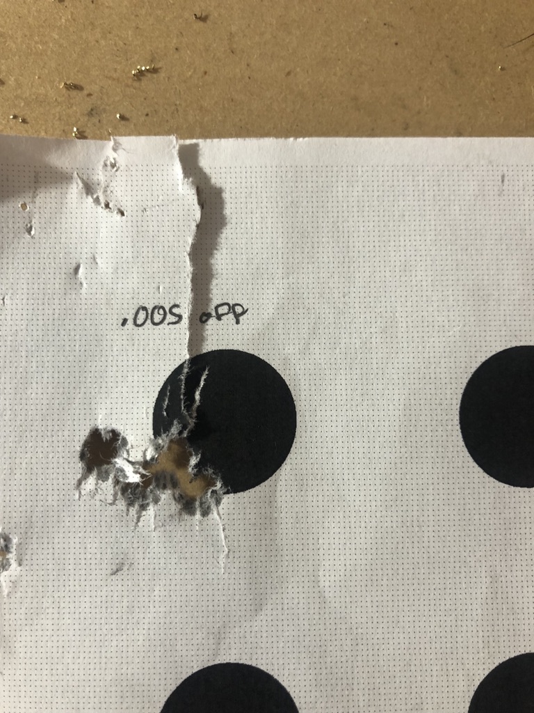

- Finally, yesterday I did a seating depth test with 36.8 grains without the magneto on the end. Im torn between .005 off the lands and .010 off. .005 off has a smaller group and I think the horizontal dispersion is me because im not the best group shooter, but .010 off shot the same looking group two days before with a magneto on so I feel like it is a consistent load. Im settled on 38.8 grains .010 off of the lands. Below is the results (just .005 and .010 off) of the seating depth testing. Ive not included the four other groups just to save post length.
-By the way, the .005 off is .67MOA and the .010 off is .69MOA. Also attached below is a picture of the groups from the initial ladder with a magneto in case anyone is interested.
