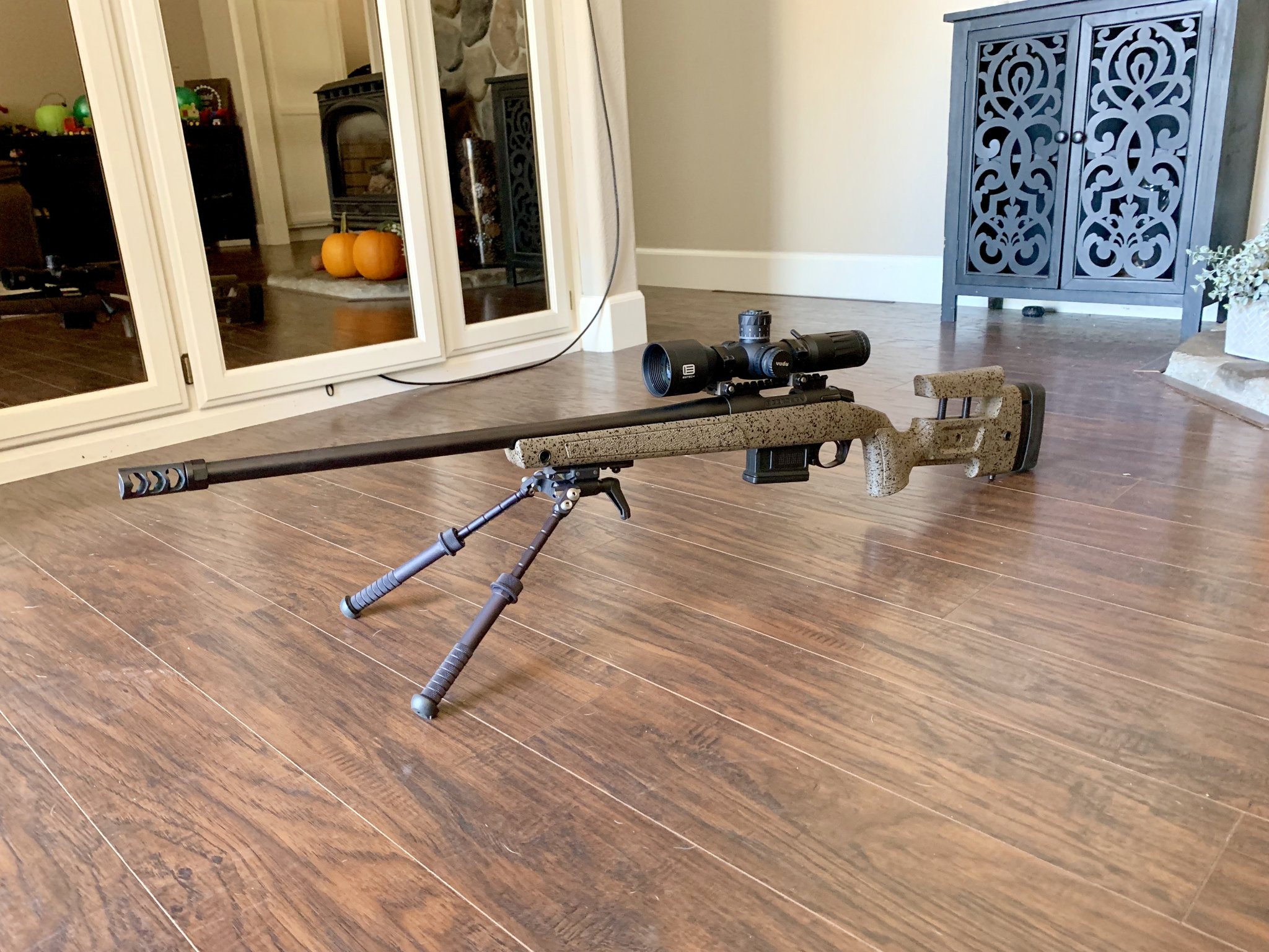

Dropping it in a mpa light chassis and putting a trigger tech special in next week.

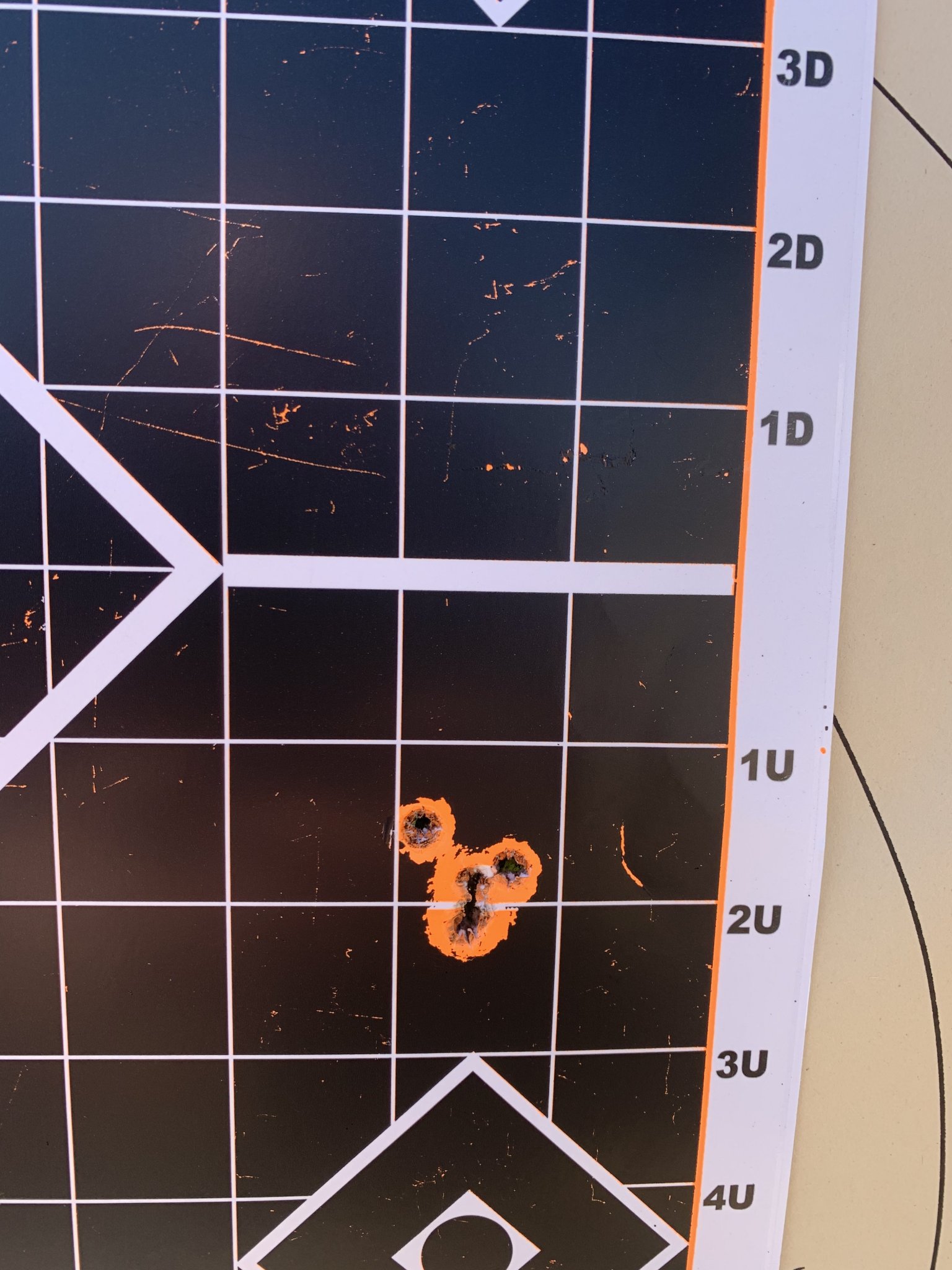

42.0 grains of IMR 4451
Hornady brass FL sized, 3x fired, not annealed.
Fed. 210M primer
26" Criterion 6.5CM, 8 twist.
6 shots-Avg2904, high 2927, low 2895.
2.7 mils to 500 yards
72°F 1630 DA
grouped well for hunting bullet imo.

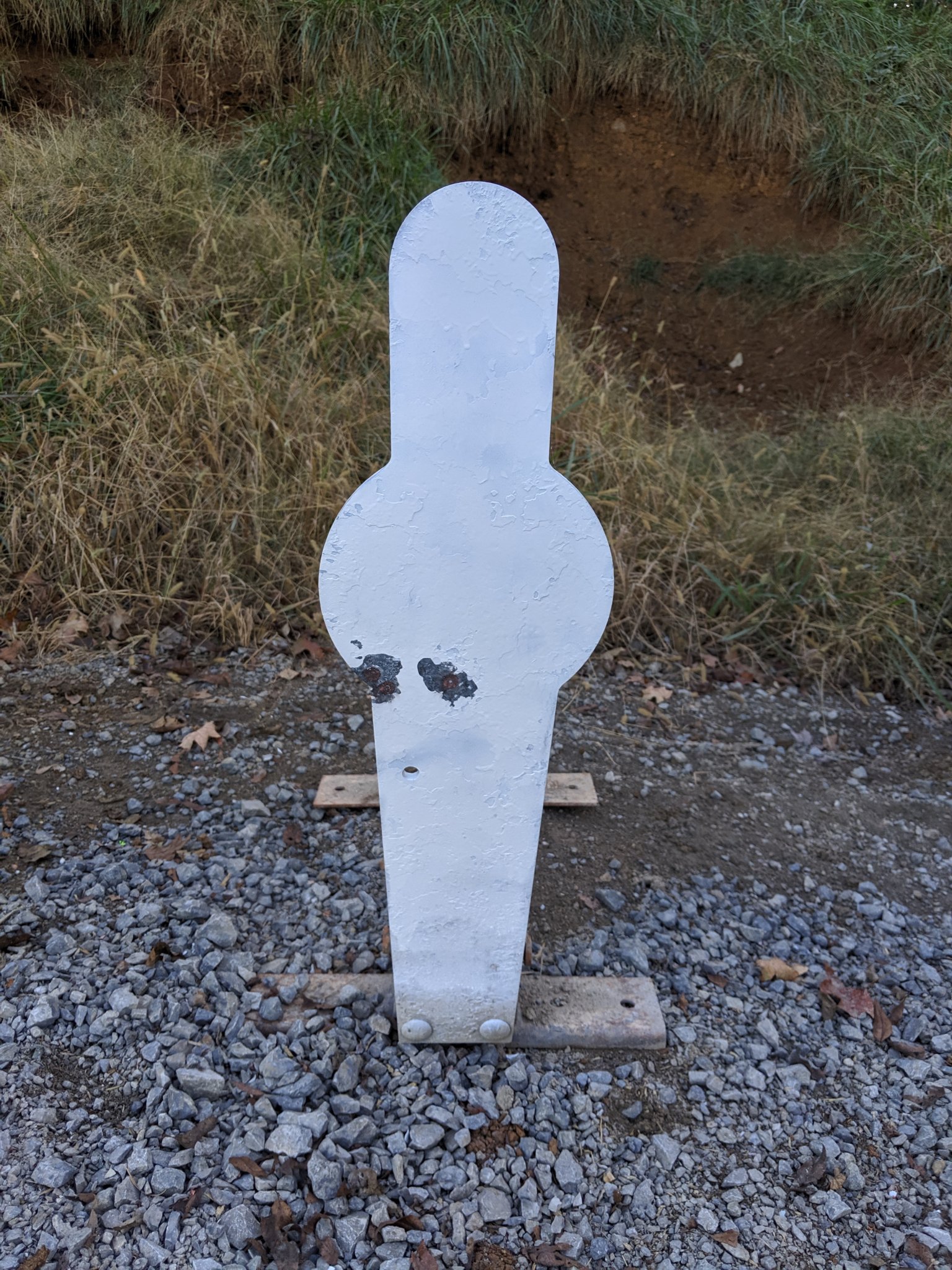

Shot both Hornady 120gmx and 120ttsx to 820 yards today. Both shot almost identical. 5.9mils drop with 1mil wind. Wind was 5mph left to right. Hit 12” plate 6 of 10 with the 4 misses being just off the edge. Would have easily been a vitals shot if it was on game. Feel pretty confident with this projectile inside of 600 with sub 10mph full value wind. I’ll be doing some varmint hunting with it and would like to get a longer shot on a coyote but at 800 yards it’s dipping down to about 500ft lbs of energy and less than 1300fps. Pretty sure solid copper won’t perform at this speeds on a game animal.
