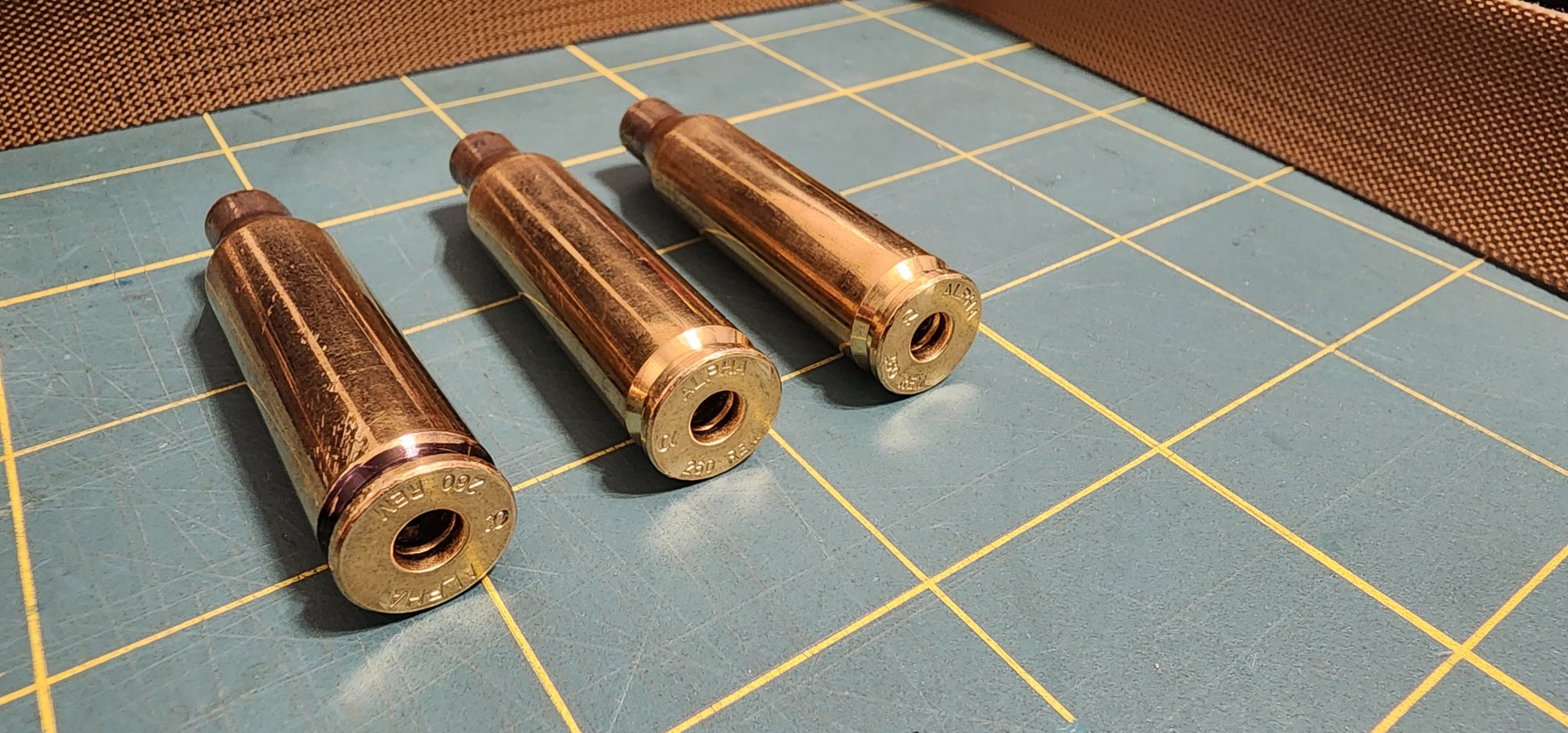

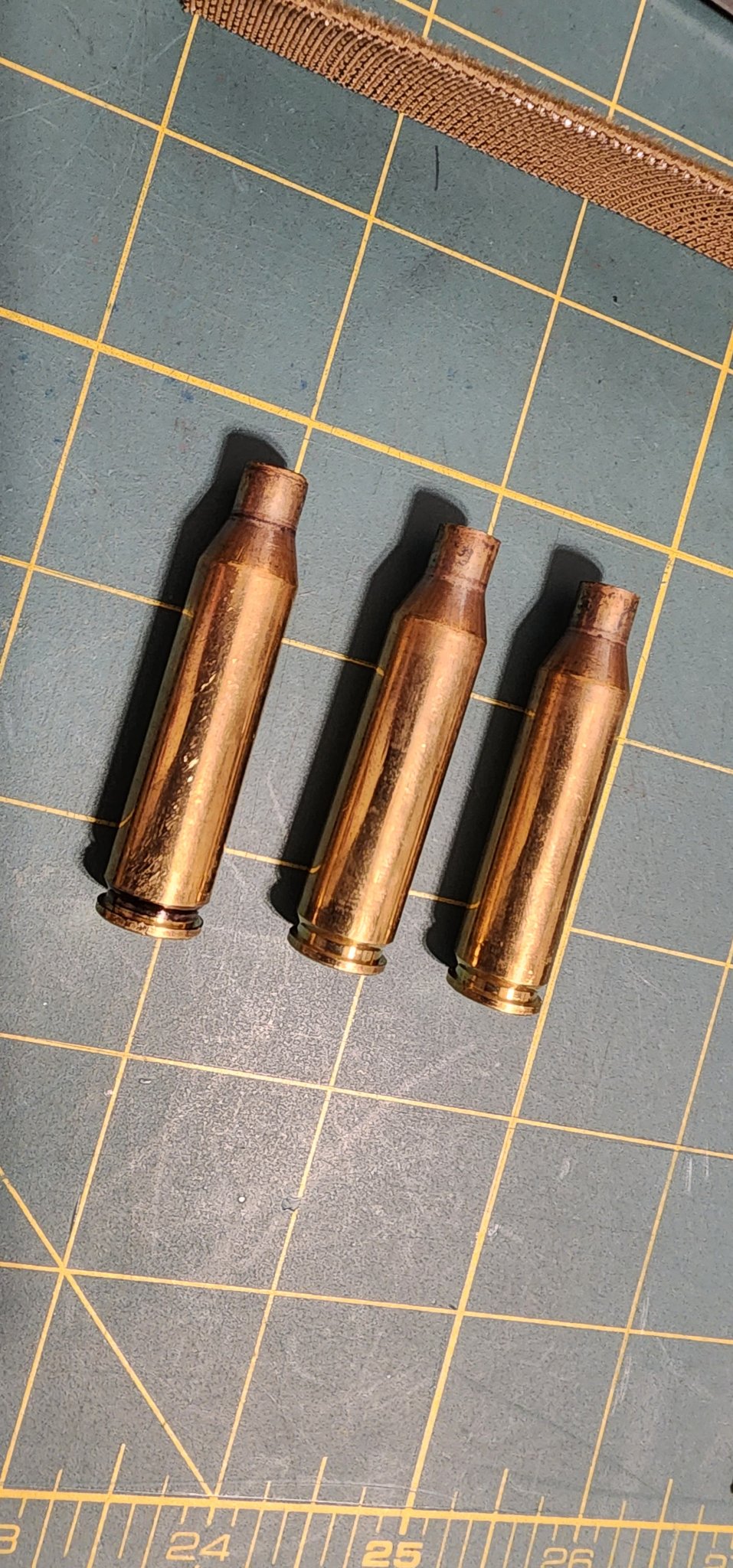

Okay these are three pieces of alpha brass I just shot the other day, what I consider almost a perfect hand load. I'll add the velocity data as well. At about 2800 mv for a 130 AR Hybrid.
that is some clean brass, how much does your bcg weight? how much does your weight weigh? i am curious the relationship, if there is some math that a normal person can do, like my bcg weighs this much, there fore use x oz's. but i am curious. it seems like a heavier bcg will also slow stuff down.

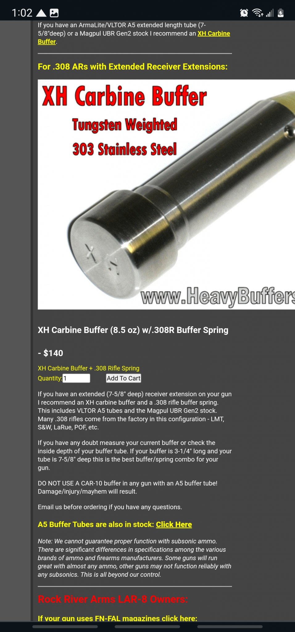

I’ve been looking around for an8.5oz buffer weight. Searches have not found

what brand or shop would you recommend for an 8.5oz buffer. which spring have you used and prefer, lb wise?
Which receiver extension are you using? Carbine length, vltor/Armalite length, or rifle?
With a pcc buffer (which can be longer than a AR15 carbine buffer) can get you close to that weight and not sure what type of setup will be needed? KAK has a 9.3oz rifle length buffer (I bought in case for 7saum and 6.5prc builds).
my buffer tube depth is 9 5/8" ,, so i assume it is carbine length
Nope that is rifle length. Your receiver extension screws directly into the back of the lower receiver with no castle nut to hold it in place. You must be using the JP buffer system with the spacer in place.
Good news is you can purchase AR10 rifle length spring and a AR10/LR308 rifle length buffer. I believe these come standard at 5.6 or 5.8 oz. Inside is 5 steel weights. These can be replaced with tungsten weights which gives you .8 oz more weight each weight you swap. In other words you can get to nearly 10oz if need be. You can purchase tungsten buffer weights separately and can experiment from there. Save that JP SCS for another more common tried and true build or sell it because most “my rifle don’t work right” threads all seem to have that part in common.
Slash and the spring he sells
You have to either use a spacer(cheaper) or swap your rifle extension. I listed the parts out in a previous post. The spacer will allow you to retain your current stock set up on the rifle length extension.
You can not or should not use the rifle length buffer from slash, it's 10oz. I don't belive he makes a rifle in 8.5 oz.
You shouldn't need 10 oz.
I wouldn’t purchase any of his rifle length stuff. He can buy a LR308 rifle length buffer and tungsten weights for less than half of the cost and is user adjustable. As far as how much weight he needs, I don’t know. I’ve never had a 16” 6.5CM.
