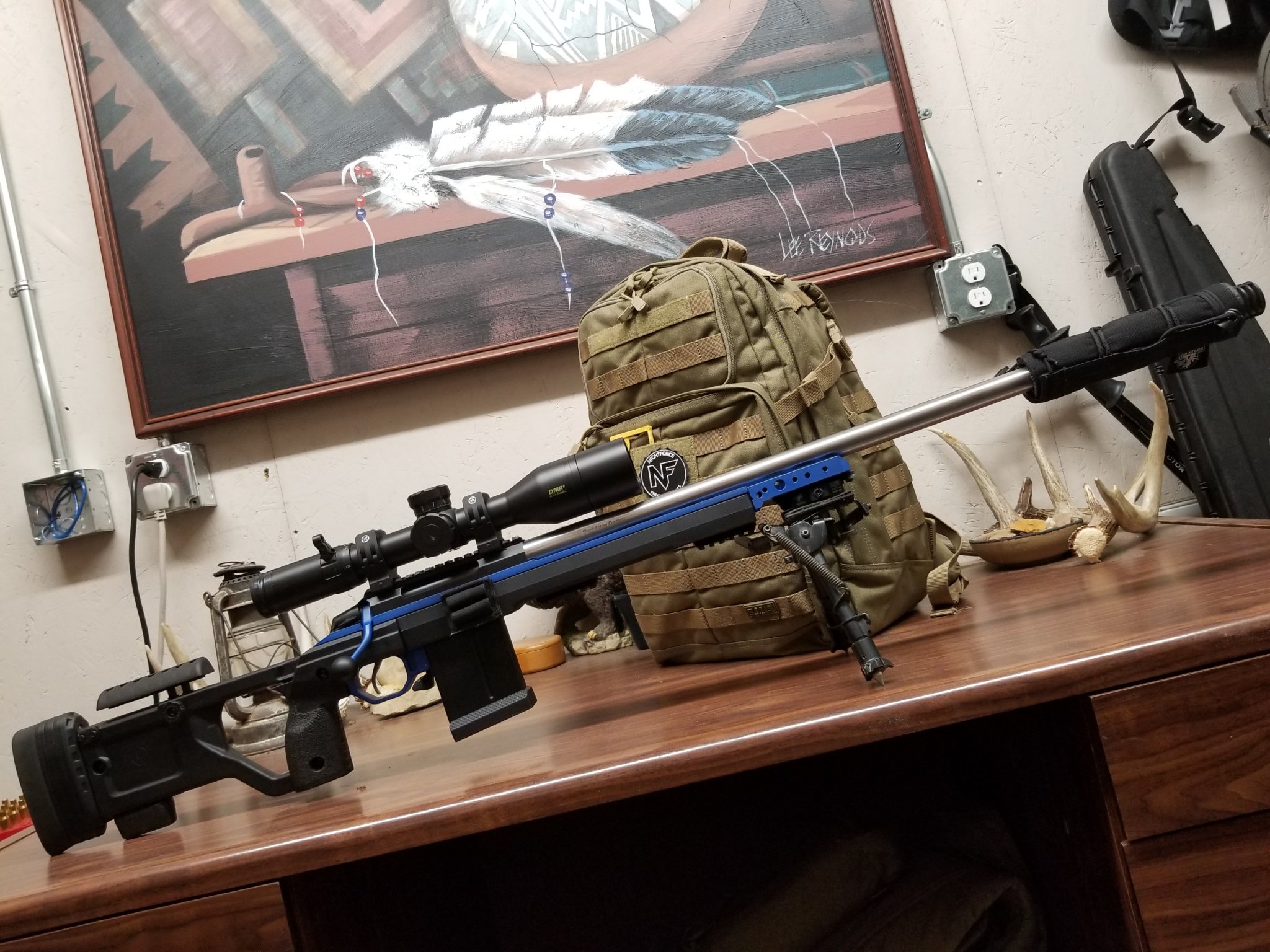

Just to give a idea this is my suppressed 26”MTU 300wm it’s just too big and heavy for competition, I’m pretty short too. I built this one for prone shooting from the truck/rzr out to a mile so I had never intended to shoot it any other way. I think the rem varmint contour is a good idea and just need to figure out a barrel length, worst comes to worse doing a Remage barrel I can always get a shorter and longer barrel and just swap between but that’s not the best case scenario.

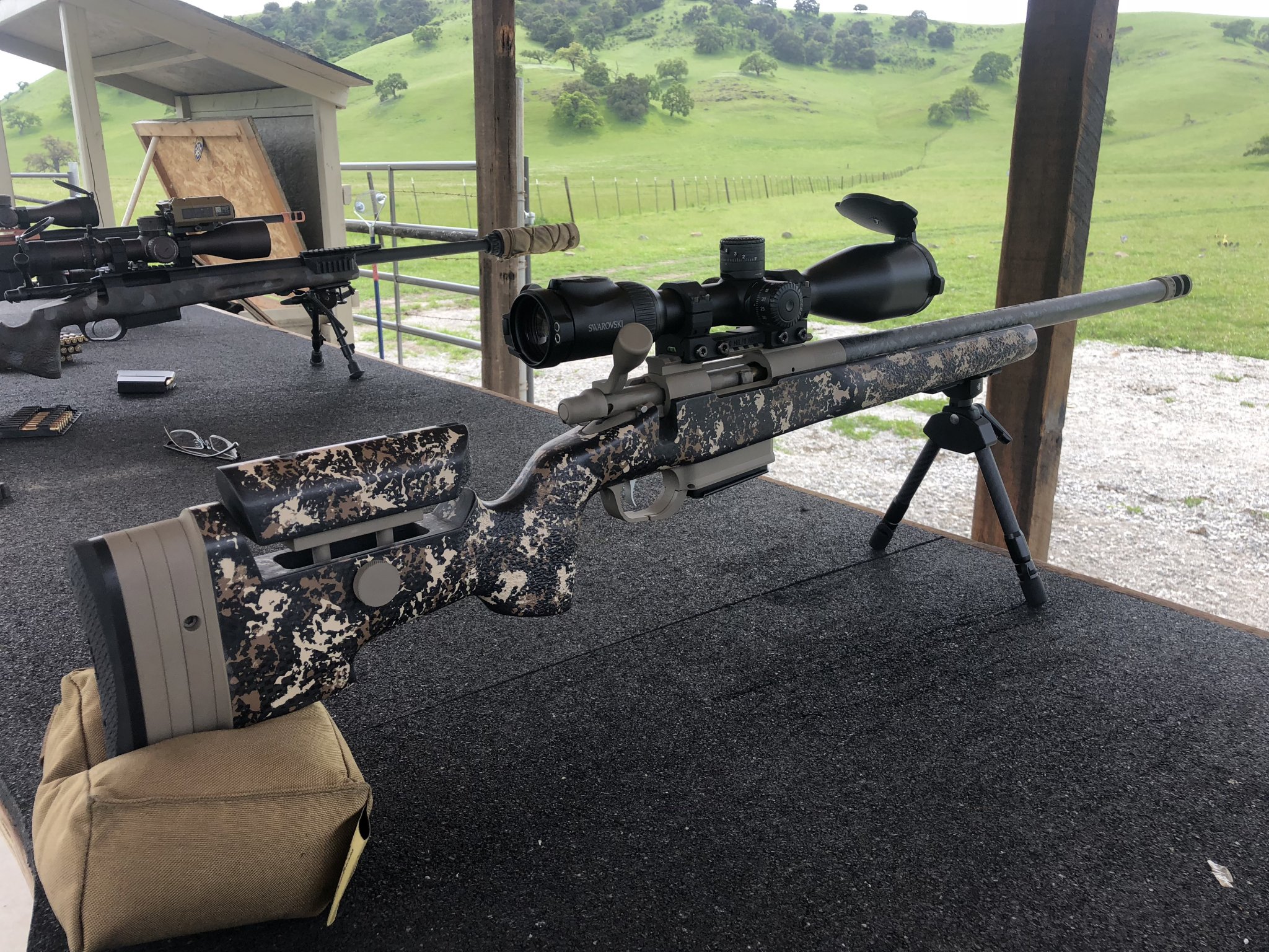

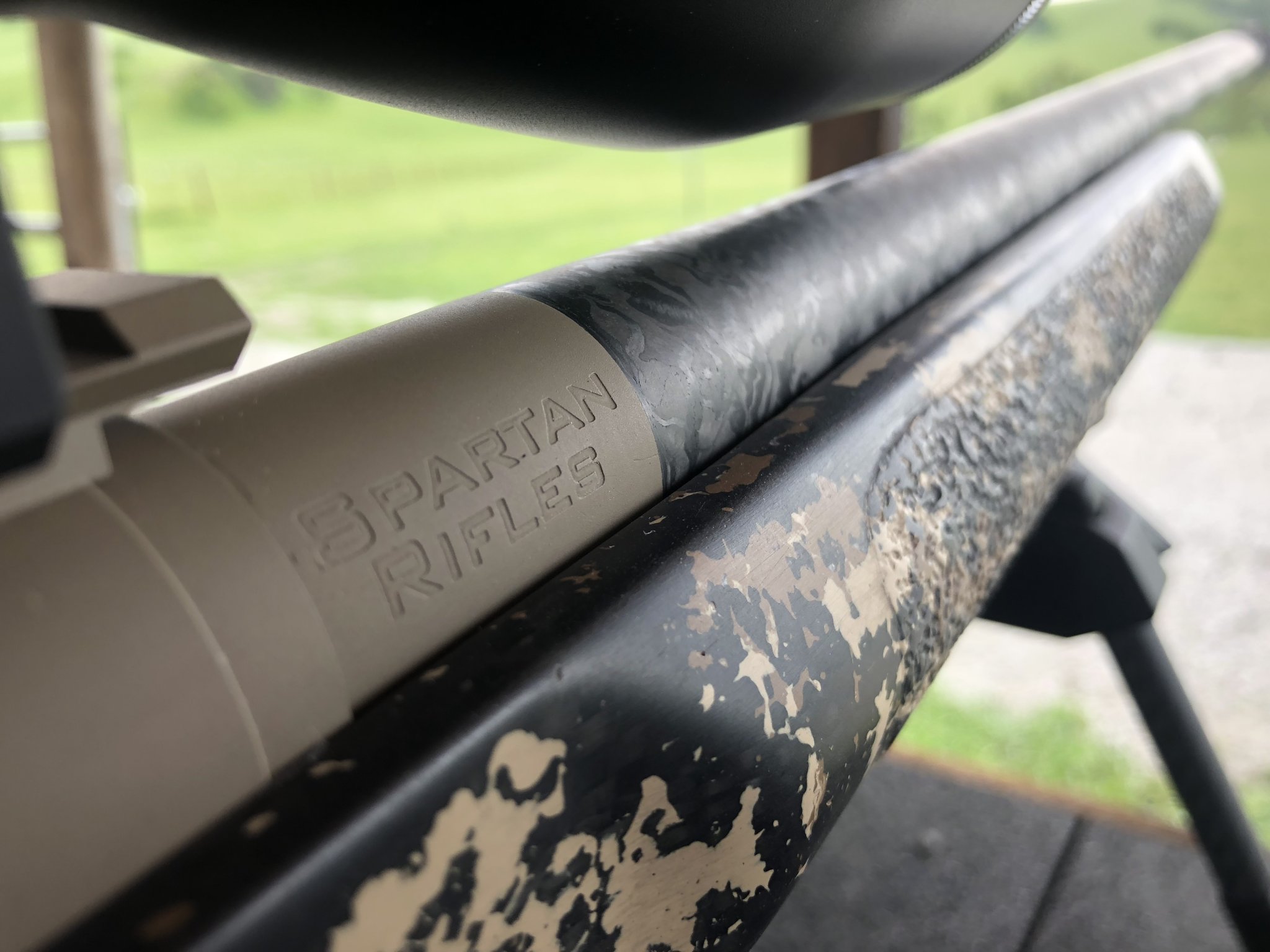

I’ve got a 24” Proof Sendero contour on my new 6.5CM and the weight saving is huge compared to my buddies steel barrelled version....
