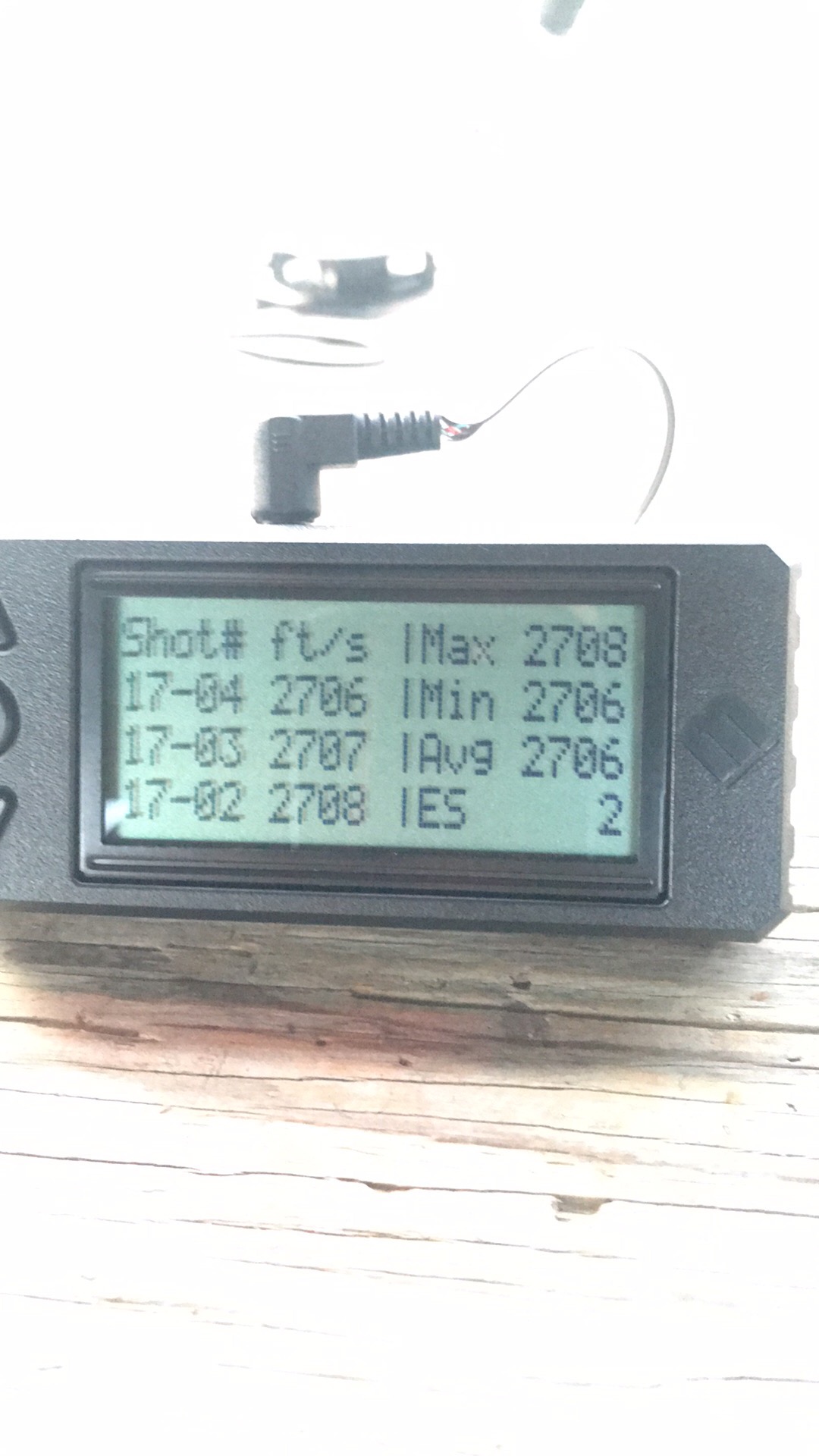

+1 for RL 16, I shoot between 100+ in AZ to 20’s in CO
That is truly superb temperature stability.
Curious how often you have to clean the barrel, any issues with carbon ring, any special cleaning regimen, what solvents you use, any loss of accuracy after x shots, etc.
If the carbon fouling could be easily controller, it would make for a superb 6.5CM powder.
I haven't noticed the dreaded carbon ring in any of my rifles, or should I say I haven't noticed any symptoms of a possible carbon ring. I typically shoot two matches a month, plus however many range trips, so I clean fairly regularly and I use KG1 which cuts through carbon very well

I clean every 100-200 rounds. I do get a carbon ring, but it cleans out with Bore Tech Carbon Remover, a nylon brush and short cleaning rod without much trouble. YMMV. For the rest of the barrel I just run 3 wet patches, followed by dry patches and repeat once. The Teslong borescope is great for checking for that carbon ring and seeing when it is cleaned up. The temp sensitivity shown in 4DOF for RL16 is .11 fps per degree. I haven’t based my cleaning frequency on any accuracy changes, just on convenience. I think if you stay ahead of the carbon buildup it is easier to deal with.... just my theory.
