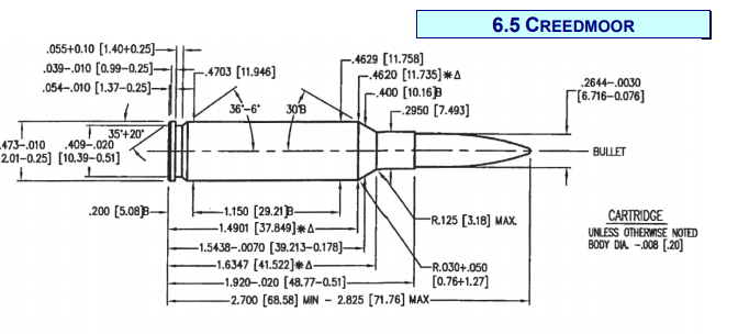

This shows them as 1.920-.02 so anywhere between 1.900 and 1.920 would be acceptable. You shouldnt have any issues loading the brass up as is based on your provided measurements.
