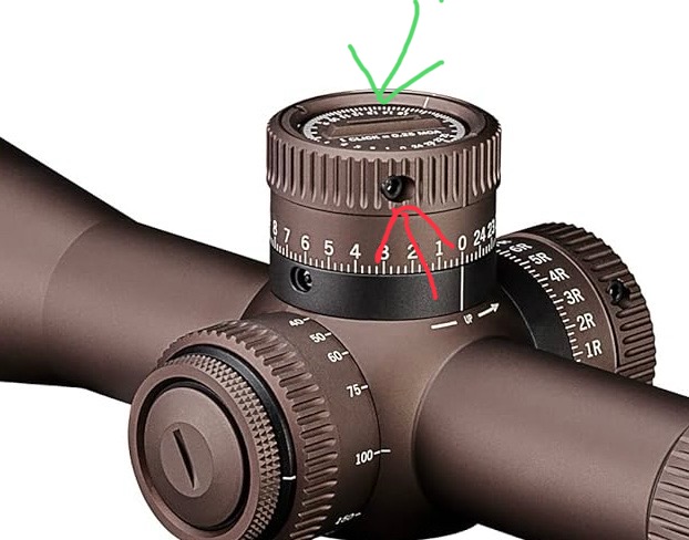

You said you are shooting higher and then said you are using hold overs to get to the zero. Did you mistake and mean hold under?
If you did, do you know how to zero a Razor III? You loosen the single Allen on the elevation knob(red arrow) with the knob at 0 and locked and then use the screw on the top(green arrow) to make the adjustments and get zeroed. Then you tighten the little Allen again. They give a little tool in the box for this. Windage is done the same way.
I’ve realized the errors of my ways and need to stop eating the lead paint chips. I’ve never had a scope this expensive in my hands before. But I realize now that I need to adjust using the top of the turret before using the micro adjust. Read the manual a few times before it sunk in completely.
Sorry yes I did mean hold under to get it on target.
Glad you got it figured out. Yes all the zeroing is done on the top of the turret. Once you are zeroed tighten the small Allen and then you use the turret to dial your elevation.
