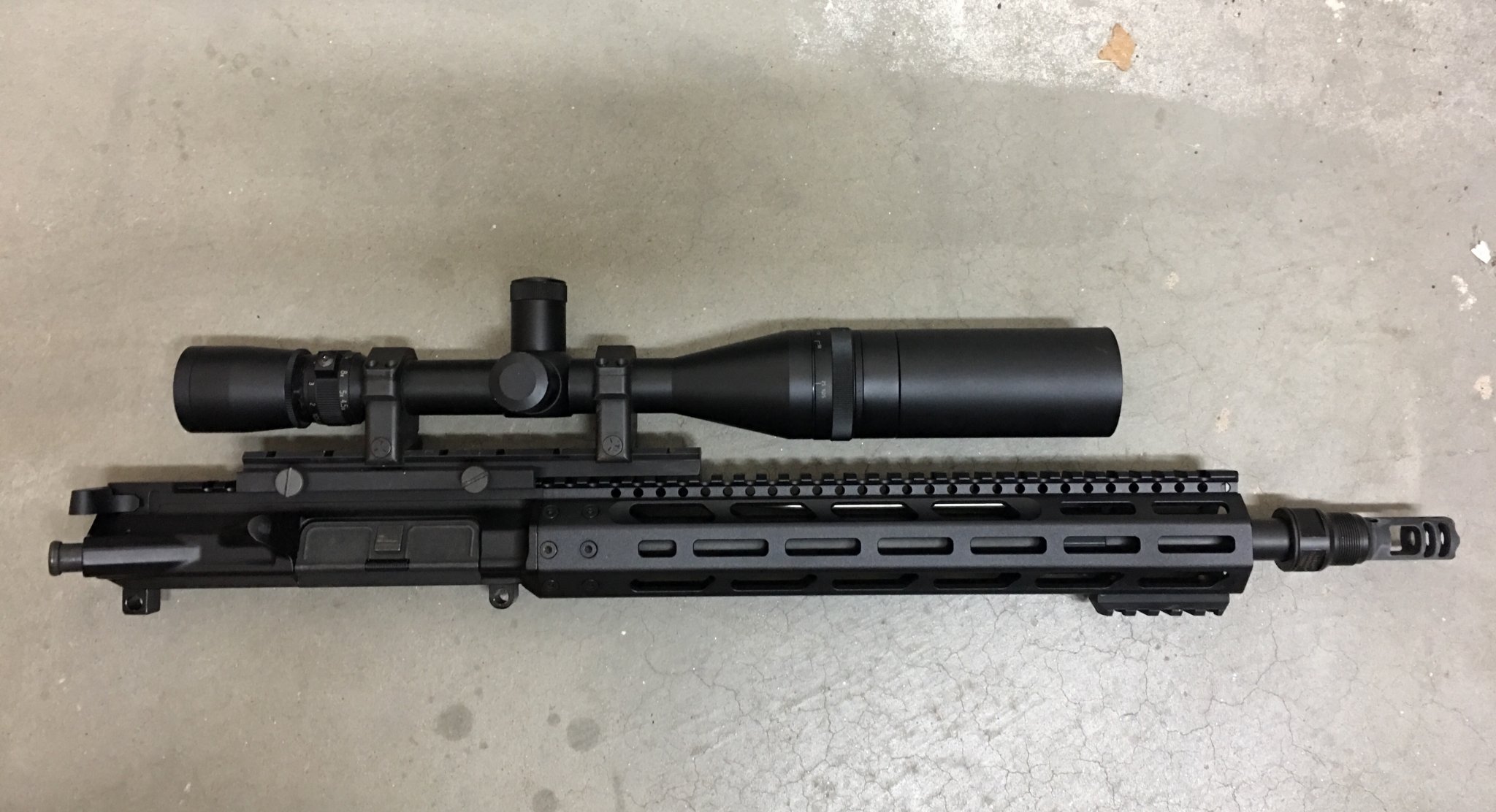

LaRue 18” barrel, cut to 14.5”, TranQuilo brake / suppressor mount pinned for 16”.
120s @ 2360
100 zero
200 meters is 1 mil
300 meters is 2 mil
400 meters is 3 mil
500 meters is 4.5 mil
Connect on 8” plate at all distances w/o touching knobs, just hold overs.
Old Leupold Vari-X III, 4.5-14x40 w/mil-dot.
No mods to barrel besides cutting to 14.5”
Picked up barrel a guy was selling from a UUK, found a Mega MKM upper, had an old CLE 20 MOA riser/rail, some 1” rings..I’ve been happy with results.
