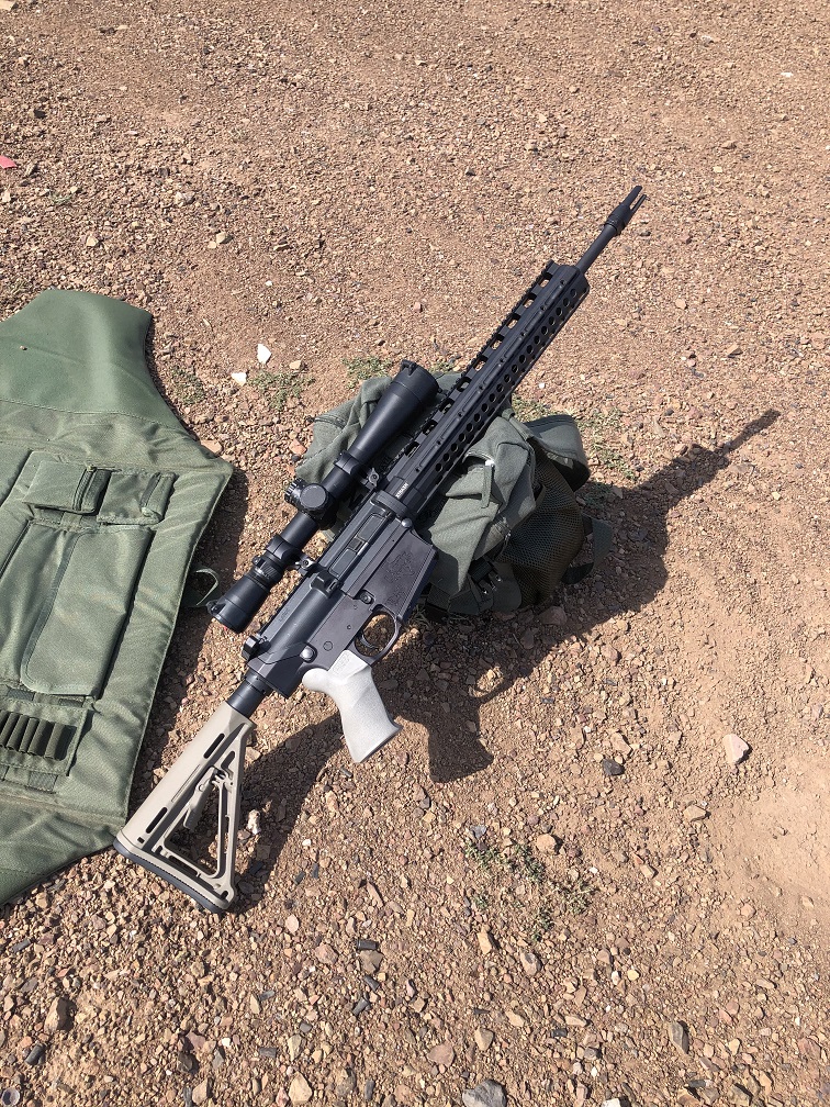

Need help with Larue PredatAR 308 Problems surpressed and Trigger question
Yall don't blow my ass up on this remember im not a AR expert here, but if i look into this grendel-type small frame. Am i going to still be dealing with function problems with the silencerco cans to mount to anything out of the normal or are the small frame guns that much more easier going on the gas side. Also anything like feeding issues etc. Im asking because i had to do some specific things for my daughter on her bolt gun as a Dasher to make it feed correctly, that was another one of those learning experiences

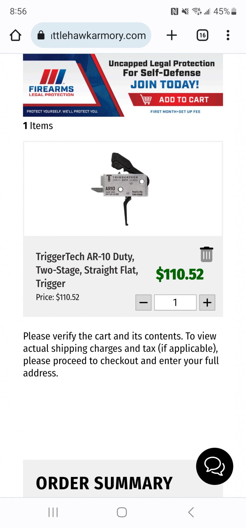

I have the Triggertech Diamond 1.5-4lb adjustable and for an AR which im not shooting precision with they are a very relatable feel because im used to a Jewel. Im not saying they are eqaul triggers, Im just saying this Larue factory trigger has a long pull travel then hits a clean break. Im just not used to it and prefer the triggertech feel.
Something else I'd take a hard look at if you don't mind a 3.5lb pull weight is the new Triggertech Duty triggers that come in single and two stage and is basically the same price as the MBT. The pull weight is not only a full pound less but it's just as clean as the more expensive Triggertech options, comparing the MBT to the TT Duty is no contest the TT Duty is better in every way.

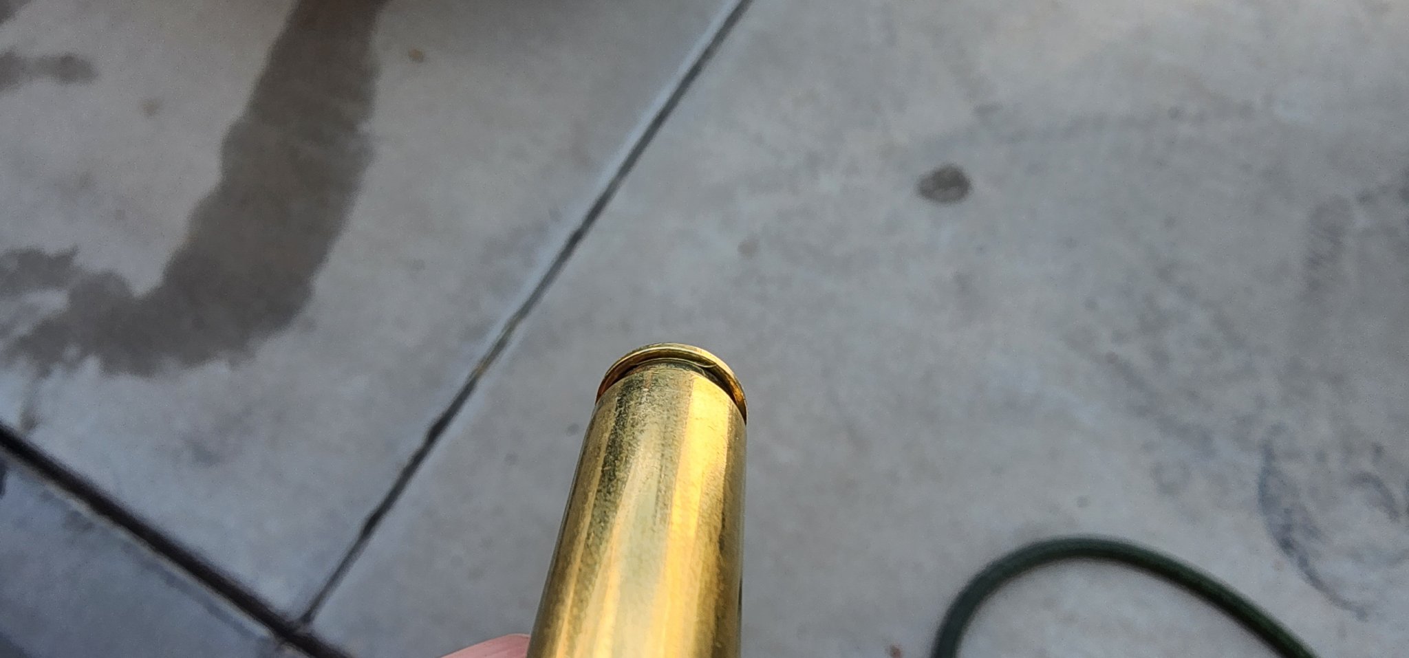

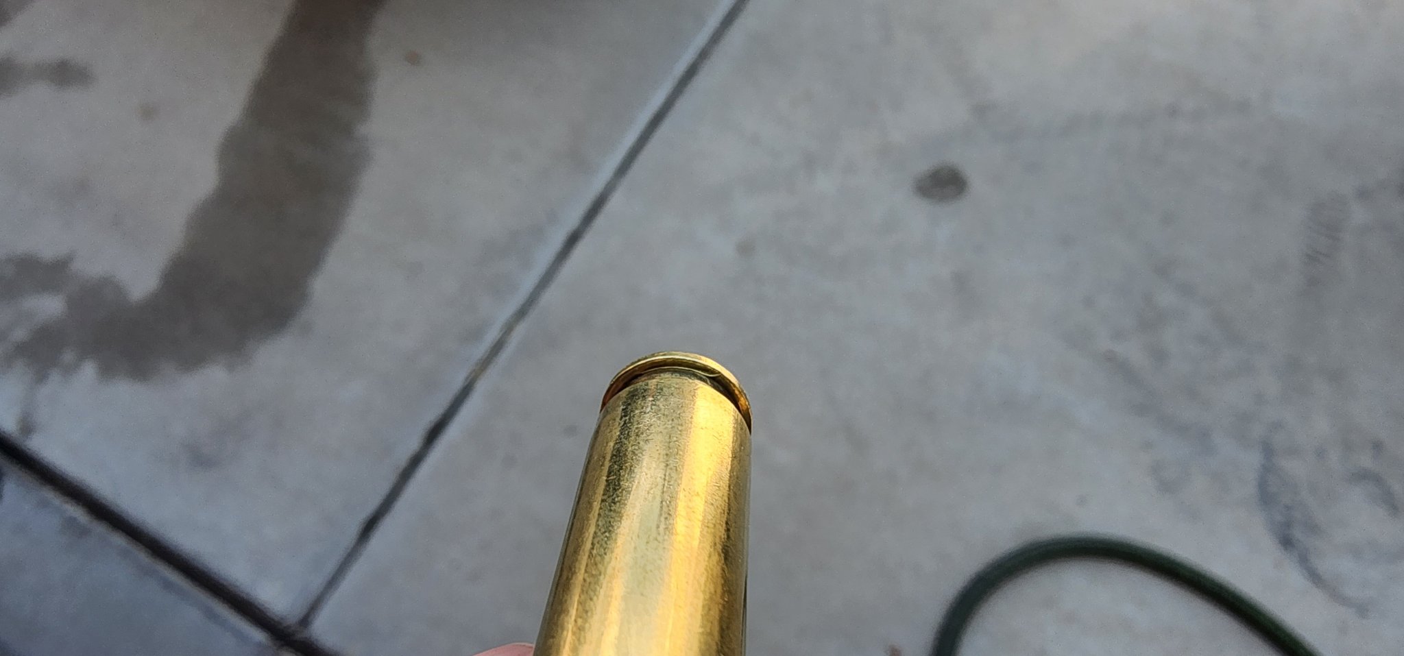

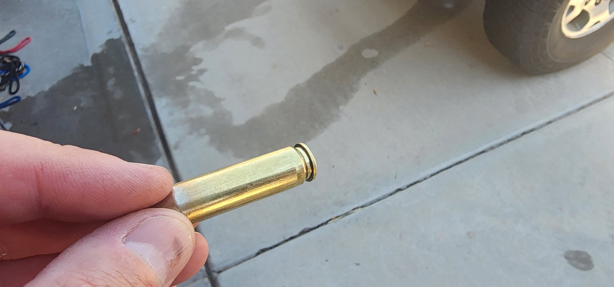

Second, What in the actual fuck are you going on about? how many times do I have to prove you wrong? How many examples do you need to prove that LaRue .308 barrels are shit and they have oversized chamber?
The OP himself confirmed it, I provided you several links that I found during a ten minute search! most of which came from your Troll Cave ARF.COM and like I stated above I have several LaRue. 308 Barrels in my spare parts/ junk pile that all have oversized chambers, you dont think I haven't sent them out to some of the best barrel smiths to verify this shit???
Now on to the next fucktard point you are trying to make.... you can't turn the gas off on a LaRue Rifle it's either a fixed gas block, or Surpressed and Unsurpassed?? And if you could turn the "Gas Off" the brass is still going to expand and fire form to the chamber the same as it would with the Gas on!?
You'd think for someone who owns "9" LaRue Rifles, they would know you can't shut the gas off..

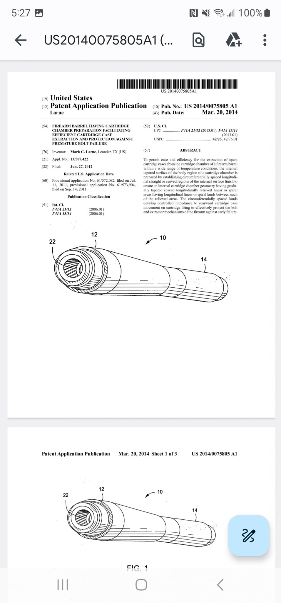

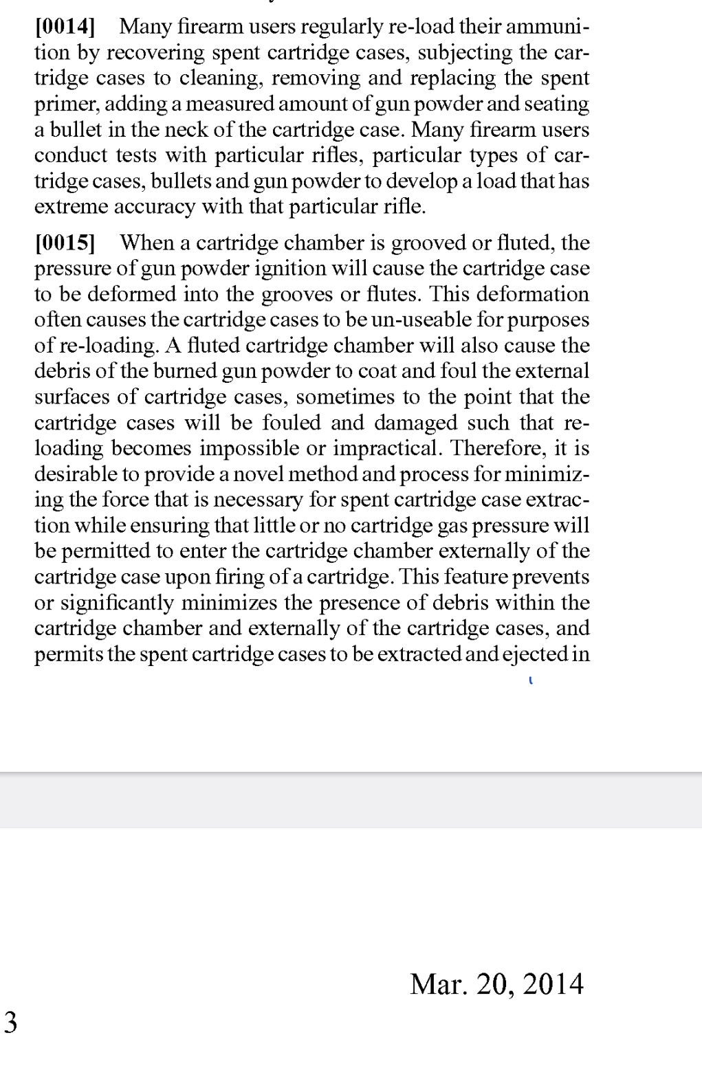

THIS IS LARUE PATENT FOR THE XTRAXN CHAMBER.. READ PARAGRAPH [0015]!!!
It fully discloses the issue, but at the very end he contradicts his above statement by saying is allows cases to be reloaded several times, well obviously that's not the case here is it???
What you're too fucking stupid to understand is that there has been several revisions to XTRAXN chambers over the years, some of the earlier versions do allow the brass to be used (Pre 2014!! As I've Stated several times in this thread..Oh look what year the Patent was submitted 2014!)
Now please prove me wrong and tell us all about this "cause and effect" that is resulting in the fire formed .308 brass being unusable that isn't associated with the chamber???
At the end of the day it's the LaRue Barrel that "causes" the .308 brass to be worthless, because after I unfuck a LaRue rifle by installing a Custom Bartlein Barrel I no longer have issues resizing my brass!

But if you read the patent, specifically subsection 0015, it states that the XTRAXN chamber fluting deforms cases to the point where they are nearly “unusable” for the purposes of reloading.

I’m hesitant to wade into this dumpster fire, but the patent doesn’t say what people are saying it does. Specifically to paragraph 0015, yes it does state that fluted chambers typically cause the brass to be unusable for reloading, but goes on to state “this feature [the subject of the patent]… permits the spent cartridge cases to be extracted and ejected in a clean condition so that it may be reloaded many times if desired.”

Except that the patent paragraph 0015 is not- necessarily- contradictory. It is saying that, in general, grooved chambers trash brass but the Xtran grooved chamber does not. Nor does the Xtran chamber dirty the brass to the same extent of a typical grooved chamber because it does NOT direct gas and debris into the chamber. This is my interpretation of the paragraph in question, based on a plain reading of the text. Maybe the claims of the patent are overblown- or a total crock. Maybe every Larue barrel you ever bought is a lemon. IDK, but the patent claims the Xtran chamber is supposed to keep the brass clean, while easy to extract in adverse conditions, and reloadable.

So I’m running the Seekins builders kit, JP bolt with the proof 6.5 creed barrel now. I was thinking up grading to another 6.5 creed. This thing has a kind weird profile.

Thanks for admitting and confirming that Larue barrels are faulty and damage the fire formed brass rendering them useless.
And If you're trying to insinuate the issue with the brass is caused my premature extraction damaging the Case Head you're wrong again!!. Damage to the Case Head isn't the issue, the issue is the chamber! (as outlined in the patent) Thats why when resizing the fireformed .308 brass with the oversized CASE BODY jams in the FL sizing Die just below the the shoulder.
You're also admitting that the soul purpose of the XTRAXN which is to decrease the surface area inside the chamber Under Pressure allowing for easier extraction by allowing gas and debris to escape is Bullshit as well.
Go the fuck back to the pathetic meaningless hole you crawled out of with the little circle jerk of LaRue Fanboys on ARF.COM, no one here gives a shit about you or LaRue on here.
My God you are an idiot. There is no game, just you showing how stupid you are. Looks like you need to update that signature bitchboy. You have verbal diarrhea.
Now you are telling me what I'm admitting, wild. Funny thing about guys like you, you always tell on yourself.
What metrology methods and tools did you use to determine your scientific findings that the brass issue was or was not due to one specific factor? I'll wait while you have this explained to you by someone with a brain.
You are clinging to verbiage in a patent that may or may not be explaining what is going on.
Damage to a case head happens, and this is a factor of several forces acting on the brass at the same time. You aren't able to explain this are you, thus you need to update your signature line bitchboy. The damage to the case head isn't the problem, the brass changing size is, correct? Can there possibly be another reason it's changing size, the case head issue is a tell tail sign...hint.

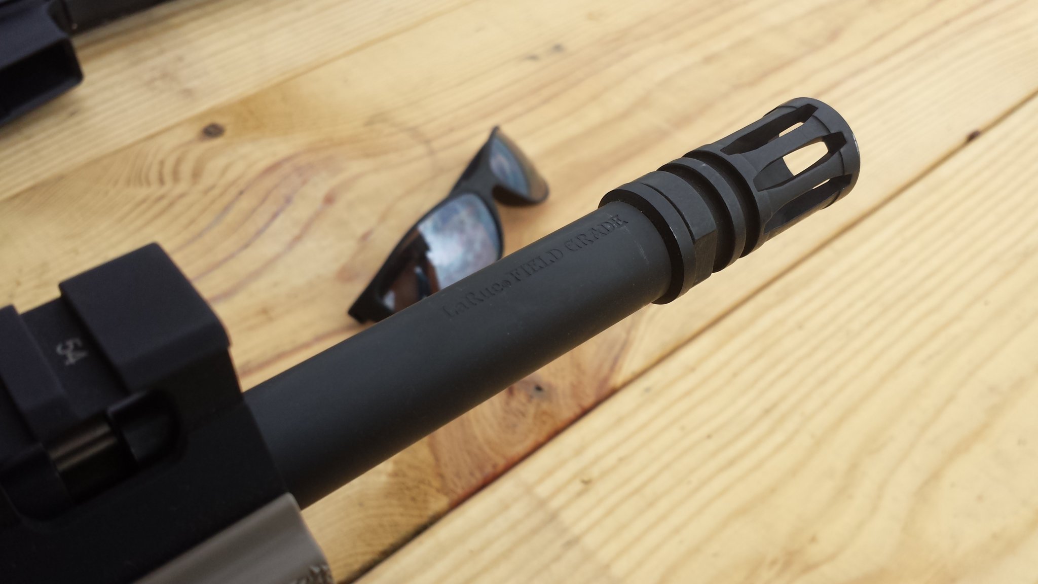

So are your barrels pre-2014? If you put a couple of pics of your rifles up, I’m sure we could tell.
My barrels are in house larue barrels made post 14. I do have one 14.5 308 barrel I'm not considering, it was an early production with xtraxn. But it acts the same as the rest do, including field grade.
There is a very simple and specific time that this issue with brass happens. I also notice that no rifle configuration info has been shared nor any shooting conditions. Just that the chambers are horrid.
I'd love to get my hands on all these larue barrels laying around with bad chambers so I could shoot them and see if I can size a piece of brass.
ETA: Does this help?

I am also shooting a 260, I reload everything. I will give you another hint. Some of my brass sizes hard, but I know why, and it isn't the chamber.
You can figure it out, I just don't think you want to be wrong.
