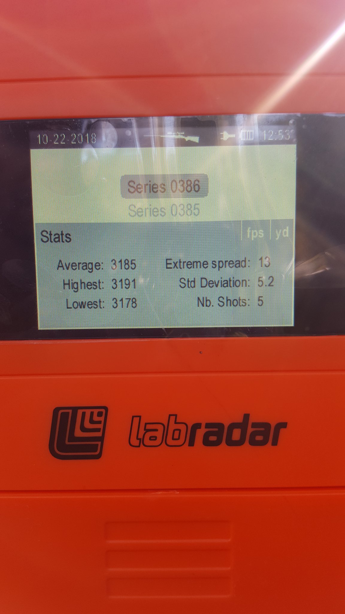

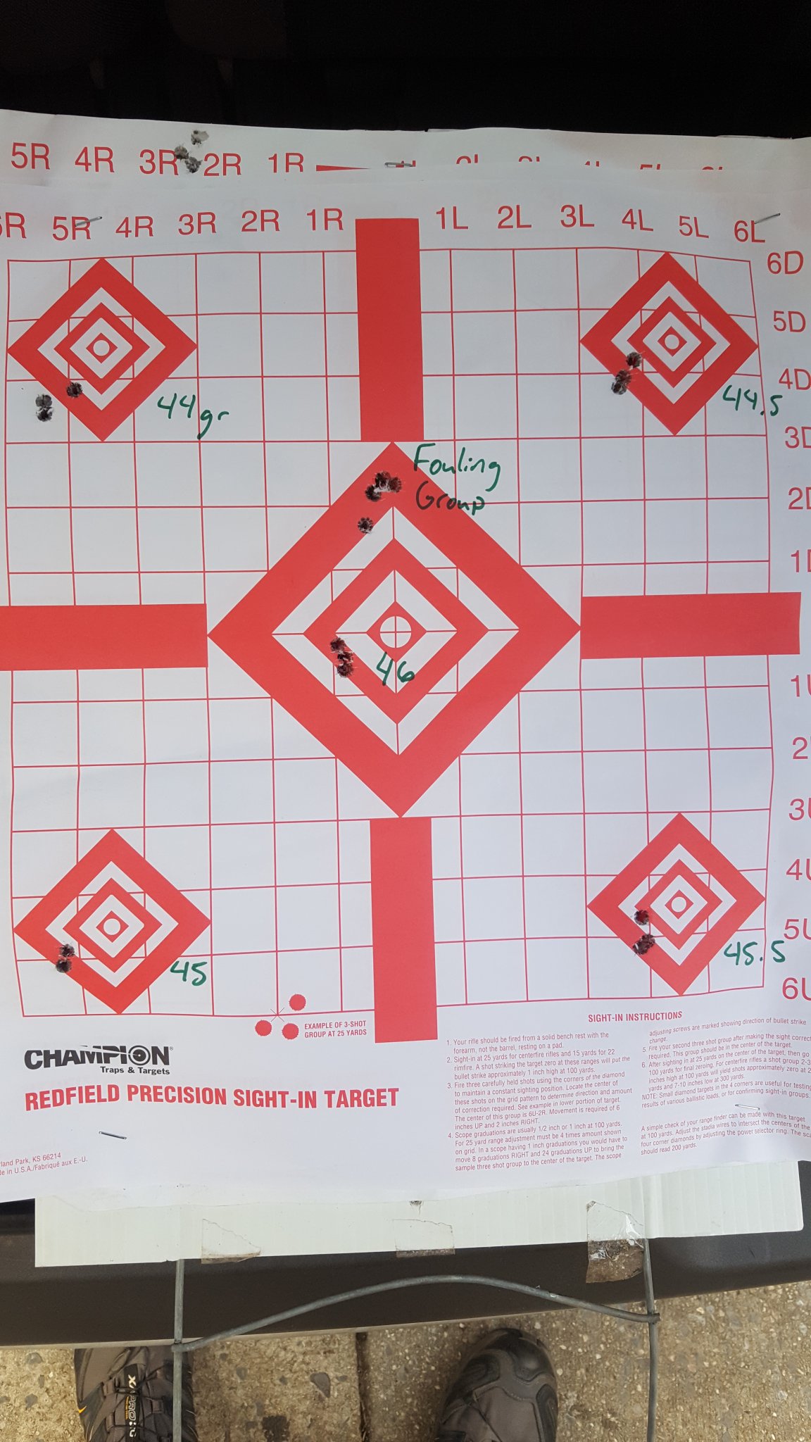

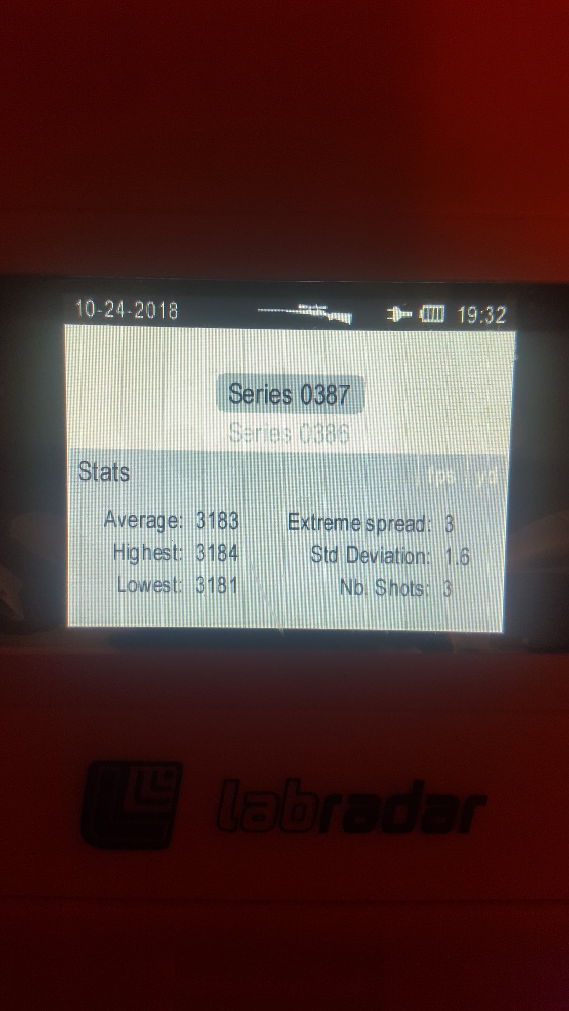

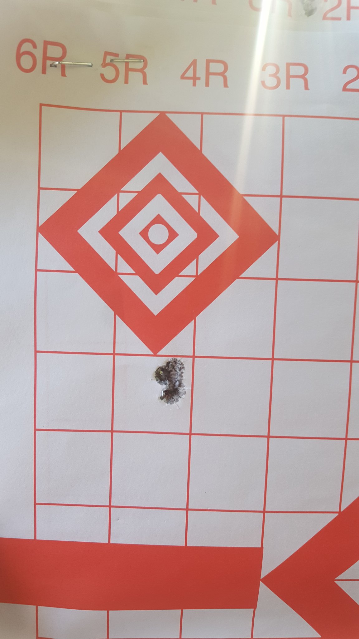

So I bought some of these out of curiosity. I just guessimated around my 130gr Hybrid load and started with touching the lands. Warning* Don't assume that these loads are safe for your rifle.
Pressure test:
View attachment 6960622View attachment 6960623
45grs at around 3100fps showed a lot of promise but I didn't get any pressure signs from any of the loads. So I came back out the next day with just 5 shots of 46.5grs and got this result:
I was pretty damn happy with that but wondered if it was a fluke. So I loaded up 3 more rounds of the same and came out the next day and shot this:
View attachment 6960632View attachment 6960628
Needless to say they seem to be very accurate. Especially when you notice that during the pressure test that the POI of 44.5-46grs would make around 1" group. I'm impressed so far.

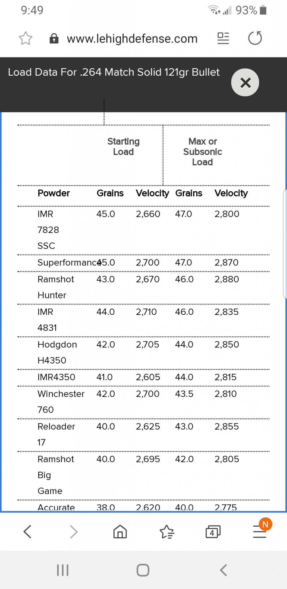

That's at 2.8", if someone is loading a lot longer than 46 grains is possible. How many people go over recommended loads because they are usually conservative. If loaded 3" like one person was talking, that is probably very possible but hey, you are the fucking expert that can't even call out the right person ?‍♂️

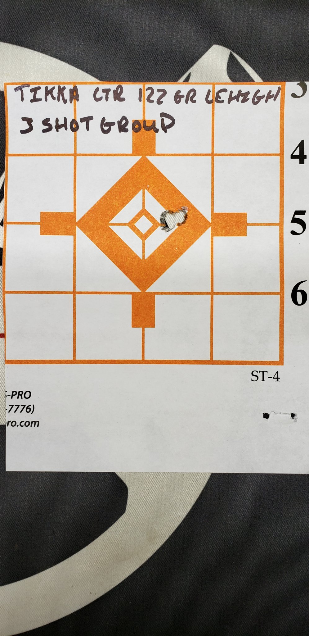

Curious if anyone is trying the 121 match solids out of a 260 rem. I'm getting decent results with 40.2 gr. of RL 15 and a COAL of 3.77" out of my CTR
Here's what I settled in at:
Tikka T3 CTR 24" 6.5 Creedmoor
Norma brass
WLR Primers
44.5 gr Of H4350
122gr Lehigh controlled chaos
Averaging 2979 fps
(coal 2.925) (B.T.O. 2.240)
I dropped a smaller buck this year at 437yds. I put it right in the "crease" and he was DRT.
Overall I'm happy with the bullet. The only drawback I see is they don't buck the wind as well as an ELD-X/ELD-M. But they are consistent, as long as I adhere to my dope for wind they hit where they are supposed to.
Pressure test:
