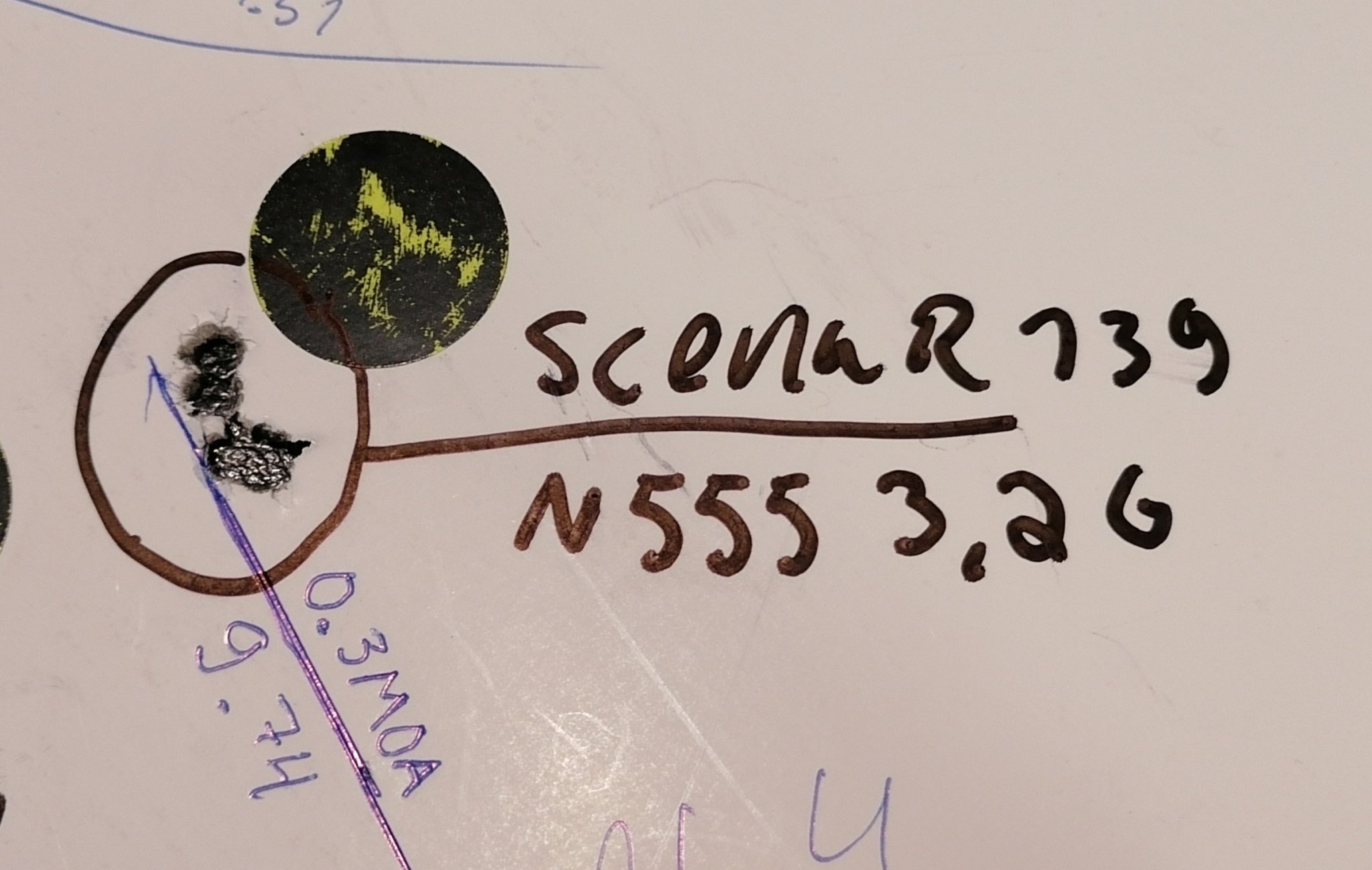

I have now some L-Scenar 136gr ammo made with close of the powder on Vihtavuori for a A-Tip 135gr.
Also did a test group of 139gr with N555.
I have never loaded ammo with so SLOW powder as im doing now.
I think i need to change my mind on the powder´s.
Normally i have used N120 up to N150.
So we are moving in to a totally different level now.
Thanks guys.
139gr Lapua Scenar.
Vihtavuori N555 3,2g, it´s about 46,3gr.
5-shot´s at 100-meters.

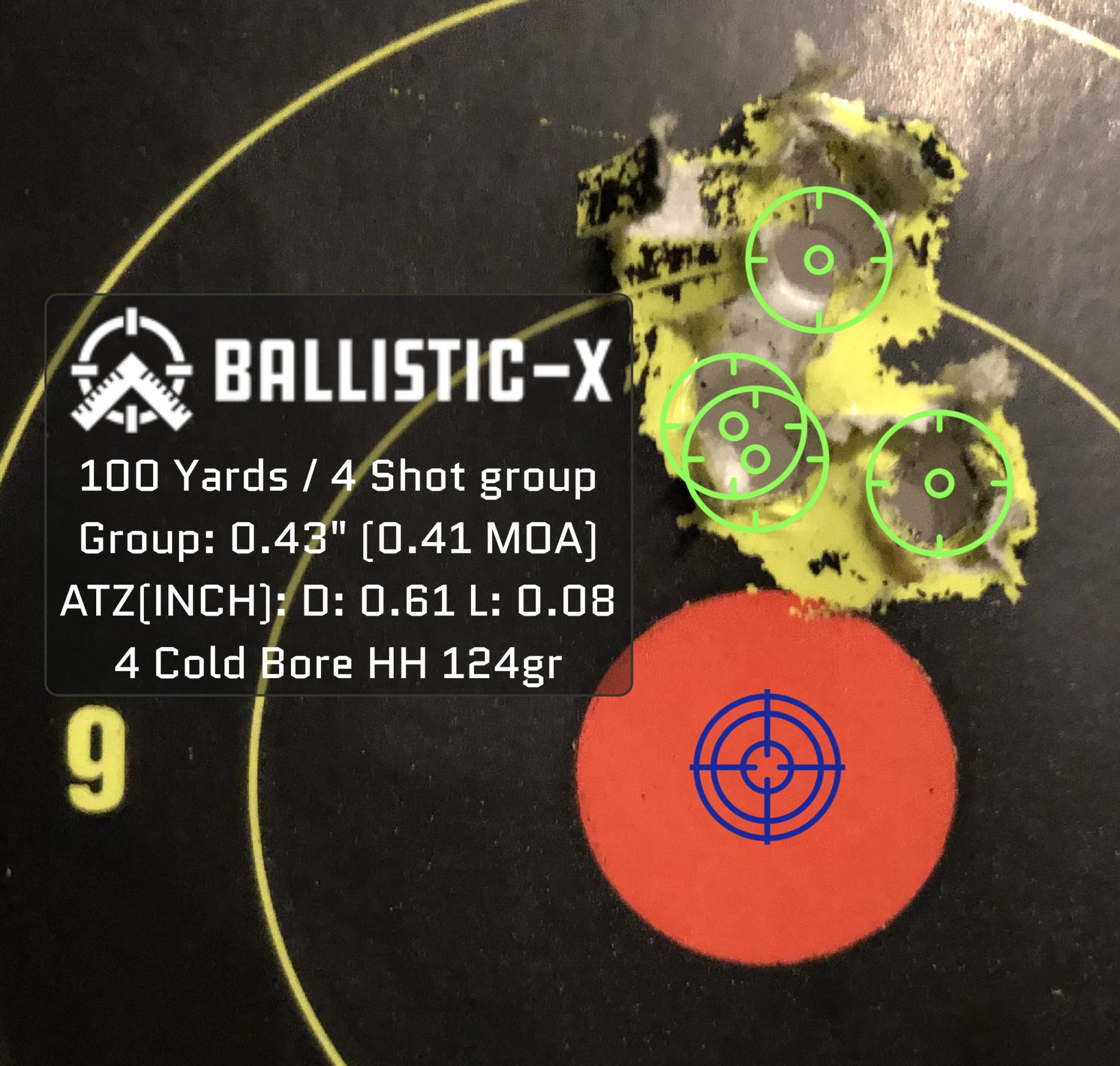

I’ve had good success with Hunter Hammer 124gr solids with N565 in a 24” Proof barrel. Running close to 3100fps in a short action.
These were four cold bore shots which stacked up pretty good:
Shouldn’t you be able to run quite a bit faster with the 124g Hammers in a 6.5PRC? I am starting to develop a load with those same bullets and am hoping to get 3500FPS. Every other Hammer bullet I’ve used has easily allowed me to run 150-200FPS over book max. I can’t argue with your accuracy, but for hunting I’d want a little more energy.

I probably could push for more, but was starting to see some pressure signs on ADG brass, so stepped back to this load. I am using a GAP chamber in a short action.
