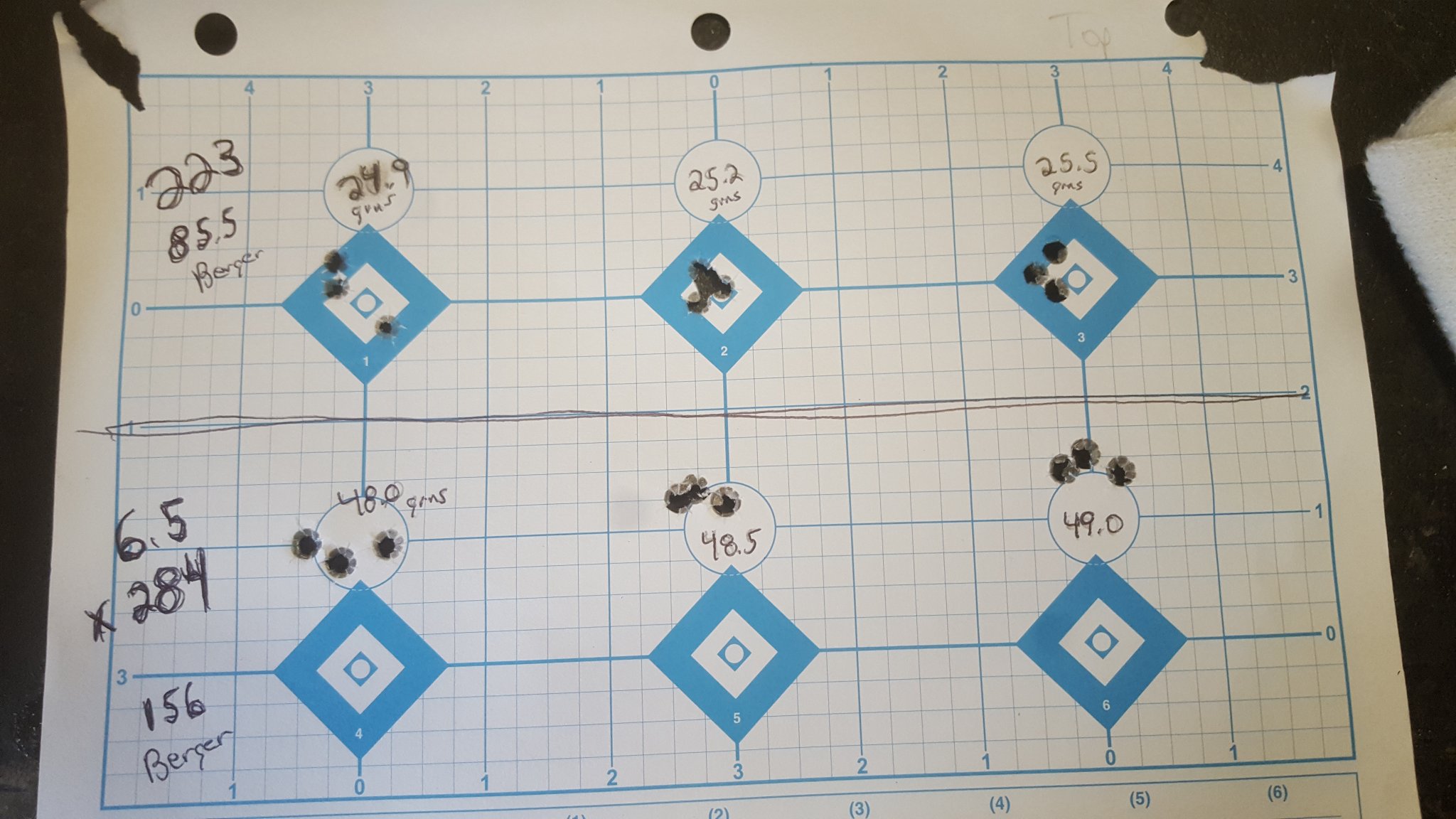

    Did some initial testing to see how the new 156 berger would do in my 6.5x284 . I am VERY pleased .
    with reloader 17
    48grns averaged 2897 fps
    48.5. averaged 2934 fps
    49. averaged 2960 fps
    No pressure signs at all. I'm not sure how much faster you can take this.
    with the bc it should do very well.
    rifle is trued 700 action in mcree chassis
    28 in brux 1-8 twist heavy varmint contour
    lapua brass
    cci benchrest primers
    156 berger elite hunter bullets
    bullet seated 15 ths off the lands
    When I get my new 300 PRC done, I'm considering taking my existing 300 PRC and rechambering it in 6.5-284, specifically for the Berger 156. Those velocities are right in the area I'm looking to get. Thanks for posting!
    I'm 15ths off the lands
    I did do some more testing with higher powder charge with very good results , there is a large node that continues well above the 49 grns . I will post some of the info when I get a chance.
    so I went a little higher on the charge and here is what I got.
    48.5 avg. 2925. 6.4 sd
    9fps diff from prior testing
    (15 deg colder than previous testing)
    48.8 avg. 2942. 10 sd
    49.1 avg. 2954. 10.6 sd
    49.4 avg. 2980. 10.6 sd
    49.7 avg. 2983. 1.4. sd
    49.9 avg. 3013. 5.2 sd
    all groups were around 3/8 moa or smaller
    49.1 thru 49.7 were cloverleaf groups.
    I'm going to go with 49.4 and test at longer range.
    will edit first post to give more details on the rifle.

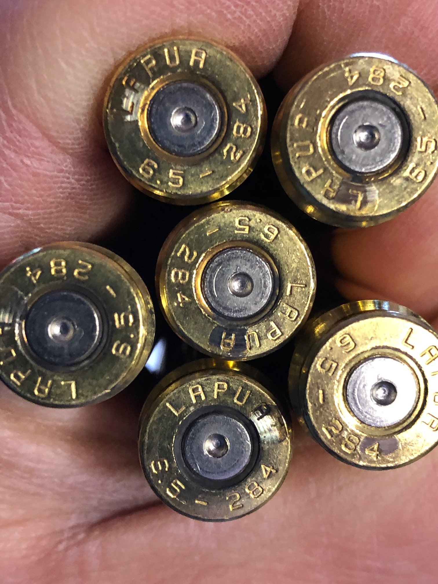

    Here is my experience with 6.5x284, 156 Bergers and trying to find max charge with RL26:
    *Round 1
    Called Berger and got starting and max loads for RL26 - 49.0-53.8 GN
    New Lapua Brass
    GM210M
    RL26
    Ladder test from 51.5 - 53.5 in .2 gn increments
    Magnetospeed Velocity Range 2810-2945
    I was still waiting on my modified case so I loaded round 1 at SAAMI OAL = 3.228"
    Started seeing ejector print at 52.5 grains just a hint of heavier bolt lift at 53.5. Finally got a modified case in the mail and checked OAL. In my Cooper M52 with 156's max length is 3.224" or .004" shorter than SAAMI. I thought being .004" jammed was causing my pressure signs so I ran another ladder test.
    *Round 2
    Only thing different this round was loaded length -.010 off lands.
    Ladder test 51.5 - 53.5
    Same pressure result as round 1. So I thought using 1x fired brass would eliminate pressure signs. 1x fired brass grew .007 base to datum.
    *Round 3
    1x fired brass with -.002 shoulder bump
    GM210M (primer pockets were looser than new brass but still held tight)
    RL26
    Ladder test 51.5 - 53.5 still had pressure signs around 53.0 with the 1x fired brass.
    *Round 4
    To me, it looks like anything 52 gn or above is not safe in my rifle. I'm going to load some batches around 51.5 and see if I can find something this gun likes without having pressure signs.
    Will try to get this done over the weekend.
    Here's a pic of the worst pieces of brass.
