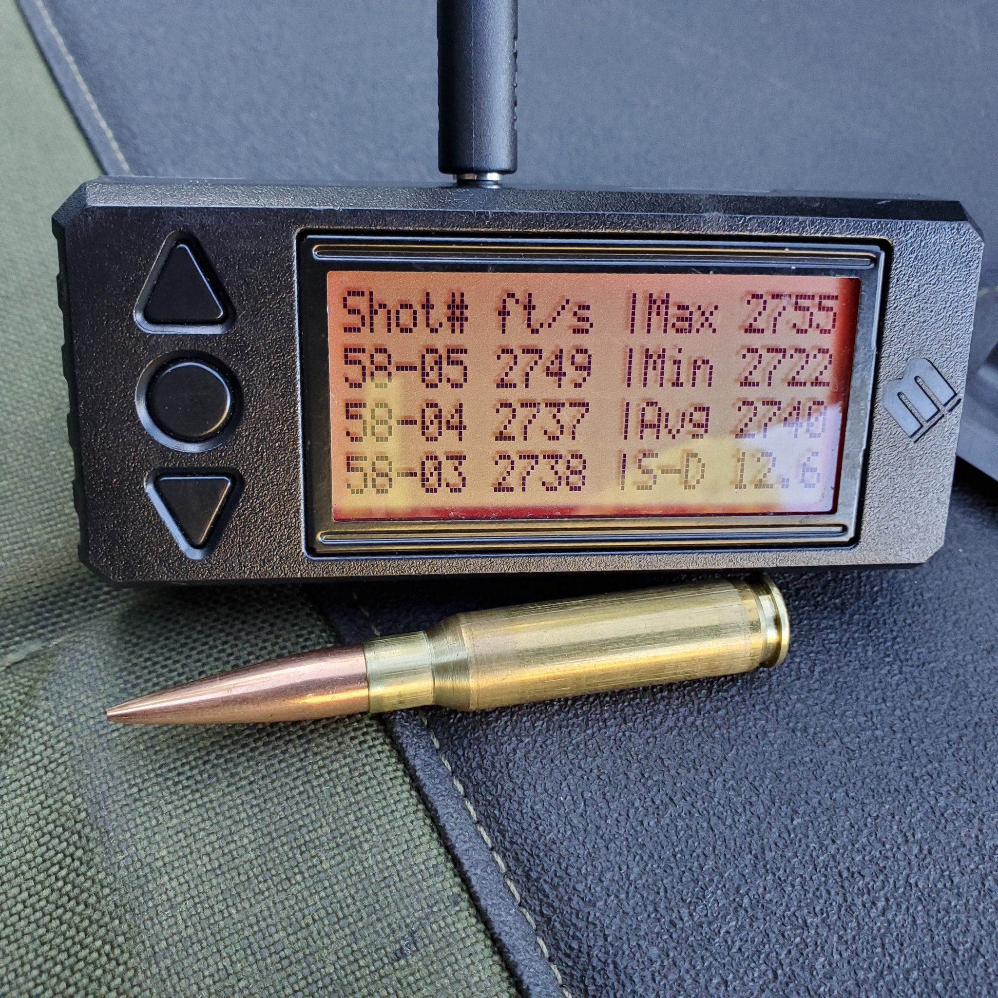

I'm shooting 225 eldm at 2676 fps out of a 30" 308 Win...but today in the cold weather I was pushing the 300 Win Mag just for fun... got the 200 SMK to 3280 fps thought it would be about 3200 and a hot load...but it was almost 3300 fps it was marked so as to shoot it last. Bolt lift was noticeably stiff, brass intact, with a flat primer...this is not a shootable load. But 3200 might be...ran some 230s at 2962 fps as a usable load, in the 300 Win Mag. I have a 300 RUM that feeds 4.020" cartridges, but the old 300 Win Mag us still a good round. Haven't felt the need for the 300 PRC, and felt a 300 Norma Mag would be the best compromise, especially in the improved version... but I'd probably stick with the standard case. Don't shoot much LR way past 1000yds these days, as I did alot of 1400 yd shooting with the 308 Win...so the 308 Win or 6 Dasher, or even the 6.5 CM covers most of my needs with less powder...and I can always go to the 50BMG if I want to burn alot of powder...always experimenting, on what is possible...but even reloading is getting ridiculously expensive just orderd $800 worth of powder, to get 16 lbs... on sale. Seeing $70 per lb, and very limited to out of supply. Is there such a thing as another usless cartridge? Manufacturers keep introducing new cartridges, or you can build a wildcat, one of a kind. I guess if you enjoy it, it's not usless...to you...but many have little improvement over already established cartridges...most could be categorized marketing hype...better than anything on the market, with secret ingredients, and special sauce.

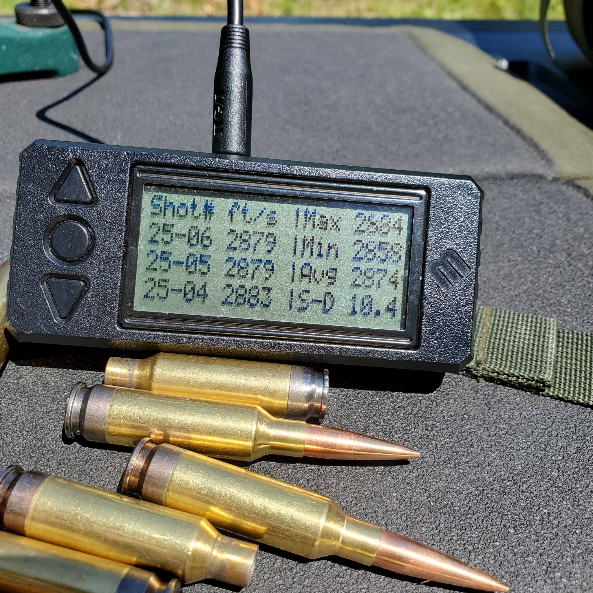

Accuracy out to 600 yards has so far been stellar with the 215 Berger at 2725 fps and on a braked, 15lb rifle the recoil is very mild. I'm thinking another 100 fps or a 225 ELD at 2700 would be ideal, and given the powder charges I've been using I don't see it happening with the WSM. Of course there will be plenty of people that start screaming that a 300 Win or 300 PRC will do what you want, no problem. And they are absolutely correct, but at the expense of more powder, more recoil and less barrel life, and most likely less efficient because of a lower powder charge in a larger volume case. Or maybe I'm just splitting hairs and need to tell myself the last thing we need is another new cartridge that doesn't do anything different than cartridges that are currently available.

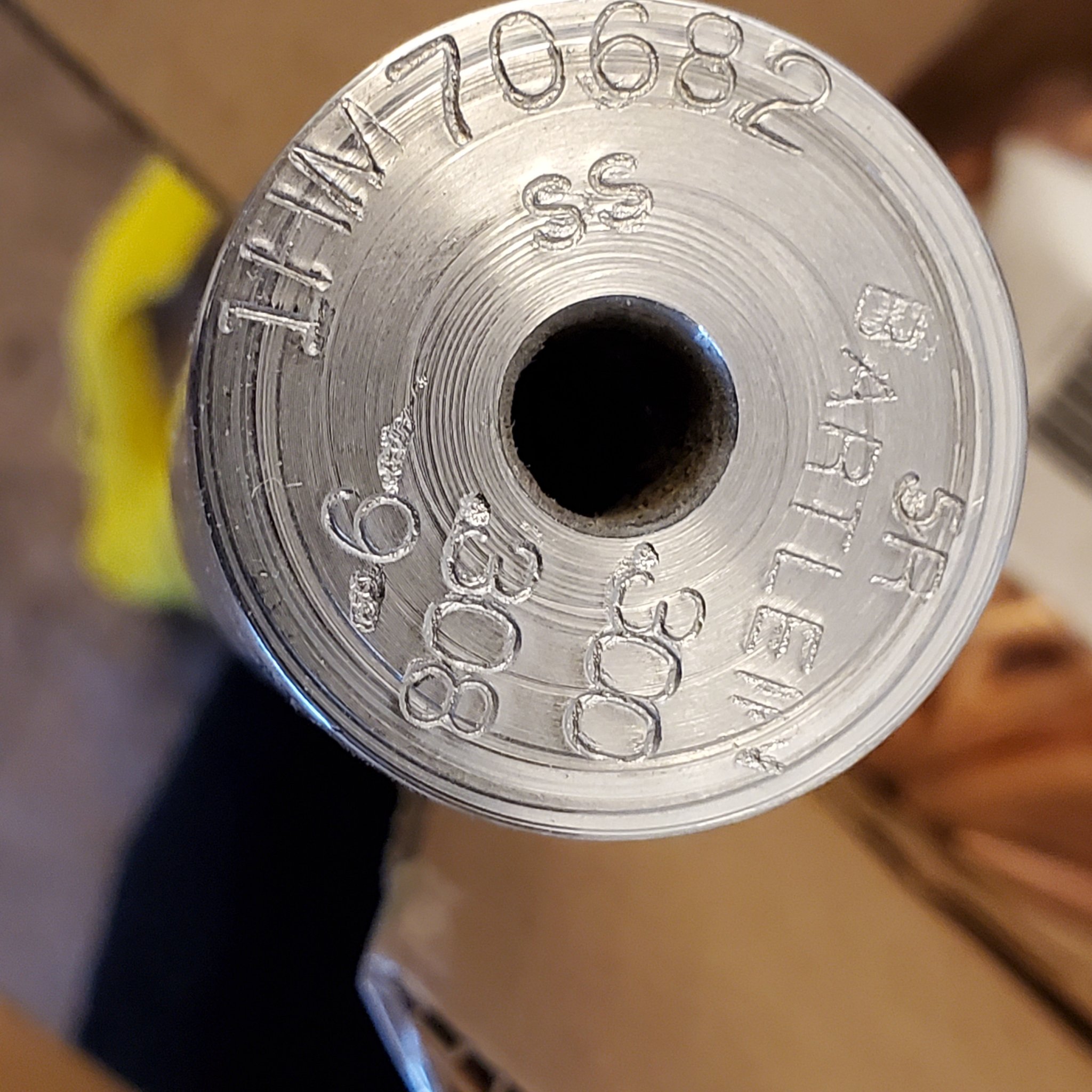

I did all the chambering, & truing myself with used rifle parts I had laying around for $600. I trued Rem 700 action, then chambered for 308 Win a new, cut to 22", 9 twist, shoots 200 gr SMK .715 BC at 2740 fps and 230 SMK .8 BC at 2550 fps, added detachable bottom metal center feed for longer OAL cartridges. Bolt knob milled off and tactical bolt knob installed along with a muzzle brake. It weighs 7.5 lbs with out a scope. Installed a 3- 15X PST. And for normal deer hunting 155 Lapua at 3100 fps. For a easily portable, 22" barreled, shootable, carry rifle capable of reaching out, with Lapua or cheap LC brass, available everywhere. Plus the hybrid case option for a little extra performance, borrowed from the 277 Fury hybrid case. Not your average 308 but just a 308. I own the reamer and throating reamer so it's just a day in the shop for me, to do all of it. No problem for any decent gunsmith.... and it will go many thousands of rds before barrel replacement.

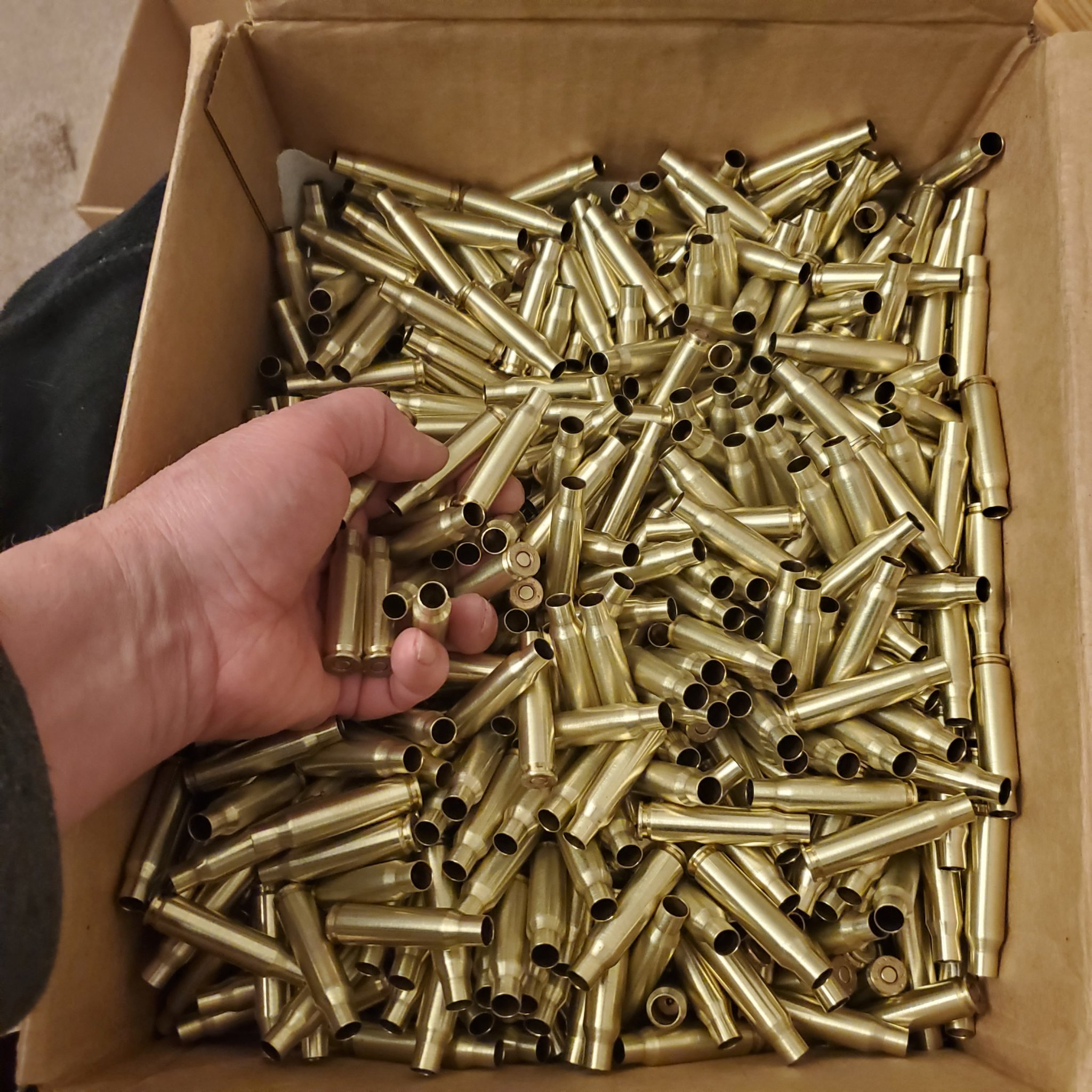

How do you size fired cases? Do your dies run into the steel base?
The hybrid Stainless Steel case head is slightly undersize in my dies, but after 4 firings of high pressure loads, they expand enough to barley touch, so regular sizing dies work fine in 308 Win, 6.5 CM, and 358 Win is where I have used them. They also have slightly more water capacity to add a bit more powder. And in 230 gr SMK they grouped tighter than Lapua LR cases, with Lapua Palma being the worst, in grouping & largest SD, and lower velocities. But they work well in other applications, and after firing hundreds of them, I have come to believe, for me, the Lapua LR primers cases, to be better. I still have hundreds of new Lapua SR cases but will buy no more, in 308 & 6.5 CM.
LC cases worked well too...but smaller capacity, and thicker neck thickness, similar to Lapua.
