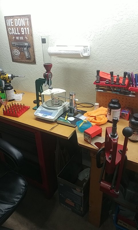

I´m in love with my 6.5 Creedmoor. I use a 26" Bartlein and load nosler brass with 43gr of RL-17 and this is how it shoots. SD goes a little high on very hot days, but normally stays around 10
