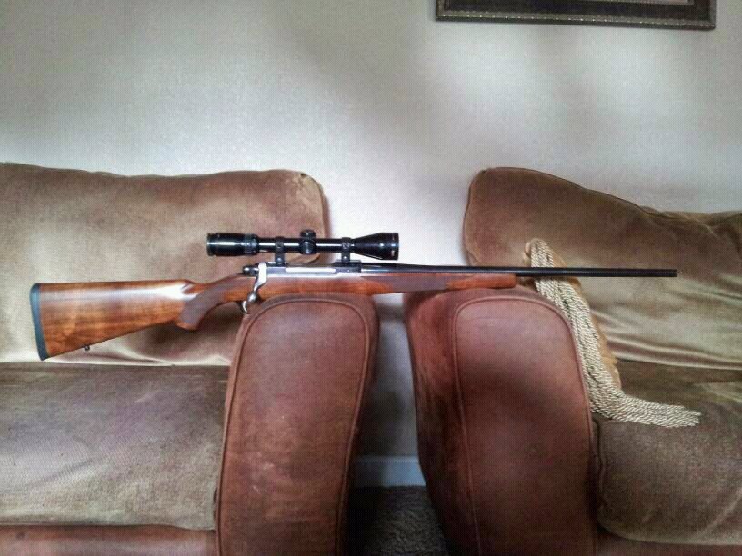

This is my Ruger M77 MkII 6.5x55mm. Given to me by a friends widow. Haven't been able to touch it for 4 years after he died. 2 months ago pulled it out. And I loaded up 50 rounds of 140 gr bthp over 40gr h414. 1 inch groups. His brother was there. He has a m96.
This is my first post here. This forum is awesome.
accuracy is everything
