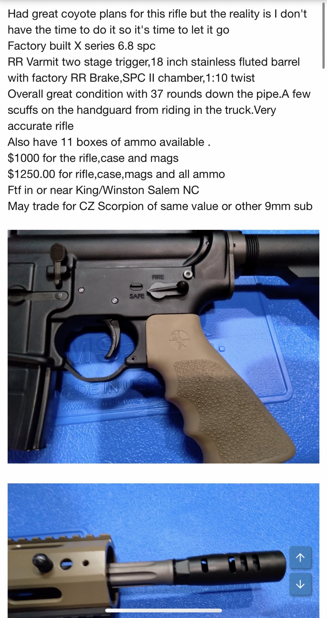

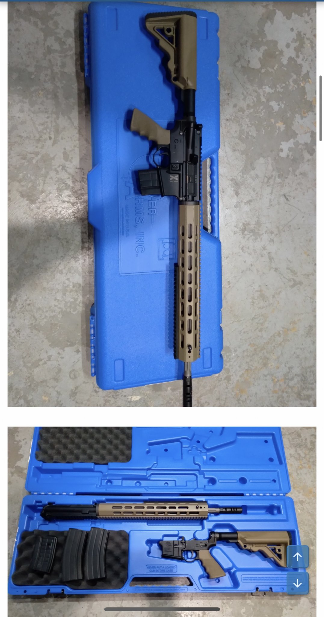

    Here’s what I’m looking at, all the ammo wjth it is Hornady 110vmax. But good to have for brass.
    I offered $1000 for all and he declined.
    That 110gr vmax is a nasty little round. I wouldn't hesitate to shoot a whitetail with them. I have not done any loading for my 6.8spc yet. I bought a couple thousand rounds of factory hornady ammo really cheap, before everything went crazy. I've had dies for more than a year and I've never opened them.

    What’s your opinion on the price of what he has?
    I asked about a regular rra 6.8 earlier, a basic rifle and people said it was a 500-600 rifle.
    But seems the x-1 series is a little more expensive
    I really don't know much about that brand. If you have an ar now that you aren't in love with, all you need is a barrel, a bolt and a new magazine. You can convert one for $300 pretty easily.

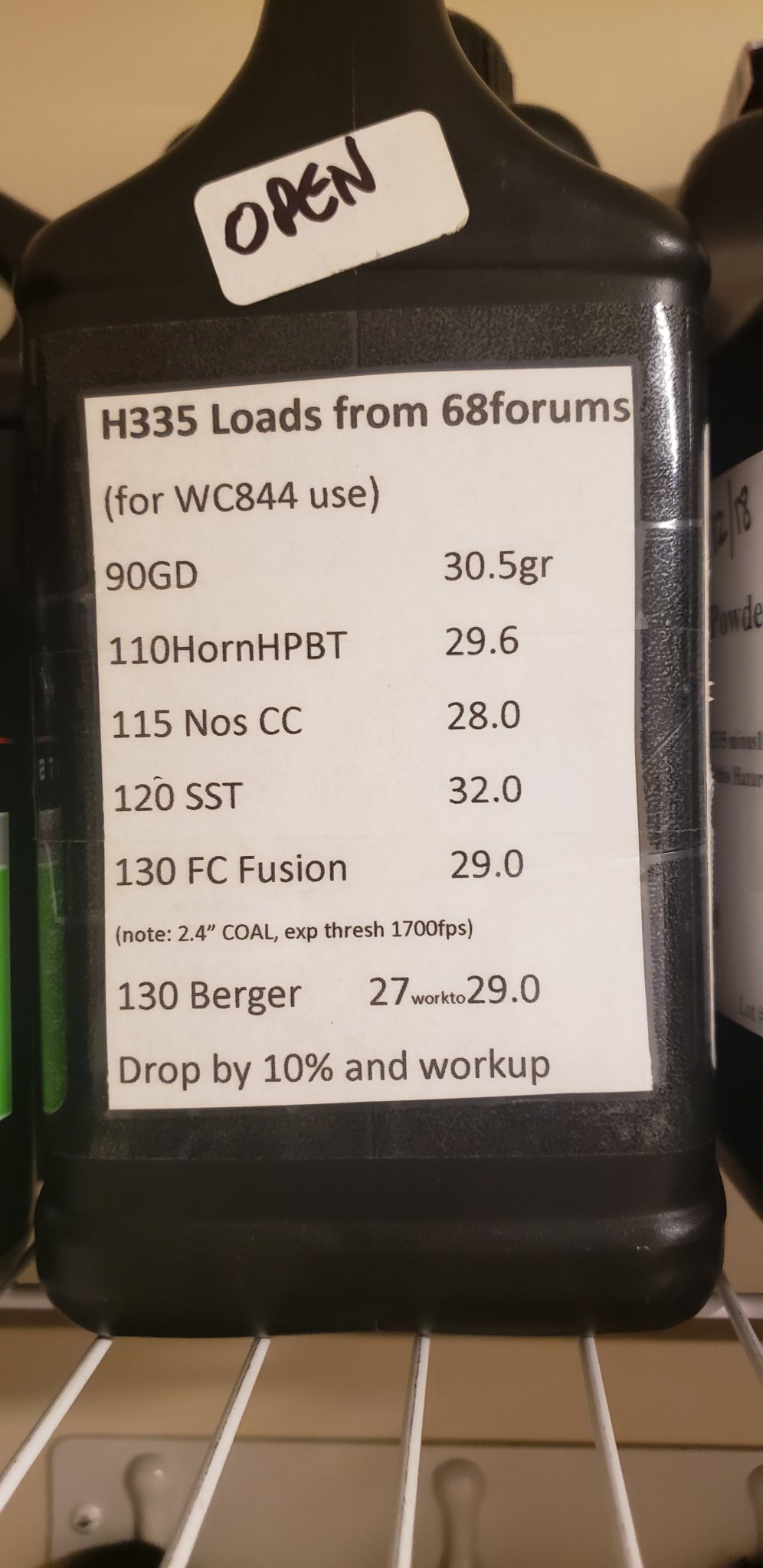

    Here's some H335 data I culled from the 68forums years ago. 16" will serve you fine hunting to 400 and shooting to 500. I've shot my 12.5" ARP out to 500, when I had access to that distance.
    Since you're a reloader, Cavity Back Bullets makes some fine hunting projos and some flavors of loaded ammo. Most 6.8 mags let you load to 2.285-2.295".
    As always, work up the loads!
