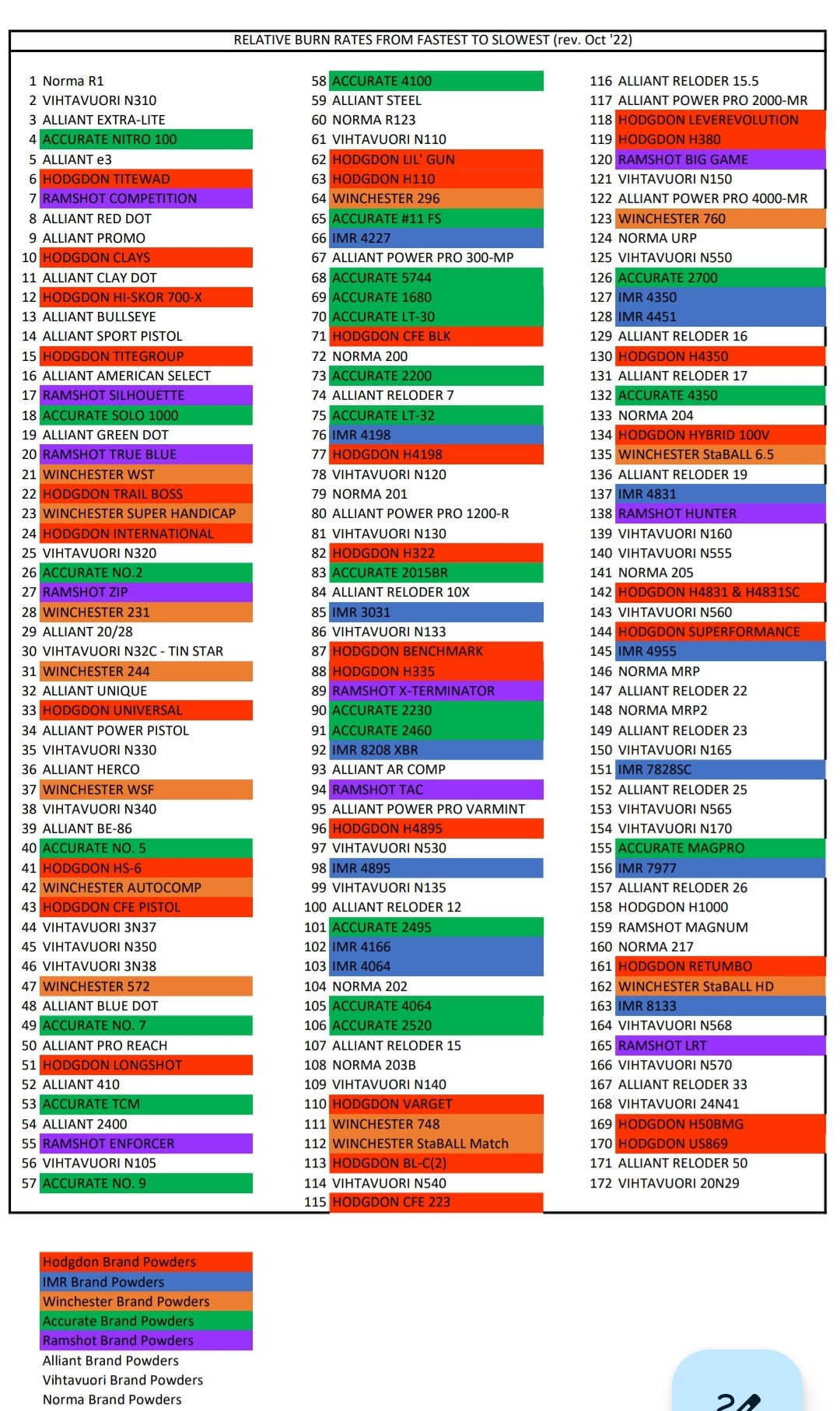

One of the best things you can do as a newbie is go to Hodgdon's website and print out a color Burn Rate Chart. They probably have the 2024 chart available right now, but haven't looked. Usually it's around this time that they put out the next year's chart. Learn it, study it, and learn what powders sit where, and that will give you a good idea of what will and won't work.
Reactions: jacklikesbigbores
