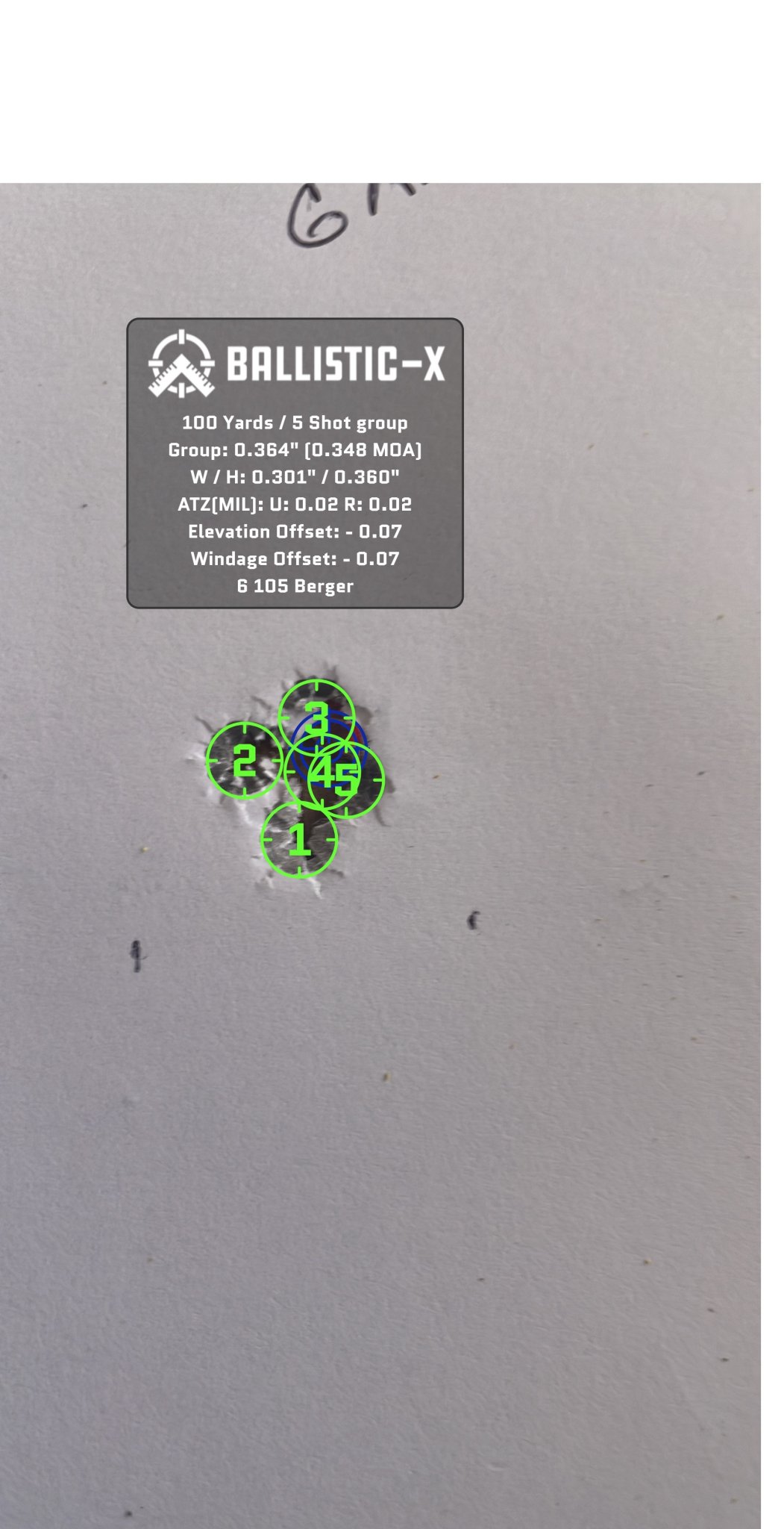

    I just got a LE Wilson die and using Short Action Custom bushing .266 then expanding mandrel of .2415. Now this works for me your mileage may vary
    I'm using the Wilson full length bushing die too with good results. I'm seating with the Wilson arbor die. I'm getting best 5 shot groups just under .5 MOA at 100 yards, and in mellow wind, just over that out to 700 yards.
