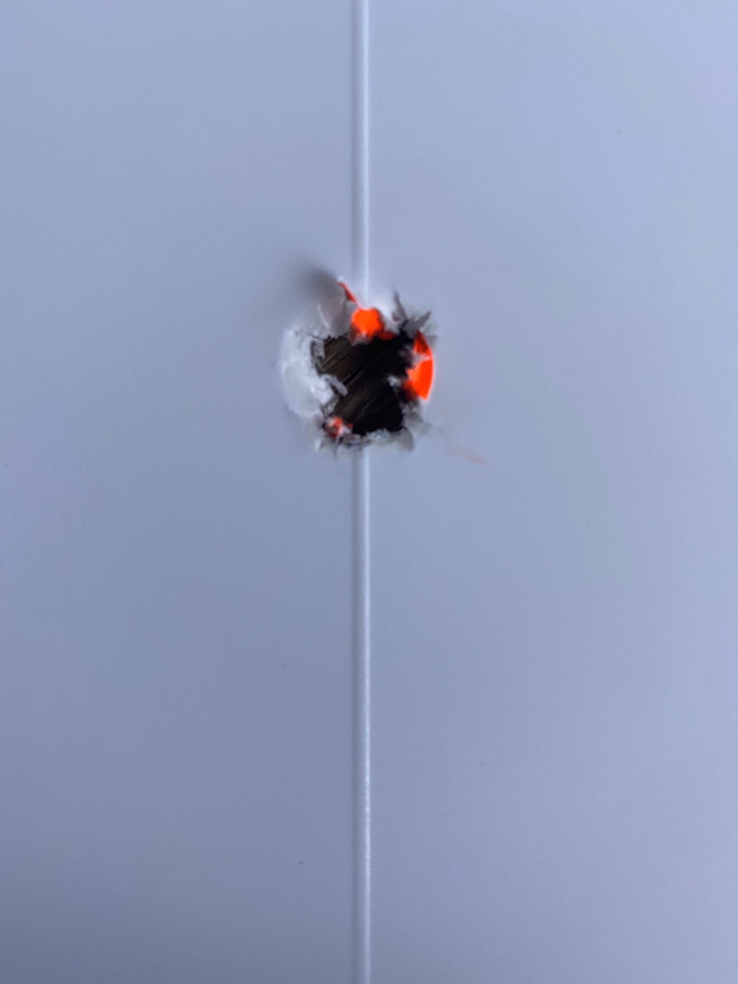

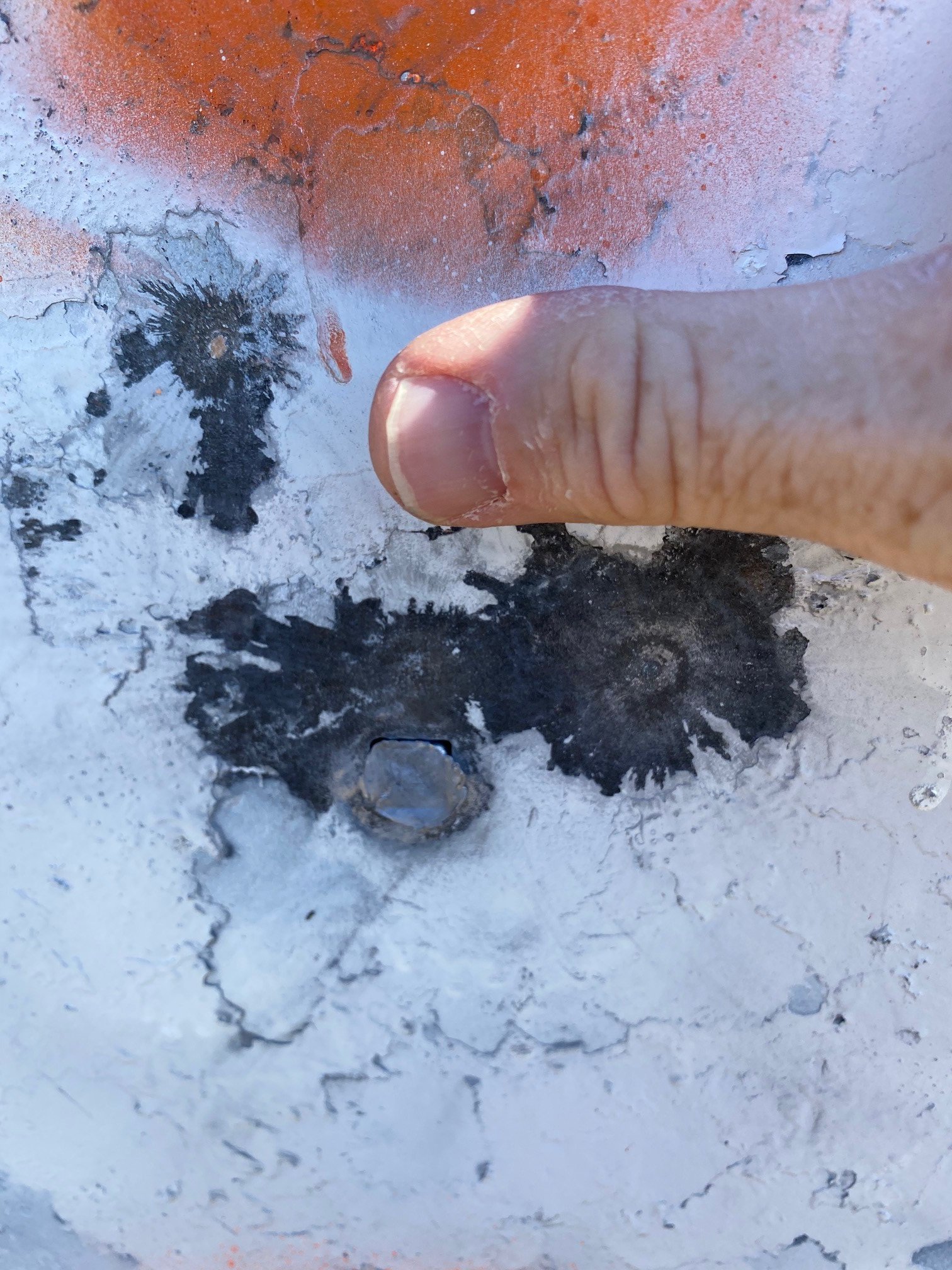

My 6cm is on it's second barrel, with the first barrel being a Bartlein 5R 7.7 twist on a full GAP build. My second barrel is a Brux 4 groove 7.83 twist.
As everyone here state, use a reloading manual as what works for my chamber may not work for yours.
Bartlien Barrel 25"
Case: Alpha Munitions SRP
Powder: 40.4 Gr H4350
Primer: Federal Gold Medal Match SRP
Bullet: James Eazor 106 Gr
Avg 3045FPS
Brux Barrel 25"
Powder: 39.1 Gr H4350
Avg. 3021 FPS
Both barrels with the above loads shoot well under 0.5". First image is 4 shots at 800 yds (Bartlien Barrel) and the second is 5 shots at 100 yds (Brux Barrel). Have not had a chance to take the Brux out to distance.
