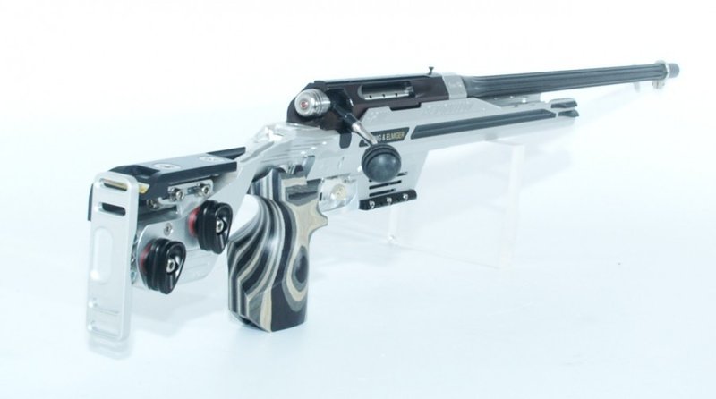

With the budget of an AI AX, why don't you 6mmbr shooters check out the swiss Grunig&Elmiger or Bleiker CISM matchrifles? Both come with 10 round double stack mags designed for rapid fireing with 6br and triggers that are equal or better than Anschutz. All factory.

Beautiful rifles!!!
