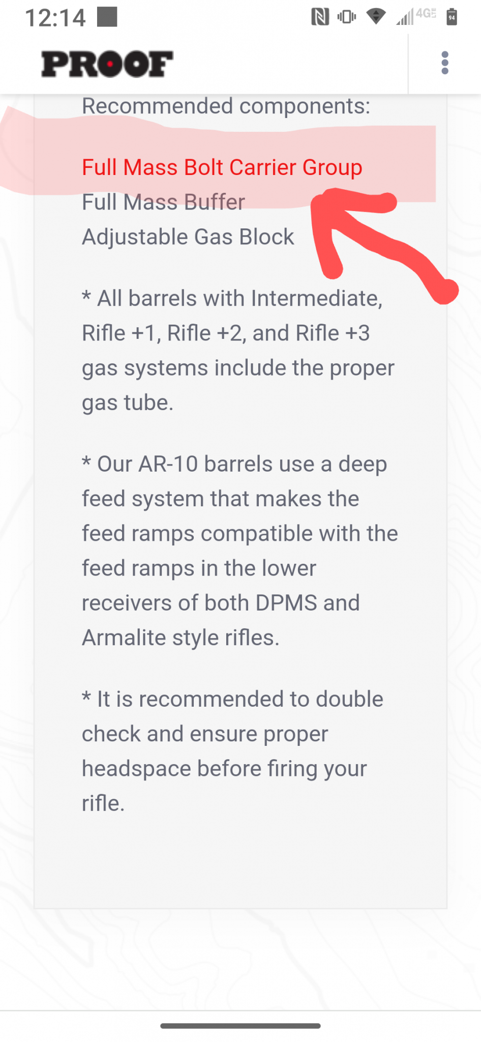

Earlier this year I bought a complete aero AR-10 lower and a stripped upper with an 18” 6.5cm mid length gas barrel. It was cheap and available so I bought it knowing I’d put a different barrel on it.
I’m running a JP low mass/high pressure bolt, JP H2 SCS and a superlative arms adjustable gas block. I’m looking at a carbon proof 22” +3 gas in 6 creed, any issues with a +3 in 6cm with the parts I currently have? I also have a dedicated Hyperion K for it that got approved yesterday. Thanks guys.
