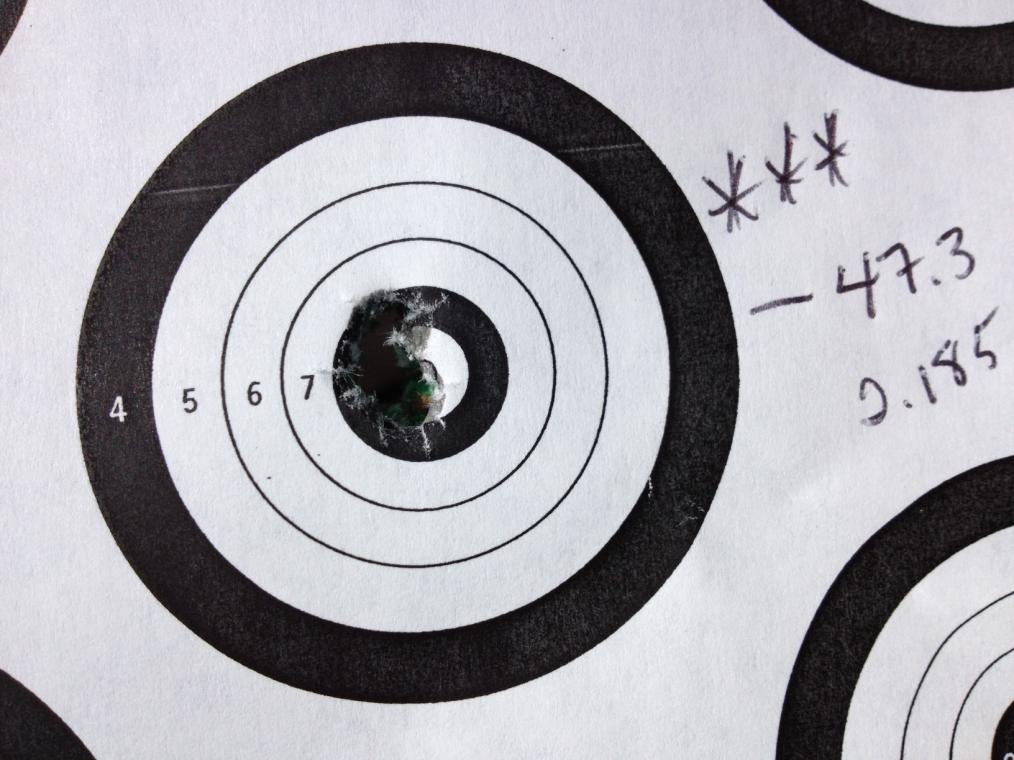

    Went out again today.....
    Long story short, I believe with some tweaks here and there I have found the right load. Ended up with 47.3 grains of H1000 at 3040 fps. Gave me this type of group:
    So enough with the 100 yard stuff, and I immediately transitioned from 100 yards to confirming dope at 500, 600, 700, 800, 900
    Most hits were perfect elevation wise, just have to get better at reading the wind :p
    Should be good to go now to really fine tune the dope. Love the way this rifle shoots!!!!
