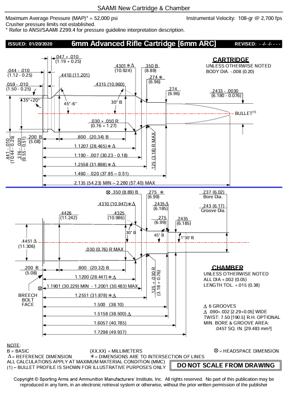

Here is the SAAMI spec in case it helps.
