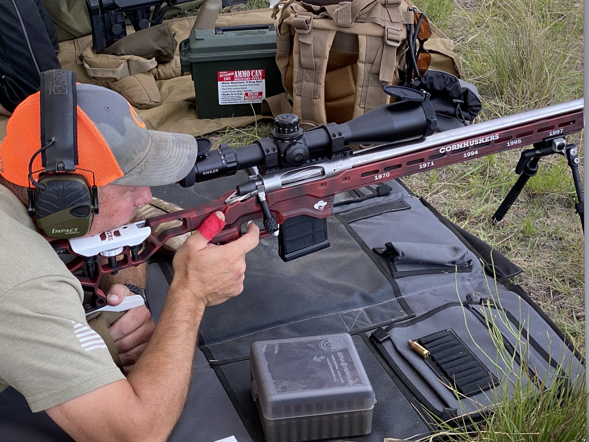

I had this Valkyrie in a class with her Husband shooting a Red 6GT so I got to see two race horses go side by side to distance. With real velocities
We shot to 1230 yards and the 224V was on point, but spotting the misses is really hard, you had to use all the tools to spot the misses. The 224 actually passed the 6GT in my mind around 900 yards, maybe around a 1000. She started to catch up at 800 and I know she overtook them by the end.

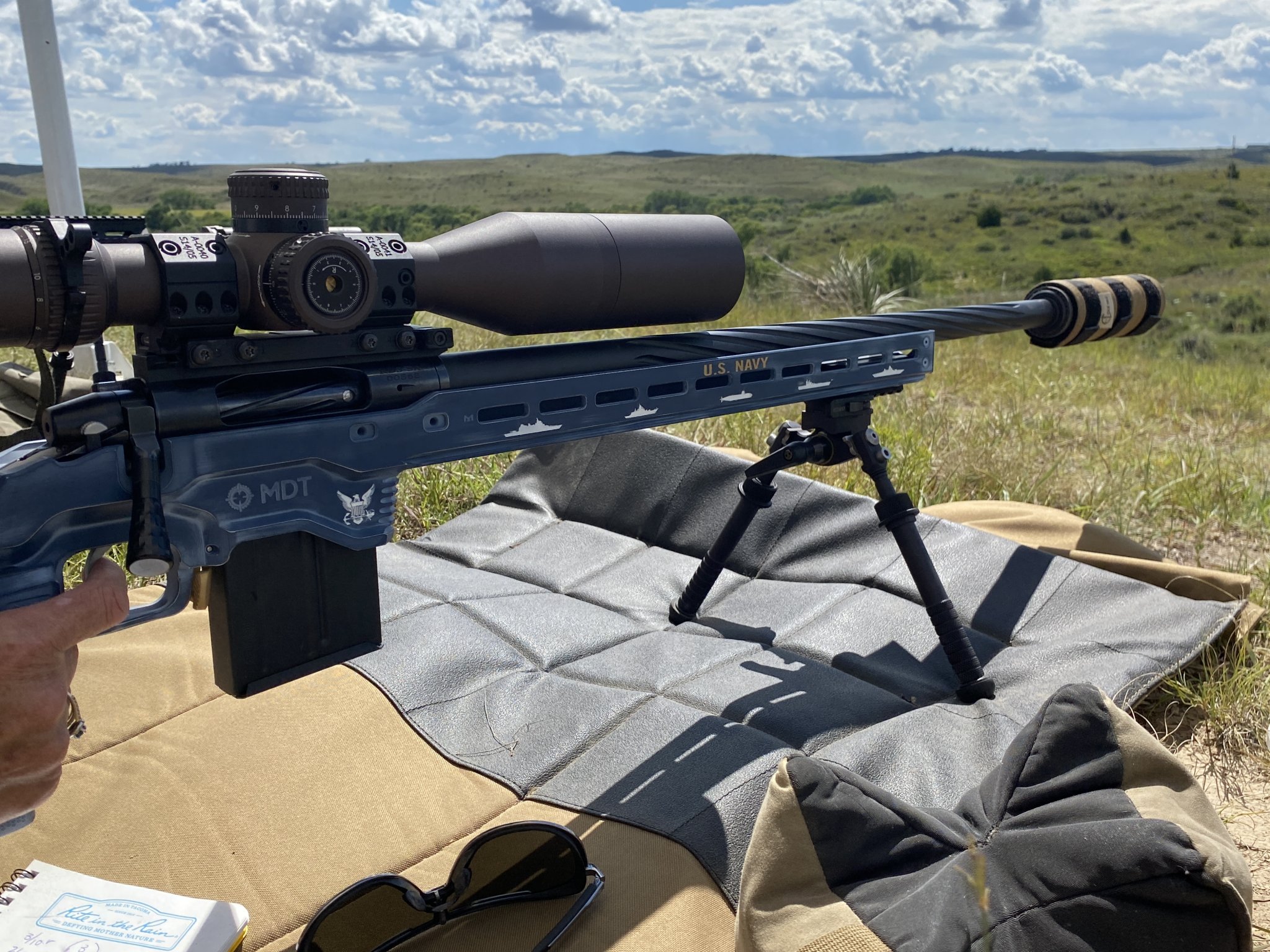

View attachment 7432741We shot to 1230 yards and the 224V was on point, but spotting the misses is really hard, you had to use all the tools to spot the misses. The 224 actually passed the 6GT in my mind around 900 yards, maybe around a 1000. She started to catch up at 800 and I know she overtook them by the end.
