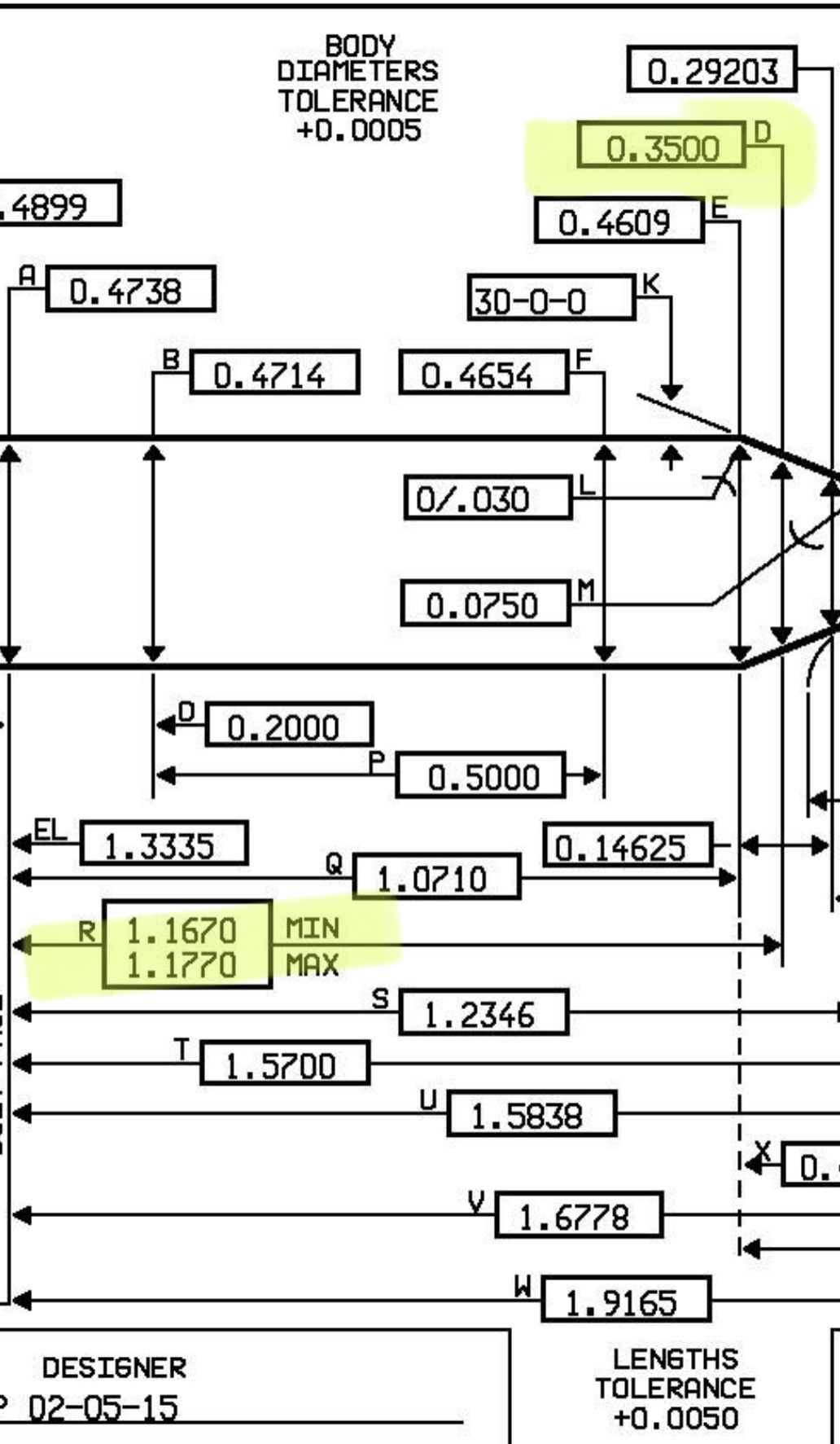

I found this thread because I’m little perplexed with bump and shoulder measurements;
At datum point .350, I’m get measurements of virgin Lapua brass at 1.162 and once fired
brass is between 1.1635-1.1665 however my spec sheets shows measurement should be between 1.167-1.177…. Wondering why virgin Lapua brass is measuring below spec ???
What am I doing wrong or is my diagram wrong?
Virgin brass is (usually) a hair under size, so you can load and shoot, and NOT have to size before you load.
Some smiths believe in the imaginary "super tight chamber", which puts you under spec and means you have problems sizing brass.
If yours chambers, load and forget about it. Id guess its in spec. Gordon is no slouch.
Your datum’s is slightly different than their datum. Don’t worry about it, you are using a comparator, not a gauge; your relative measurements of your chamber are all that matters.
