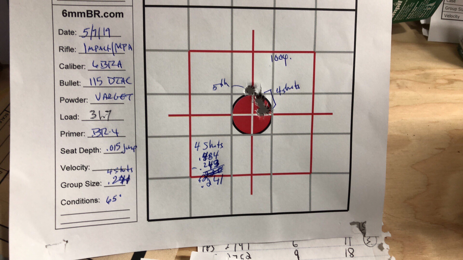

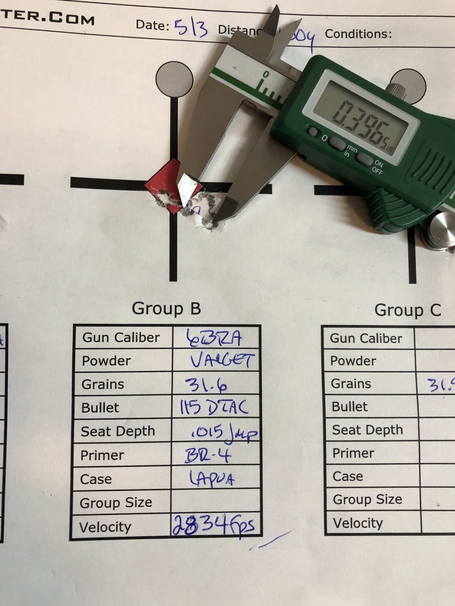

I’m having good luck with DTAC in 6BRA so far w/ Varget. W/ my lot 31.6 and 31.7 shot real well. 31.6 gave me 2834. Going to jump test them now and try at distance.

FWIW 31.6 of Varget behind a 105gr bullet eventually gave me pressure signs and was definitely not a rain safe load. I would imagine that with 31.6 and a 115 you are really flirting with pressure.
My 115 DTAC load in a Dasher is 31.4gr Varget at 2810 fps from a 27" barrel.
I’ve been finding the br a pressure margin is pronounced; once I hit that mark, it seems to pressure out quick. I assume likely a function of the fast burning powder bumped even .2 grain increment is a larger percentage of the case.
I found that during early load development in clean and controlled conditions I could run the cases pretty hot without apparent pressure signs. I got up near 3000 fps with a 105, I think into the 2900's with a 110, etc. However those loads loosened primer pockets and over time in field conditions with dirty/wet chamber pressure would show up.
If you told me I had to shoot a match in downpour rain I'd choose somewhere like 2850fps with a 105 and 2700-2750 with a 115.

Thanks for the info. Didn’t see any pressure until 31.9. I hear what you are saying...that’s only .2 over where I am now in 50-60 dog weather.
