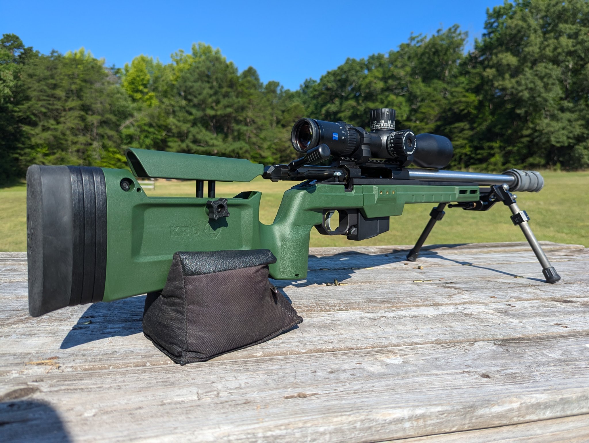

Just got back from the range with my new 6GT build, only had to adjust the mag latch up a tiny bit to get 100% function with AW mags... KRG adjustable trigger guard made it simple.

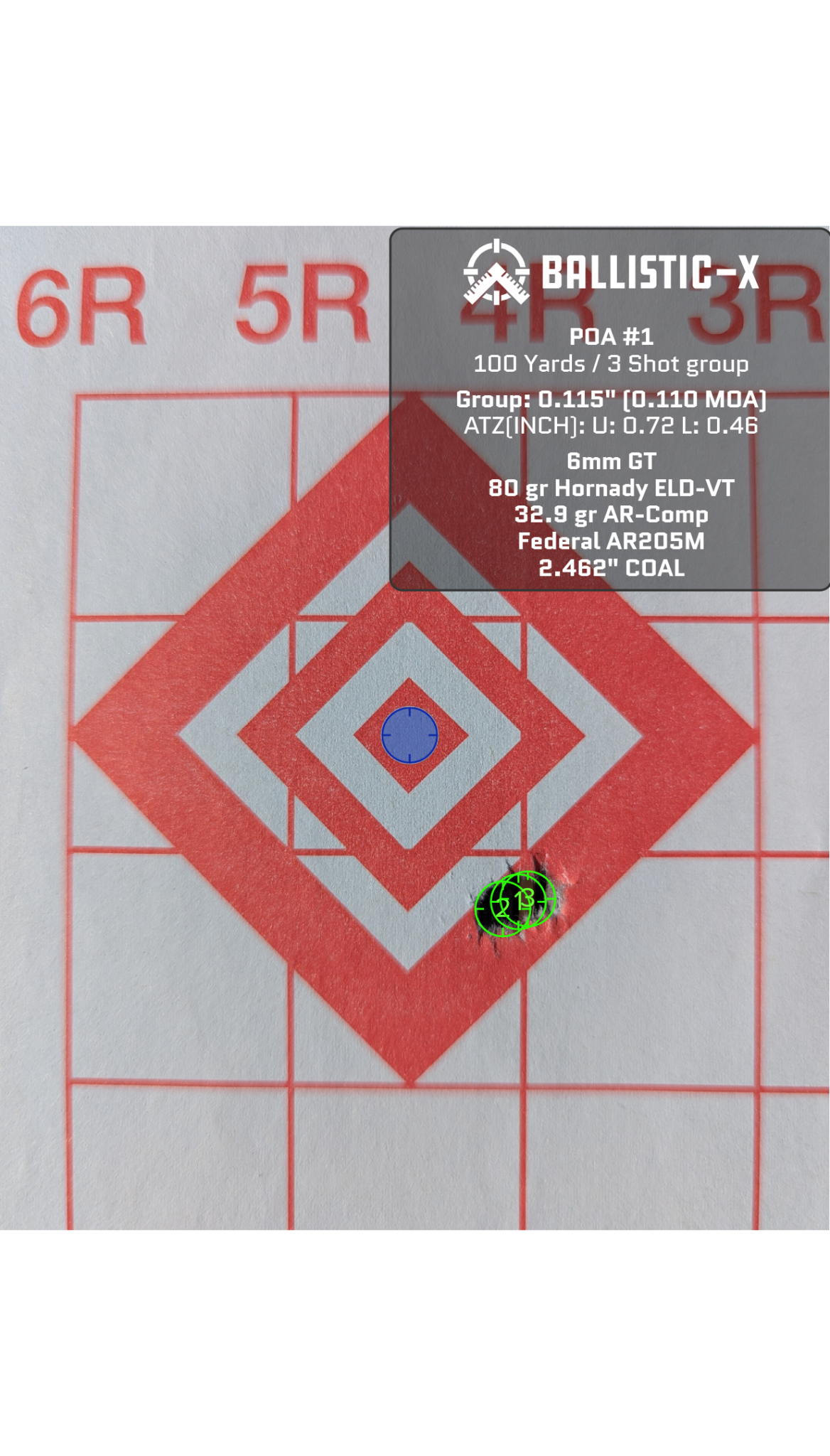

Testing 80 gr ELD-VT loads for predator hunting so tried AR Comp powder since it's a lighter bullet in an 18" barrel. I'm sure it's on the slow side (around 2910 according to load data) but damn it was easy! I'll continue working up to 35 gr or so see if there's another sweet spot. 109 Bergers with 32.5 gr of Varget shot well too, just under .5 MOA so I might play with seating depth on those next time. So far it seems like it's an "easy button" cartridge like lots of folks have said!
